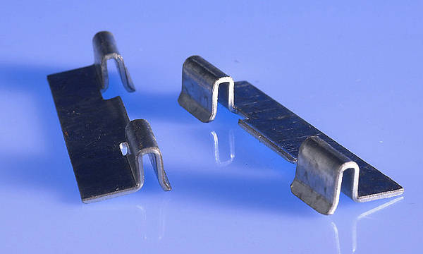

Has anyone experience of these https://www.tlc-direct.co.uk/Products/AP603.html
A friend of a friend has a problem with a metal PB box (not come across one of these myself) where the PB is breaking up at the sides where the lugs and flanges are.
I'm wondering about fitting them top and bottom. Although I'm not sure about getting them fitted as she says the box doesn't move backwards
They are junk.
Box needs to go further back into the wall space to allow them to be attached.
Then it's necessary to hold the box in place while attaching the accessory, otherwise the box will fall into the cavity. Good luck doing that with only 2 hands.
The plasterboard can be repaired by cutting 2 strips of thin plastic sheet ~1mm thickness, fixing them to the back of the plasterboard at each side of the opening with double sided tape, and then repairing the front with Easifill 20.
Existing box can go back in once set, which should only be about half an hour.
I'm going tomorrow and thought I'd get a set as a quick fit but had realised box would have to be further back to fit them and reason I asked if it could move backwards.
I was hoping to avoid getting involved with board repair but I suspect it will be the outcome
I purchased a pack just in case. As mentioned the box could not move backwards as the Click metal backbox has a flange all round and those clips would not have fitted on it anyway. Apparently the socket has always been loose but a particularly tight phone charger pulled it right out.
However there was a much, much simpler repair option open to me than repairing the broken PB...
Using a pad saw I enlarged the single sized hole to double(y)(y) oh and fitted a double socket with USB outlets (y):) .
