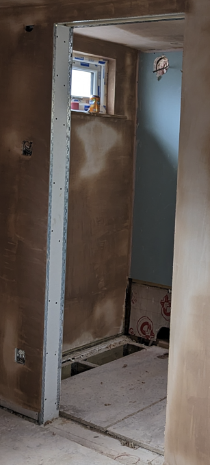

Hi,
Have builders in at the moment, and generally, they have been alright. Left them to it and came back to find that they had put plasterboard around the door frame, and over the door where a pocket door would slide into. So the lock would then have to go into plastboard?
They were speedy and already plastered either side, and run stop beads to give a good edge. Is this normal??
Picture attached.
Chris
They've screwed it into the frame underneath so should be ok. I doubt they've built a stud wall without studs.
Blup
Cheers Blup,
I was thinking more about the finishing, as the other pocket doors I have, have always just been wood, so I could paint it all, now unless they plaster the last bit of board I am likely to have visible plasterboard and screw heads...
