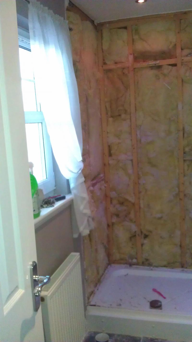

Hi,
Having had to remove the plasterboard from behind my shower cubicle, i now intend to replace it with aquapanel. However, unsure how to prepare the existing wall that will eventually join on to my aquapanel. In the pics attached, you can see the rough edge of the wall, and the stud. Should i use a Stanley blade to trim the wall back to the centre of that stud marked with a red arrow to allow room to attach the aquapanel. If my thoughts are correct, should I be using Ames tape or equivilant to joint it?
Many thanks
I would cut the plasterboard back to the centerline of nearest stud outside the shower enclosure, that way you can be sure it won’t be affected by moisture again. Never used Ames tape & not sure if it’s something that can be easily applied DIY, I use standard plasterboard reinforcing tape which I also use on Aquapanel. Tape & fill all board joints with flexible tile adhesive. All board edges must be fully supported so you may need additional, intermediate noggins. Stagger any board joints if possible & avoid tile grout lines coinciding with board joints. Use the correct adhesive for your size/type of tiles.

Ive just finished cutting back the plastboard to the centre of that stud.
with your last comment in mind, what if i was to sand a recess down the entire edge of the board, then seal it; PVA mixture or similar?? essentially creating the tapered edge, and then applying teh tape and fill you mentioned.
thanks
I wouldn’t advise that, you will destroy the paper lining on the face of the PB, exposing the gypsum core which has virtually no strength without the paper linning.
Hi, Ye i will probably not bother. I did consider glueing back on an ames tape paper or simillar, but I think i will just fill between the two boards only .
