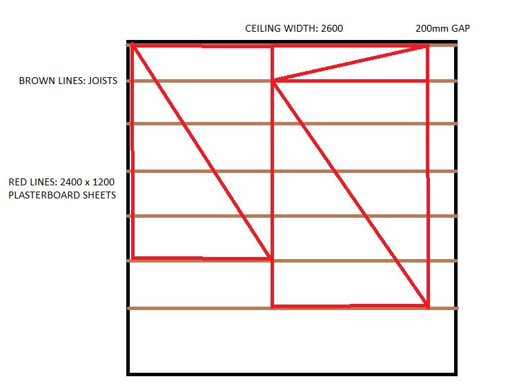

Evening all,
In need of some advice. Going to have a go at plasterboarding a new ceiling tomorrow (first time plasterboarding). If the ceiling/room is 2.6m wide, should I fit two full 2400 x 1200 boards and then cut a 200mm strip to fill the gap, or cut two of the boards down to avoid a thin strip? I've already got the boards in the room and they will run perpendicular to the joists.

All edges need to lie along a joist, so where two boards meet, each board will need to lay halfway across the joist in order for it to be nailed/screwed securely into the joist. You need to measure what the distances are between the centres of each joist and cut your boards accordingly. Personally, (and this is just my opinion), I think you should avoid narrow strips as I have found in the past that they tend to cause cracks more easily than bigger board pieces.
In addition to above, smaller board prices are far easier to handle.
As a DIY'er, the largest boards I will use for a ceiling are 1800x900, although I am working alone.
I hope you have some help, or plenty of board props! :)

I probably should have gone for the smaller boards in hindsight, but my local builders merchants doesn't stock them. I have invested in a lifter, which should help a bit!

Again, only as a DIY'er...
I would be tempted to put some noggins along that joint line, minimising any movement between the boards.
Although ideally, one full board should run down the centre, and two cut boards down either edge.
How wide are the joists? I'd be tempted to fit the boards running the opposite way to your drawing and then you can stagger the off cut at each end.

The 200mm thing is ok but I’d avoid a board that only fixes to 2 joists like the one that’ll presumably be on the bottom left of your pic. Slightly more likely to sag as it’s only fixed on the weak edge fixings not midway
