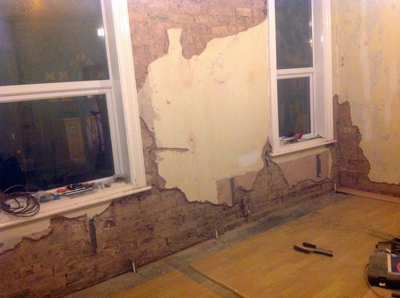

I am in a dilemma as to what steps to take next...

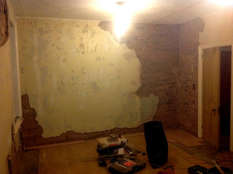

I have started a fairly major job this weekend by stripping the walls of any loose plaster before patching it up.
As you can see from the pics there was a fair bit of it!... what a mess.
The house was built in 1908 and has solid external walls. The room is 6M x 4M x 2.75Mhigh. The two walls you are looking at in the pics are external and solid. (no cavity).
My initial plan after speaking to my local plasterer was that I would batten/lath the walls and offer up some insulated board between and then plasterboard over the top. He would then come and skim over them.
I then realised that if I were to screw some battens on top of the plaster, it would need to be relatively sound behind.
I went round the room tapping it with the back end of a screwdriver, anything sounding hollow I pulled off,.. it came off very easily. The one pic shows how the corner was particularly bad, this was because there was once a shower unit in that corner. (previous owner).
The plaster on both of these external walls is about an inch deep.
I was wondering if to patch up what I have done and then carry on applying the battens/laths on top or to carry on stripping the rest of the wall and apply the battens straight onto the bricks?

Have a look in my albums (bedroom and bedroom2) I had the same problem with my Victorian house and I have thick stone walls which was letting in water and you will see the route I went down, Dont worry about window revels as the plasterer should be able to form them for you or a joiner...
hack it all off the external walls, then you can insulate without excessive thickness. You can get a bonded insulating plasterboard.
If you are using battens on the damp wall, either use galvanised lathing or, if wood, soak thoroughly in Cuprinol or similar.
