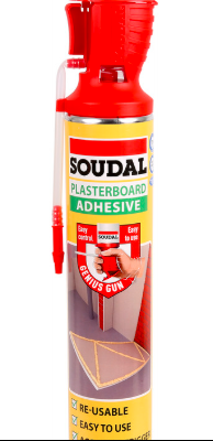

Buy a foam gun.
Use plasterboard foam as very little expansion.
Make sure you go around all 4 edges of board to seal off.
Blast foam gun with cleaner every time you swap foam can.
Always keep foam in gun.
Buy a foam gun. Use plasterboard foam as very little expansion. Make sure you go around all 4 edges of board to seal off. Blast foam gun with cleaner every time you swap foam can. Always keep foam in gun.
Do you mean something like this? Roughly how much board does one of those 750mL cartridges do?
Depends.
About 2 and a bit boards per can.
I prefer a metal foam gun however. Some are happy with the all in one cans
Masking tape along gun nozzle will keep that tidy.
Foam cleaner only works on wet foam.
I just like the control of the gun but if you're just boarding then maybe a can is better.
If pipe clogs just get another can I guess
When I used a foam gun I only cleaned when storing for a while , otherwise I just added another can , up to around 20 without any problem .
Lighter fuel is a cheap way to clean wet foam off your hands .
