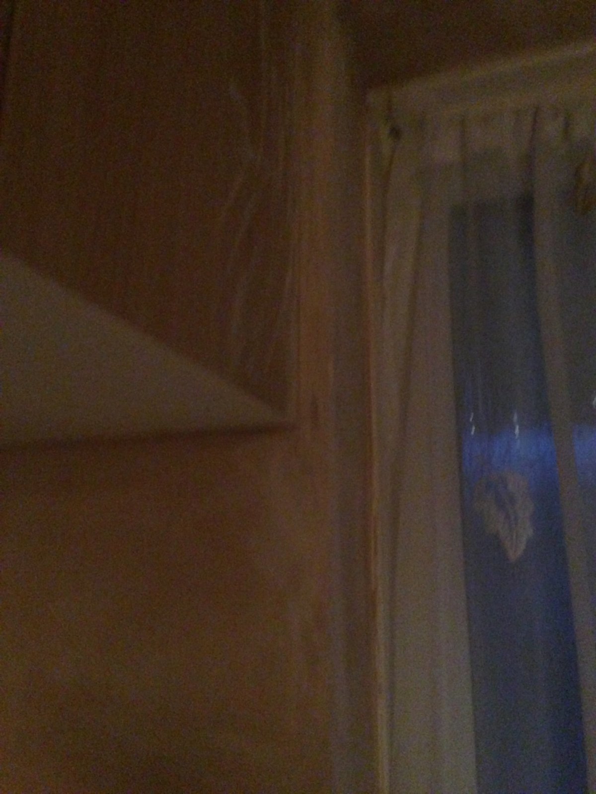

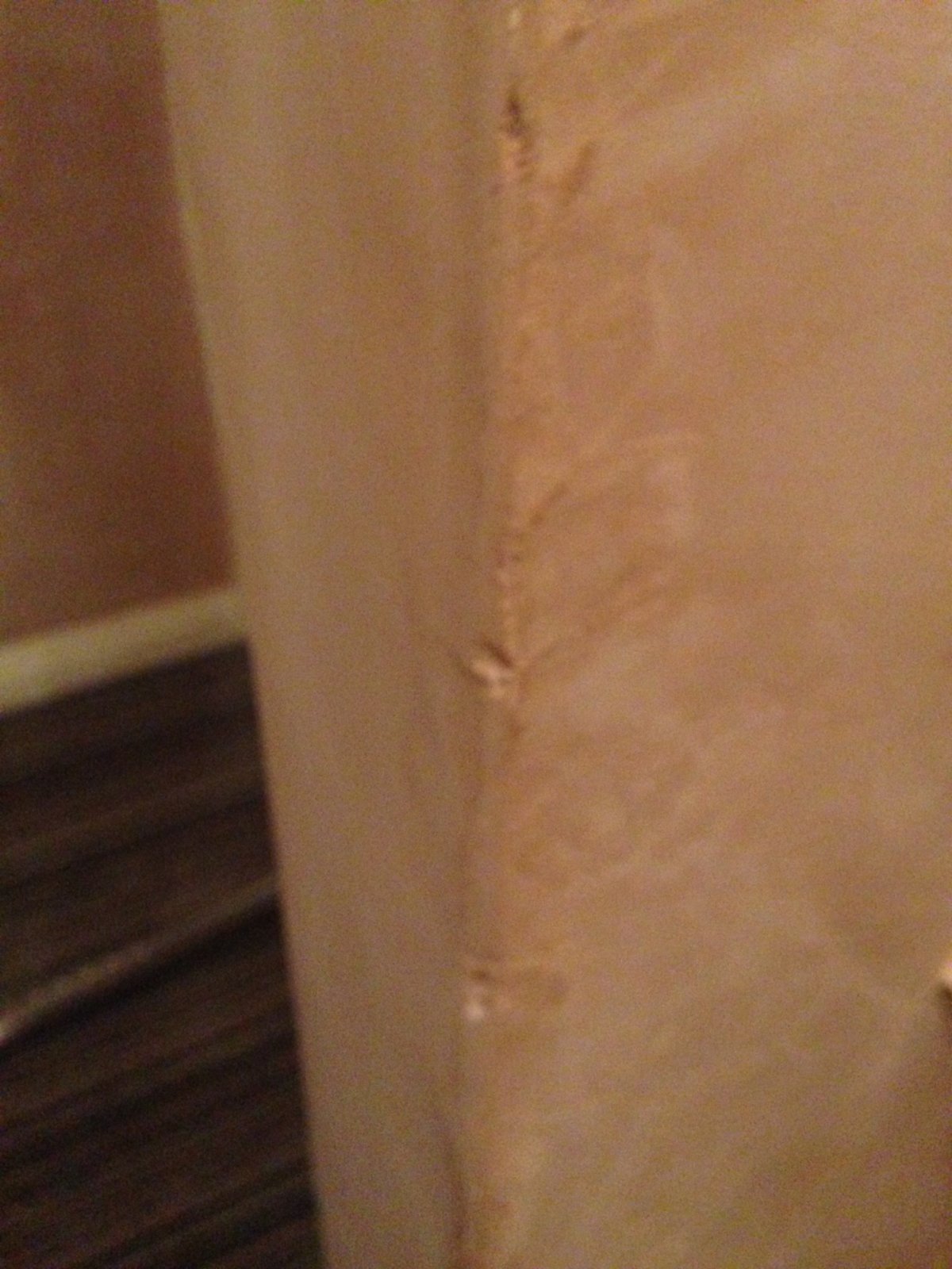

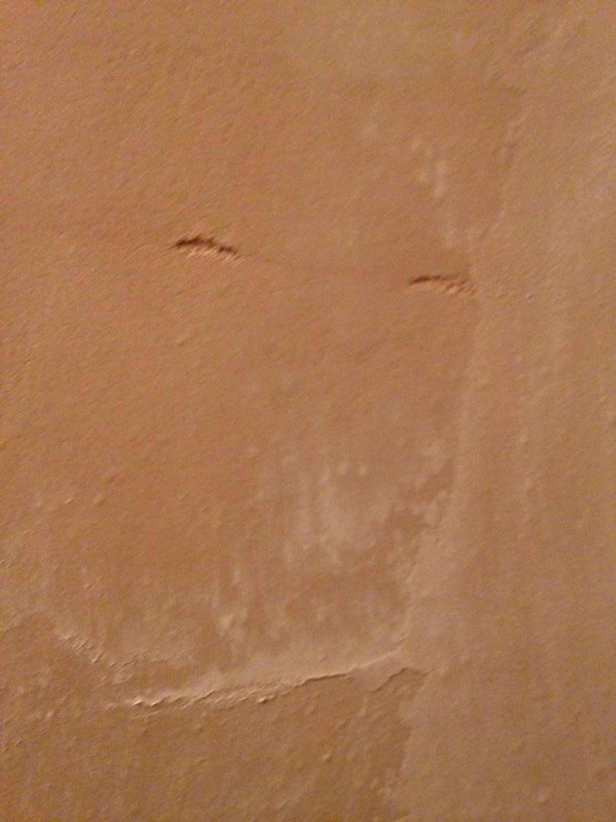

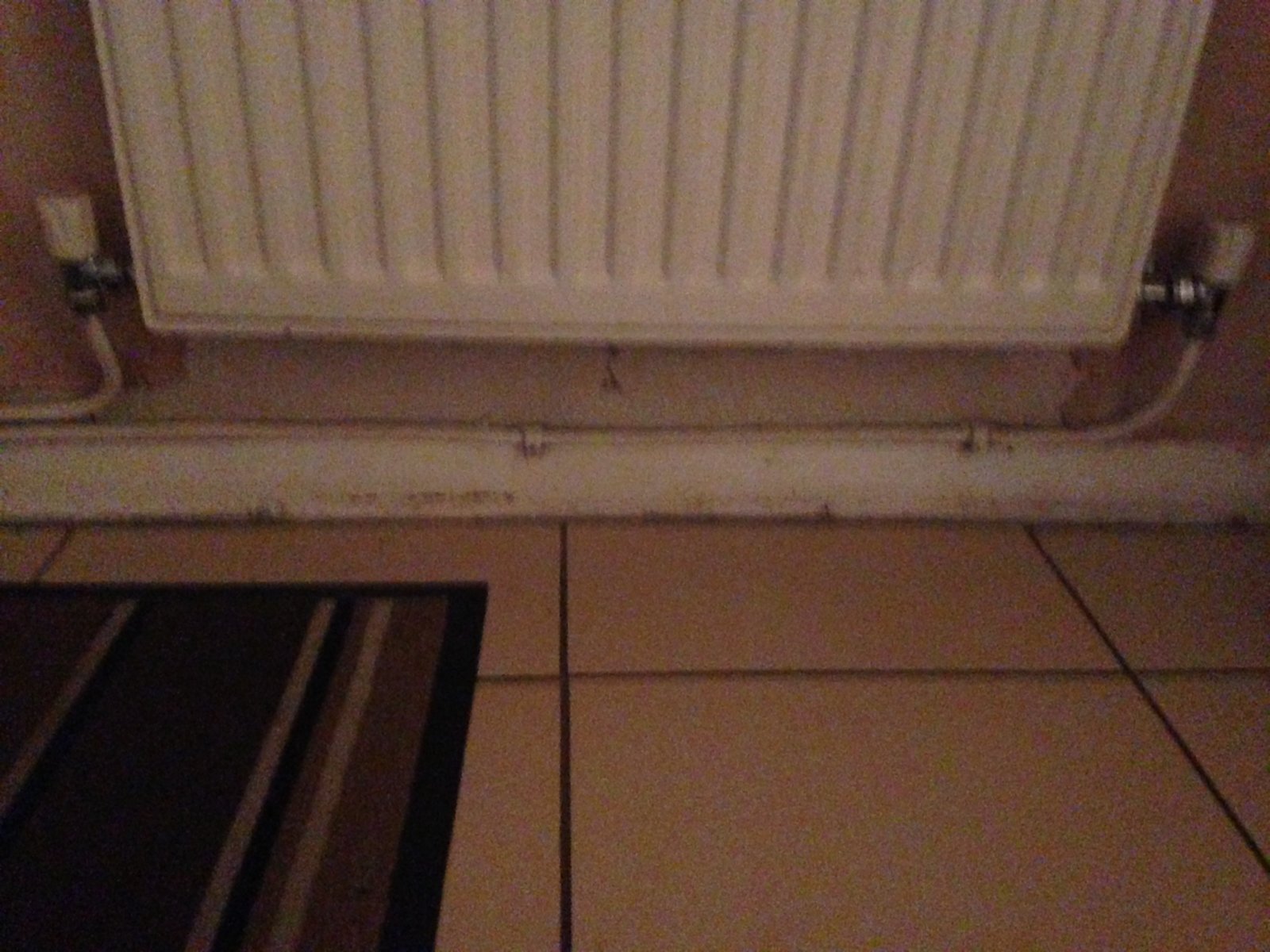

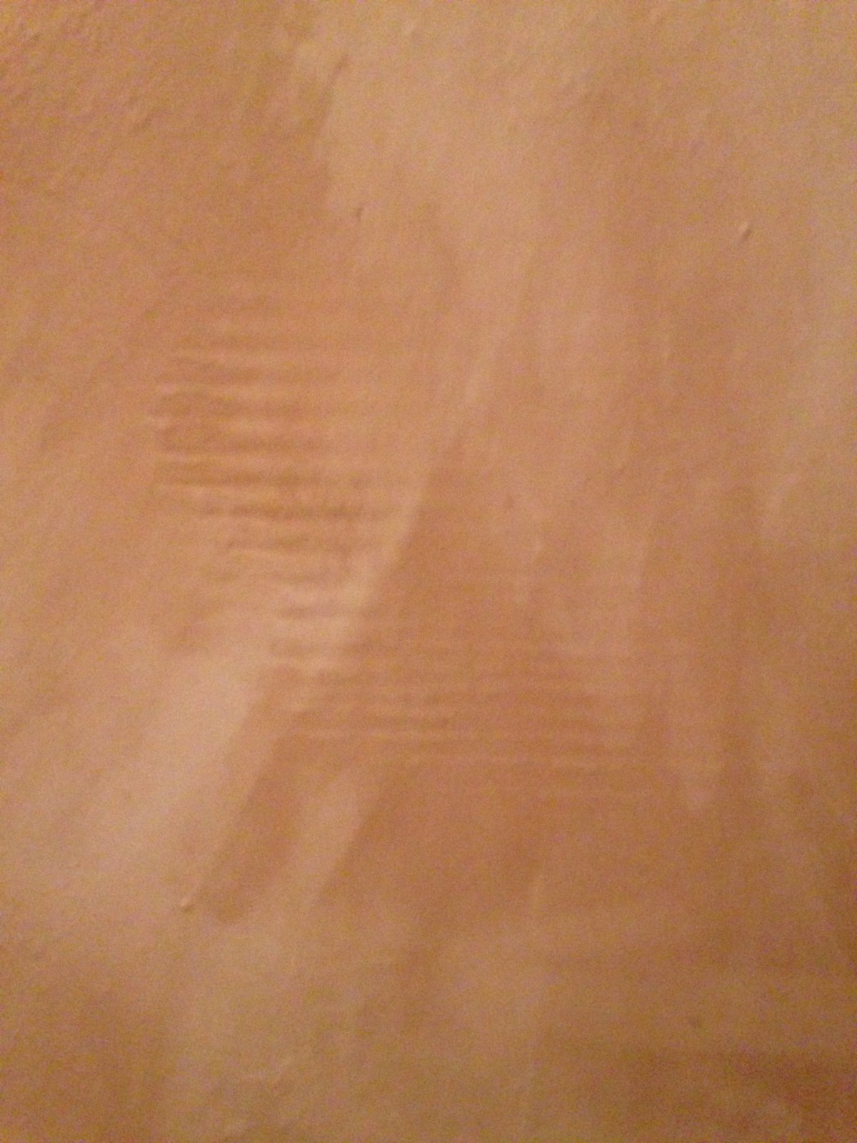

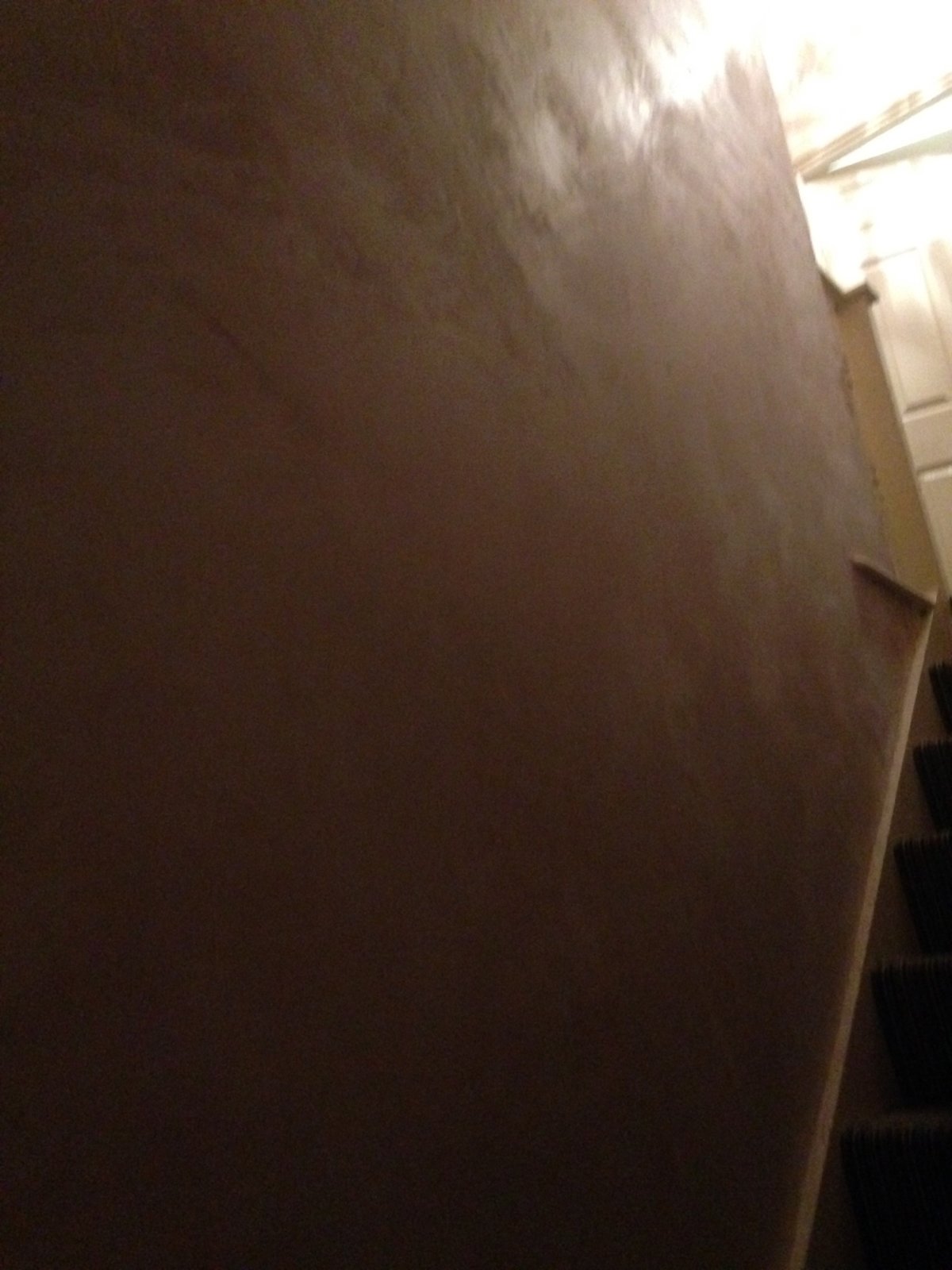

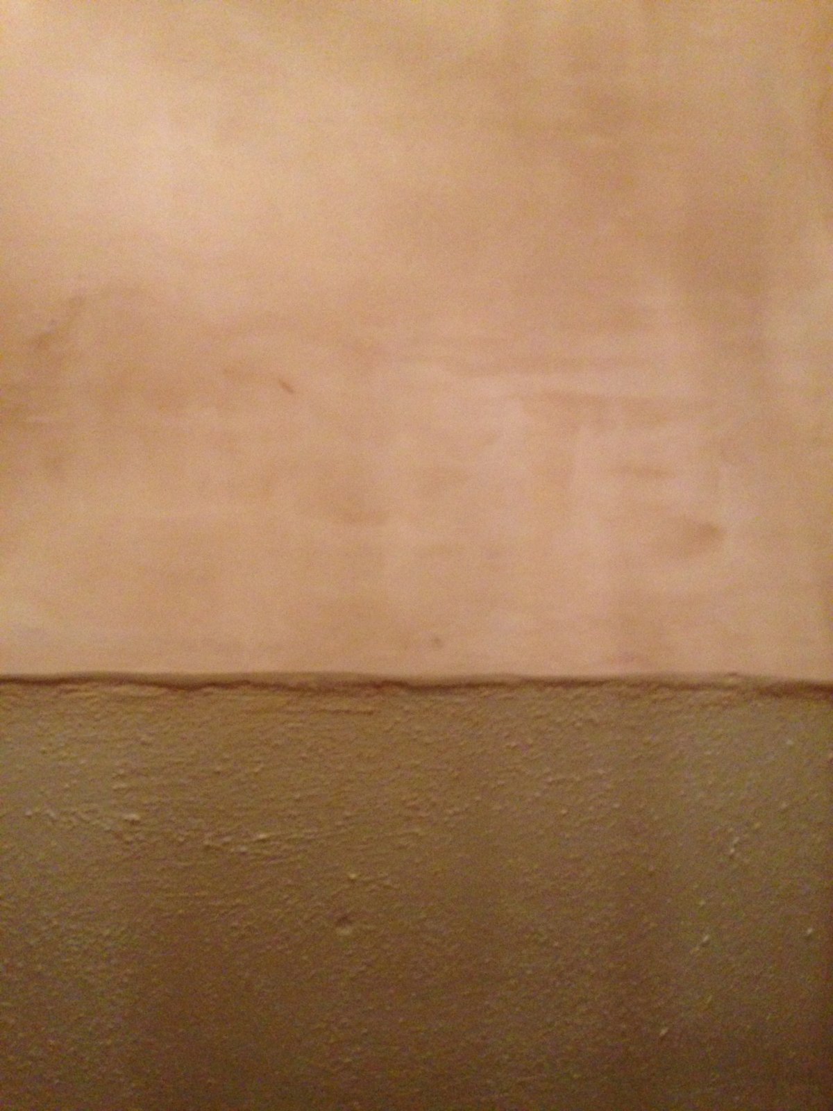

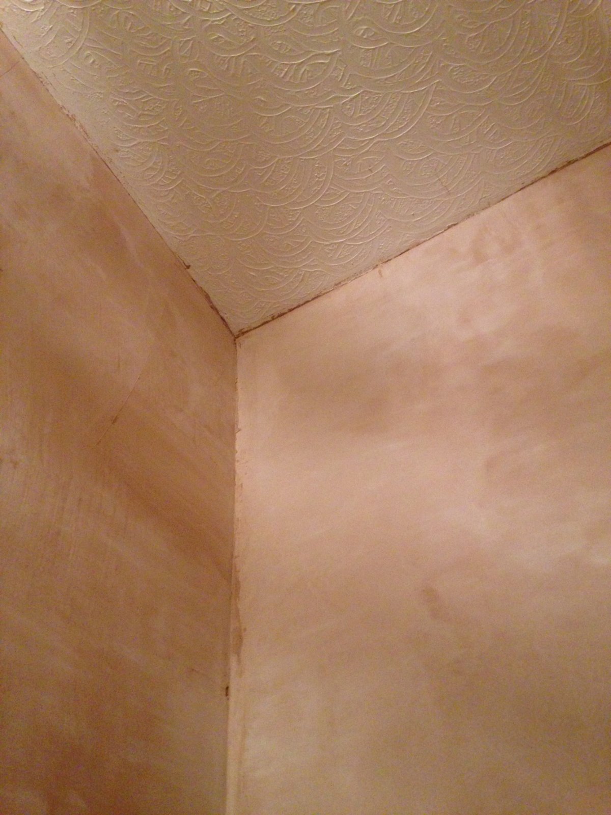

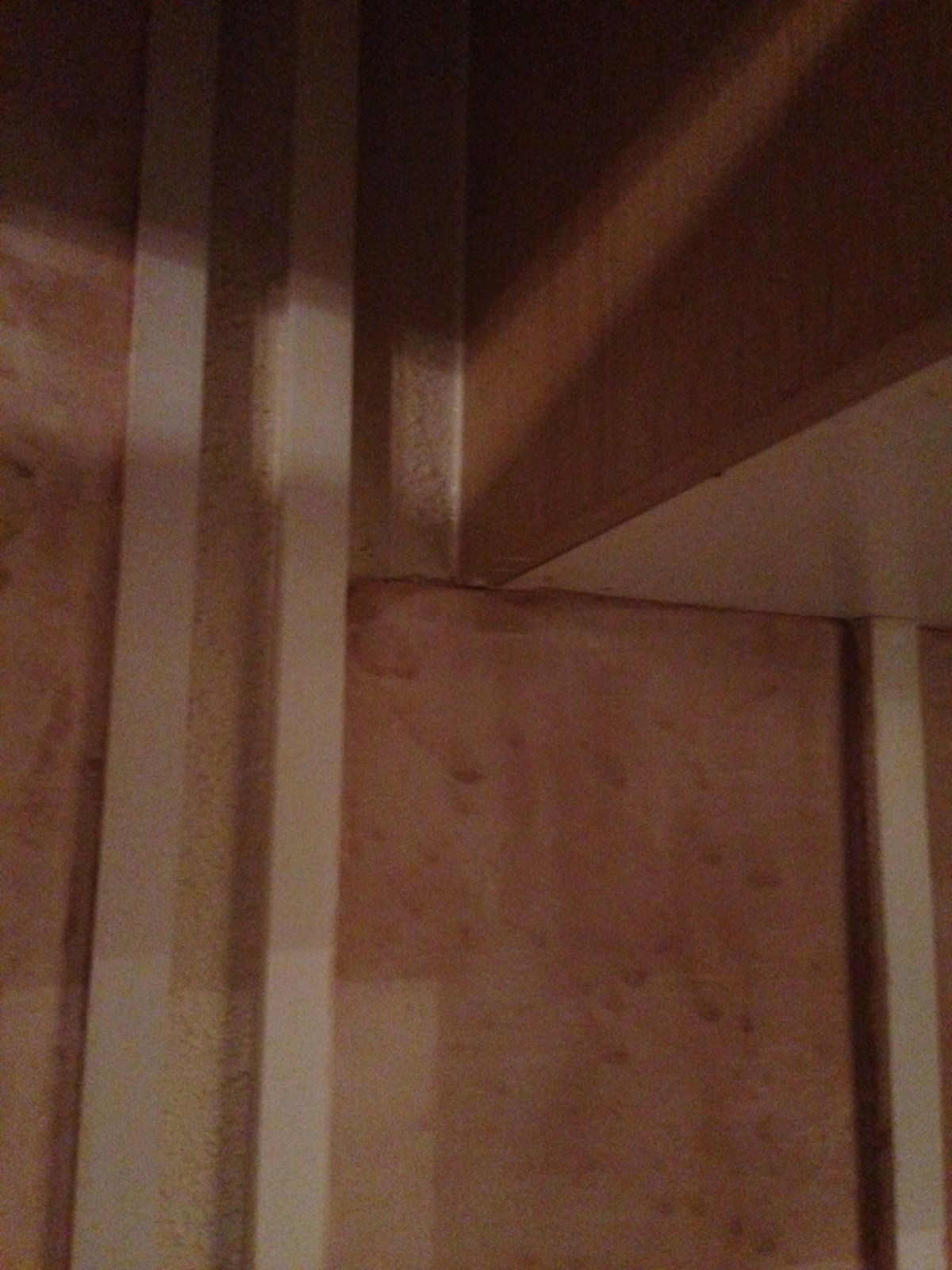

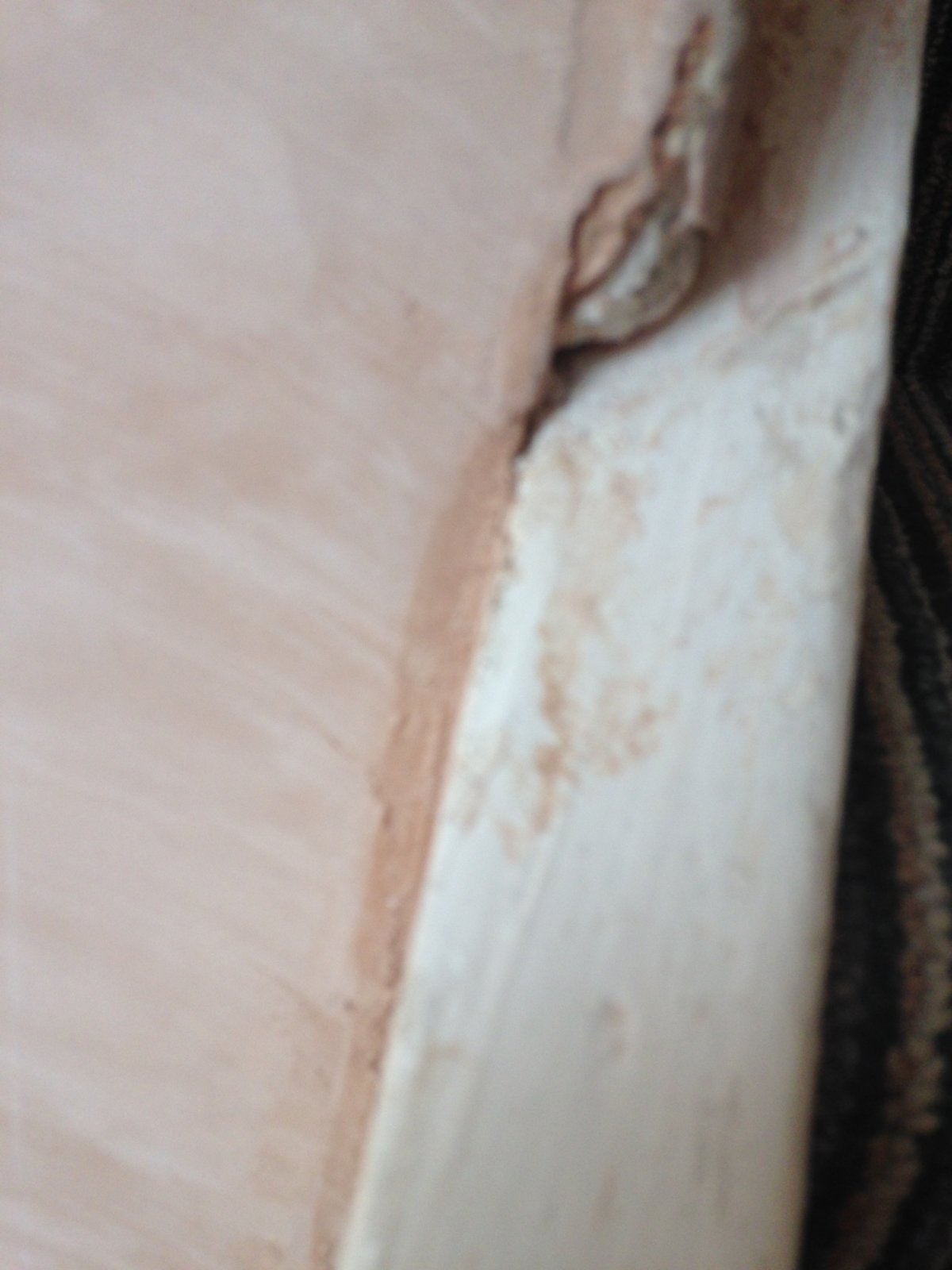

Is this acceptable work from a plasterer he also never used tape or metal beading and left it all over skirting and trunking also ceilings when he was doing the walls

A rubbish job, no ther words for it. No beads, trowel marks everywhere, messy workmanship, and the external corner mess,,, overall,,, SHOCKING.
Jesus and I get annoyed when I have to do a little rubbing down after a spreads been. I wouldn't be happy with that in the slightest I hope you haven't paid yet. Whoever did it should be ashamed.

I know I paid hi but didn’t realise how bad it was at the time thought it would take a while to settle down it’s not until I had another plasterer in that he picked up all the points ie not using the metal edging and tape and as time goes on I’m picking up more things with it I hadn’t a clue about plastering
As the boys say it's a bad job but just as a side note you don't have to use beads I see you have the old ripple effect there where the blades skimmed across at an awkward angle tbh now you have paid him unless he gives you your money back I think you've got it all to do to get it off him you should bill him for the making good that's needed
That's not a plasterer who's touched those walls, or a good diyer! they have some pride / self respect for the work you do.
