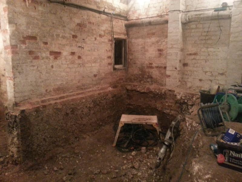

We are having our basement waterproofed using a Cavity Membrane System (Delta). The defacto choice after that seems to be either metal track, plasterboard and skim, or stud work, plasterboard and skim.
We have a rather complex wall shape in our basement - chimney breasts sticking out, 225mm wall going to 400mm towards the lower half (concrete footings), splayed foundations/corbled footings etc.
Whilst I appreciate just studding it all out to be a perfect rectangle would be easier, it would waste quite a lot of valuable space.
Can anyone suggest any alternatives? I've been looking at the plasterboard with insulation already attached - dot and dab that onto the wall could be an easy way to follow ALL of the contours of the room. Whilst it would require a different Membrane from Delta, apparently it is possible. Can anyone see any pitfalls with this approach? What if I wanted to attach a TV to a wall? There would be no studs, just insulated plasterboard - could these take the weight?
Any advice very much appreciated.
thanks
Mark

So how would you get around a vertical change in shape, e.g the wall jutting out half way down? I can see how you can use this method to go around the shape of the room, but when the wall juts out like a shelf halfway down (see pic) how would you do this?

Method I mentioned only works if you can fix ceiling and sole plate and run continuous vertical studs in between.
I'm trying to think of an easy way in which you can get around what you want to do but I'm struggling at the mo
Did you specify any fix points when the membrane was installed?
Let me sleep on it and I'll have a think about it
The easy way as mentioned it just stud it out in front of all these alcoves and protrusions but I know you want to make use of the space

The general advice seems to be stud it - timber or metal. But why not go down the dot and dab insulated plasterboard approach? That way I could follow all the alcoves and protrusions. I'm sensing that this comes with its own downfalls so just trying to understand what they are?
FYI the membrane can be laid with/without facing mesh, which allows dot and dab or render being applied directly. So I need to decide which route I am going to go down before they lay the membrane.
