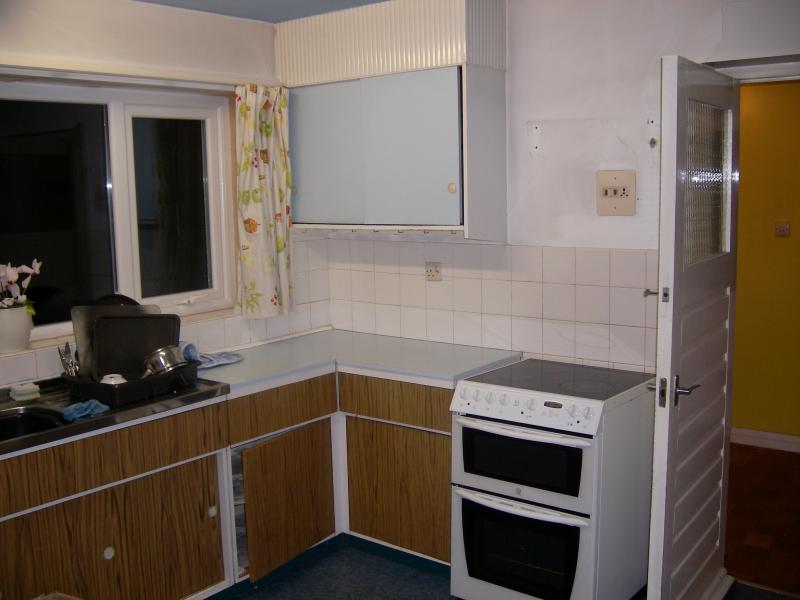

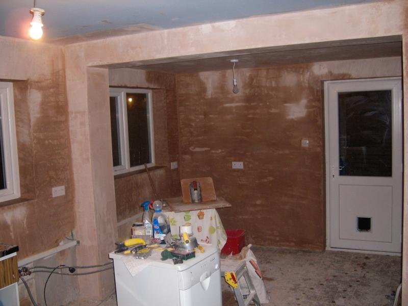

Sent a before and after pic - as feel I've reached a milestone with a first plastered room! :D
I got a builder in to do the beam, box in and skim it. Rest of the room was me.
Leave you to work out which is which....
looks tidy mate,christ that kitchen goes back in time eh ?

... christ that kitchen goes back in time eh ?
Completely! Must be the original one easily. Mind you, I took some of the units out - think things were made better then. Thick proper wood and soundly put together. Pig of a job to get out! :eek:
