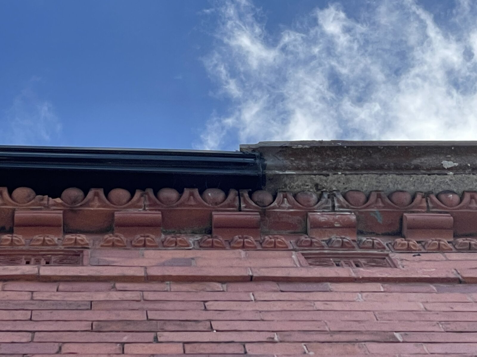

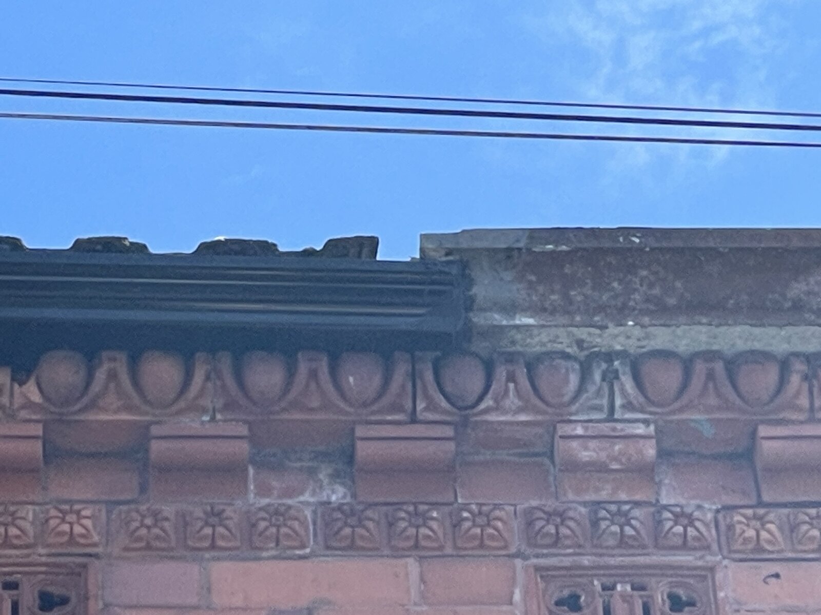

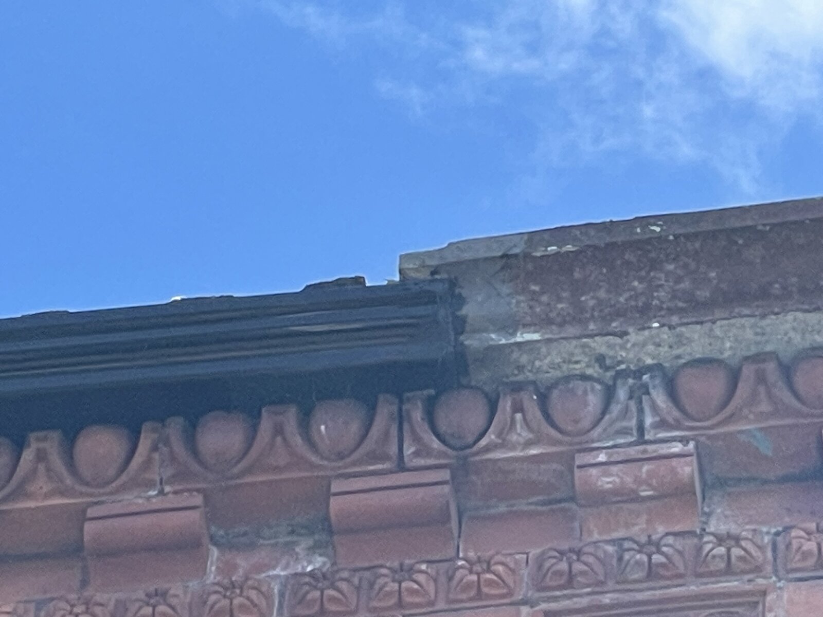

Afternoon all
Had my gutters done not too long ago and this particular point keeps leaking. It’s been fixed a couple of times with sealant but fails again when the seasons change, assume due to temperature change. I’m looking for a more permanent solution, is there a union I can buy specifically? Any advice much appreciated.

it would never have joined correctly. one is cast alloy maybe the new one is too? and different sizes
you wont buy a joiner for that but a good metal shop could make you one.
shame to mess up the decorative corbeling .
One on the left is plastic and right is cast iron (or alloy?). So it needs a bespoke metal join does it? I won’t be able to find a plastic one?
you'll struggle, if you had a piece of the original alloy gutter then you might be able to get a joiner made up
