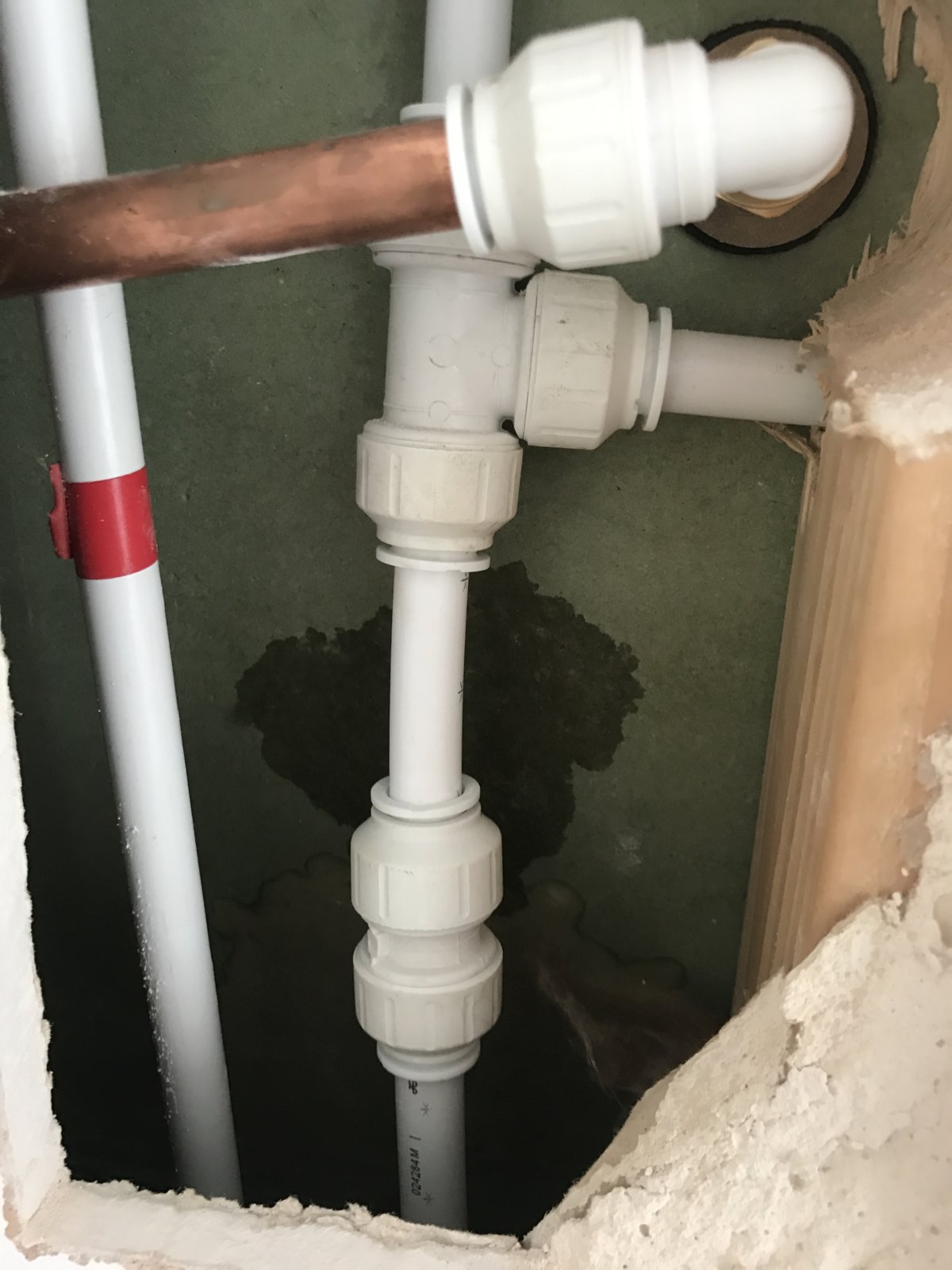

I have Speedfit at my house
I had a leak and was cursing them, pulled the pipe out and found it was my fault :LOL::LOL: I didn't push it into the T far enough, still lasted a year though.

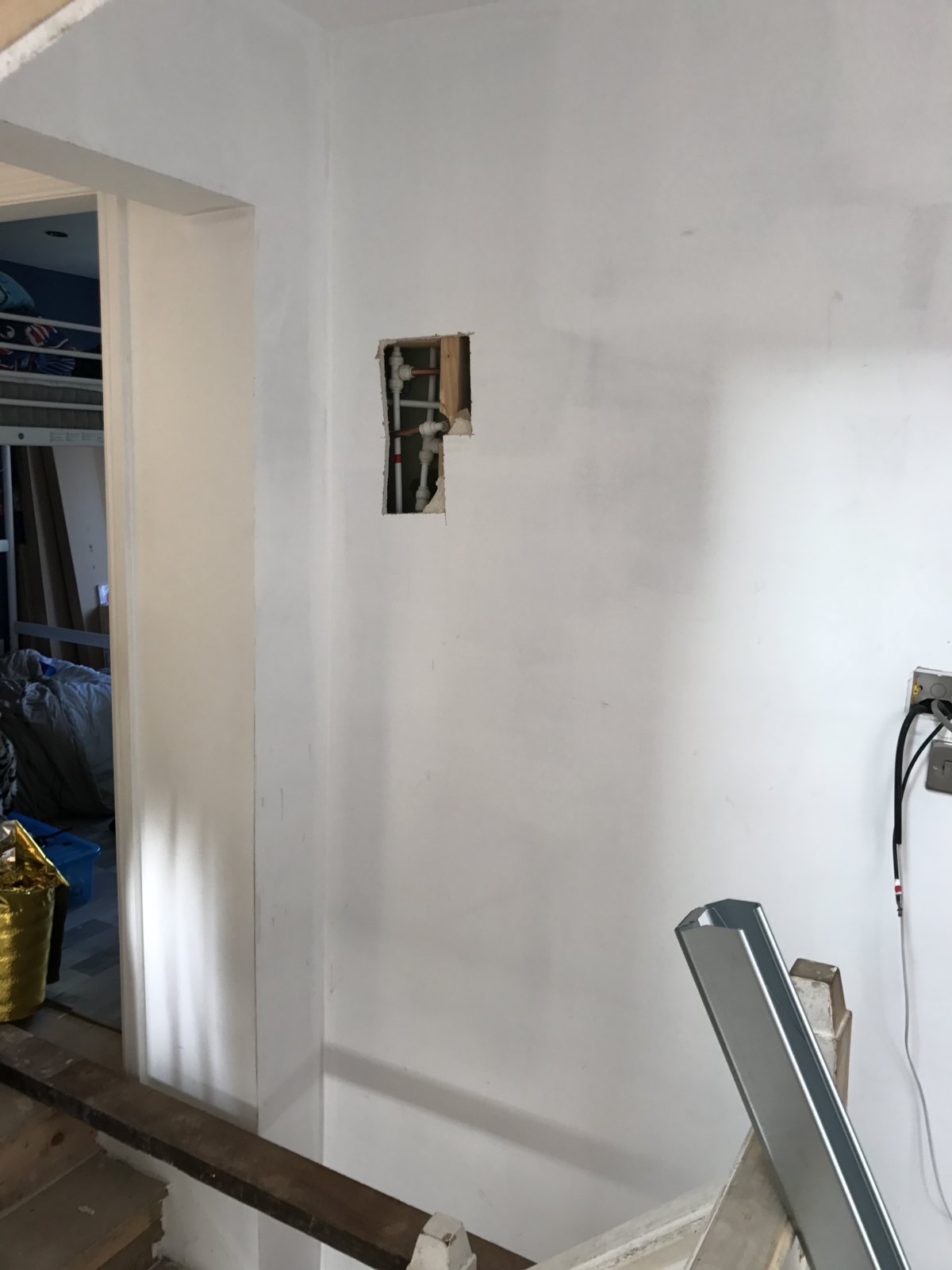

I'm going to hang a picture over the hole in the wall.
