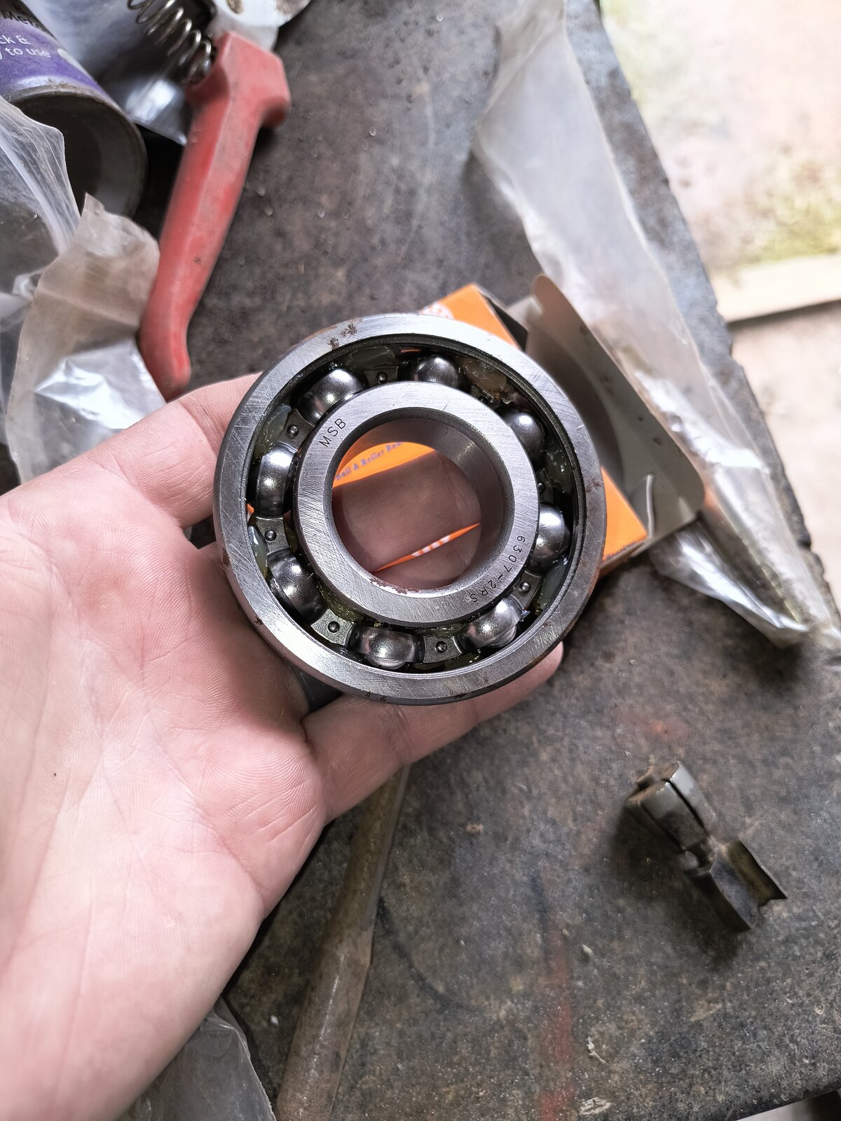

Thank you for your replies.
Burnerman: Please find below requested pictures.
cdbe: the drive belt is old and worn but in once piece, the NSK 6005DU bearing in the drive pully has a bit of a grumble, so new bearing on order.

Thanks for the pics - very helpful!
Top pic......is that a centrifugal clutch or just a heavy duty pulley? Either way, a grumbling bearing won't sort this issue I don't think.
Bottom pic.......from the little experience I have, this is a roller that is spun out of balance, due to the way it is weighted. It's this that causes the forward motion.
Try running the machine slower than you'd expect, and see if things improve?
John :)
The vibration dampers can sometimes contain oil depending on the make/type. Some use atf, engine or gear oil. Not sure of your though as I haven't checked it out.
If the engine runs and increases speed, the pulley turns under load, the belt is intact, the damper pulley turns, the problem can only lie with the damper unit because its all that's left.
I can only speak from my experience, it's the exiter bearings that need checking - they're massive things inside that yellow tube (that should have oil in). In my case they failed and the belt was initially loose (little/no drive) and ultimately thrown off.
The bearings are massive things as they have to support what is essentially a shaft with a massive unbalanced hammer spinning round on it and "whacking" the plate.

The crank pully looks to be a centrifugal clutch, I've not yet had time to pull it apart and give it a good look over, However I will do this when I replace the NSK 6005DU (47x25x12mm) bearing.
The exciter shaft bearings are NSK 6304DU (52x20x15mm), and spin fine by hand, no noise, etc.
The engine should accelerate as the throttle is increased. It doesn't need to be an exact science but will show whether the engine is fuelling correctly and you should see the pulley speed increasing showing any keyways are intact I would think.
If that device on prof's first pic is a centrifugal clutch, the engine should run slowly without the drive engaging, and as the engine revs increase so should the drive.
