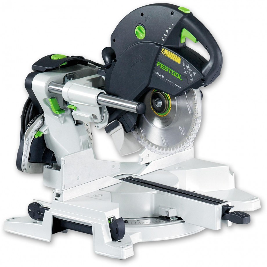

A grand.

Plus another £500 if you want the mobile saw base and right/left hand support tables, believe me......
TBH pretty much every sliding mitre saw I've owned or used over the last 30 years (and that's quite a few of the trade/pro models) has has a degree of flex in the arm (and the longer the crosscut the worse they are), plus as they get older they "acquire" slop in the pivot (cheaper ones have it to start with), and all of them suffer from detente wear - but in any case assuming that cast detentes are right is a waste of time in my experience, the laser cut ones like the DWs, Kapex and one or two of the newer Makitas are far more accurate not to mention that you can see any wear because they are on he top surface. Another thing is that the bigger the blade, the more likely it is to flex in cut - especially if you are making one-sided trim cuts (where only one side of the blade is actually cutting). Of course hit a knot and eject it and the fence can be knocked out of alignment or even bent making for more alignment woes. So it's a bit of a conundrum. One thing I will say is that the trade models tend to be far better than the DIY models in terms of rigidity and accuracy, but even then they aren't perfect. I've not long finished a restaurant fit-out where we did a substantial number of mitre cuts on sapele box sections and mouldings (many at the capacity of the 12in saw) and for some cuts it was necessary to plumb and square the saw for every cut before setting the mitre then make tongue in cheek adjustments (that was on two nearly new Makita LS1219 saws, BTW) because the saws were constantly running out
