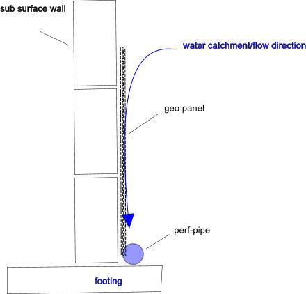

My apologies AP I didn't note the position of the drain as on the uphill side, was describing what I thought was on the downhill side.
My only thoughts on the perforated pipe collector, is that at best it's a bit hit and miss. Placing it on top of the footing acts as a catchment dam and only demonstrates this was considered as a boost to the perf-pipe, in my opinion.
Better would be to hang a geocomposite catchment panel on the vertical surface of the sub build wall, with perf-pipe at the bottom providing the run off.
Something like this -
Thanks again pinenot.
Can you recommend any specific geocomposite panel names?
Given that there are holes in the wall between the bricks, I assume the catchment panel will need to be pretty much waterproof to avoid ingress. Right?

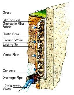

DRAIN AWAY™ PANEL DRAIN -
DMX Drain Geocomposite Drainage boards
Your best bet may be to speak to a local road builder who will know about geocomposites or vertical drainage as it's sometimes known, although in your instance, you are looking for the domestic version.
Good luck...pinenot
