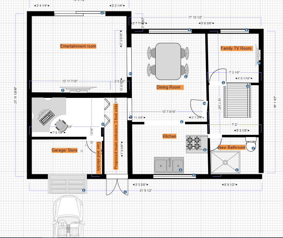

What do you think of my home improvement plan
Just planning reorganisation of downstairs. Ofcourse will get it done through architects before PP submitted or does it need PP submitted?
In summary,
1) I want to covert 2nd door on front with 3ft passage into new front door.
2) Box off existing porch/ main door and make bigger bathroom downstairs. Wet room so it allows study/ family tv room or small room to be changed to 4th bedroom for elderly parent if needed in the future.
3) Convert back of garage to home office. In my proposed drawing I could not draw the external wall like the way it is. The place where the small door is leading to garden, will get window to light let into home office.
4) The wall where it says gas and electrics is where CU unit and gas meter is. I understand this has to be outside or non-habitable place. Its right now in the garage. I did think of getting it moved but since moving prices are extortionate and i need some storage space i thought dividing garage might br cheaper option.
5) The thicker walls I assume are load bearing. Just copied from designs of neighbouring house identical to mine.
6) The area covered by glare is downstairs small toilet and store under the stairs.
So can you spot any obvious howlers.
Is the new front door idea flawed.
Do i need PP for above work.
Any other design suggestions.
I want to develop downstairs first. Will aim to get the foundation adeqaute to extend over garage and living room. Right now falt roof. All my neighbours have extended over garage.

A to scale existing plan vs proposed plan would be more helpful.
A list of what you want to actually achieve is helpful too, in order of priority, that's what any designer will need/ask for in order to achieve what you want anyway.
Meters can stay where they are and within a habitable room IME (unless your BCO is a dick).

Appears you have chopped up the space with additional walls which imo waste space . I would make it far more open plan that as designed .
As above, maximise kitchen/ living area into one room.

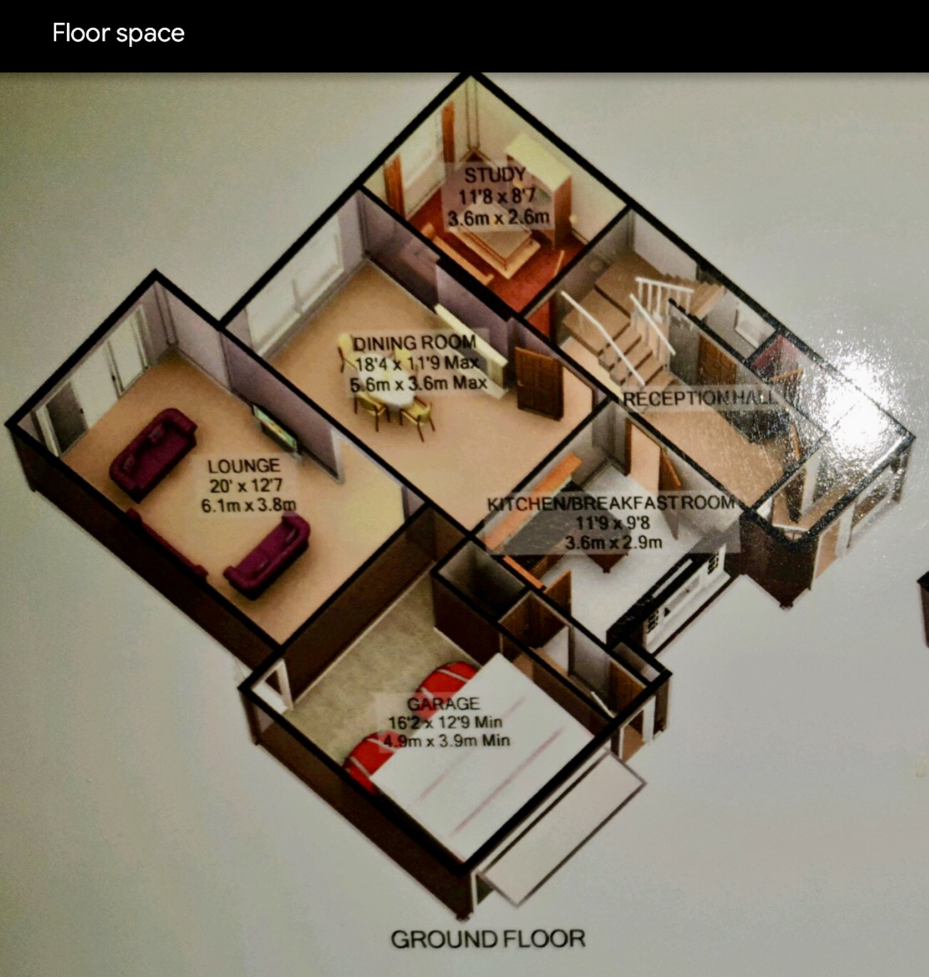

The 1st image is what the layout was when i purchased house in 2009. Now kitchen does not have door leading from hallway. And kitchen and dining room connected via double french door to create open plan.
The reason why i love my location is nearest house at the back is over a mile away. House however gets pretty cold or expensive to heat. I have maxed out on insulation options.
Am I right to assume the old porch when coverted into bathroom will need to be flush with existing building. Right now it is few meters out as is a porch permitted under PD.
Dunno, need to be psychic to work out what was existing, what is as is built now and what you're planning. Already asked for proper plans, won't ask again.
The pictures 1st document is existing and 2nd picture I have drawn is proposed. Still early stages not hired architects
I'll ask on his behalf - plans (drawings, not strangely angled 3D representations), to the same scale in the same orientation - the plainer the better. I'm sure you've studied it for hours and it's all clear in your head but for the rest of us its just brain ache.
For benefit of others in my position. Planning permission will be needed. Confirmed by Planning dept. Relocation of main door is not main issue. The width of passage which is 3ft will be narrower than existing one so that might get challenged when application is made.
