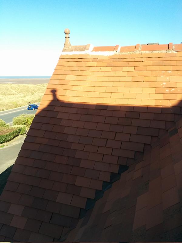

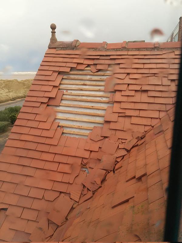

Due to storm damage in February which left large areas of missing Rosemary Tiles on our roof, we had some repair work done. As we live less than 0.5km from the coast the wind speeds did some significant damage - please see image below:-

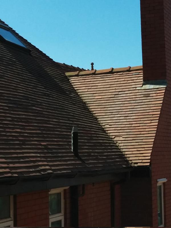

Unfortunately, after the roofer has carried out his repairs the repaired areas look extremely patchy compared to the rest of the roof. I have been told by the roofer that over time they will blend in, however I have my suspicions that the wrong type of tile may have been used ie Rosemary red instead of Rosemary Mixed Brindle light etc. Please see images below:-
I am also slightly concerned about the gaps between the tiles which are big enough to get your finger into, however I am of course no expert.

It does look like he has used plain rosemary tiles so if yours are brindle then they are not going to be a good match.
Thanks for the comments gents.
I'm not entirely sure what our original rosemary tiles are to be honest. I've tried looking online to see comparisons of rosemary brindle vs rosemary plain but can't really find any good info to help me definitively decide. Is there anyone on this forum with experience to help me decide?
Thanks for bringing up the pointing Tony, I'll definitely bring that up with them. I've actually just noticed they've not pointed one of the ridge tiles further back where a repair was made too!
