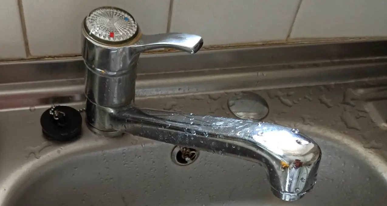

Hi. Today my kitchen mixer tap broke (head snapped off the cartridge). Pic of the tap:
From a quick Google, it's an obscure cartridge so I'm better replacing the tap. However, I have an old heating system with a Baxi back boiler and a cold tank in the loft and hot water in upstairs airing cupboard. According to a post I made last year (https://www.diynot.com/diy/threads/replacing-old-designs-of-taps-with-new.612100/ - thanks @Madrab and others) I need a dual flow mixer tap to avoid backflow (I'm not too concerned about output pressure; the dishwasher does the washing up and I wash my hands in the bathroom, so it's mostly just for cold water). However, between Screwfix, Wickes and Toolstation it's almost impossible to find a kitchen mixer tap labelled as dual flow. I found and bought https://www.wickes.co.uk/Wickes-Toba-Monobloc-Kitchen-Sink-Mixer-Tap---Chrome/p/180982 : "Dual flow tube spout", "Suitable for both high- and low-pressure water systems" and min pressure of 0.2 bar, which sounds good. It also has the design I wanted (separate hot and cold levers):
However, I opened it, unscrewed the aerator and looked in. I can't see any separate channels, and I was able to push a piece of cardboard through about half of the way (the length of the cardboard, which was the diameter of the spout, ish). Does this mean the tap is unsuitable and was mislabelled in three places? And if so, are there any actual options for a dual-flow tap these days from somewhere like Wickes, TS or SF? I found https://www.magnettrade.co.uk/products/axiom-dual-flow-tap-chrome/ but doesn't look like they sell to DIYers.
And on installation, the current setup is:
To remove the current tap, I just undo the nuts on that bolt using https://www.wickes.co.uk/Rothenberger-Monobloc-Tap-Spanner-Set/p/118702 right? And the spiral clamp thing will just come off? And then for the water inlets, it is all in rigid copper now, no flexi hoses. It looks like the pipe is tapered from 15mm to M8(?) using something like https://www.showerspares.com/search/bristan-15mm-copper-pipe-and-m8-adaptor-pair-sk420013/ - so should I use this tapered copper pipe, or should I cut it once it gets to full 15mm (above or below where the 15mm-to-m8 is currently soldered, just below where the picture ends?) Will I need a double check valve? My current plan was to use the flexible tails it comes with, along with https://www.toolstation.com/flat-faced-male-straight-isolating-valve/p95064 to have an isolator too, but it would be cleaner to have just one piece - something like https://www.wickes.co.uk/Primaflow-...onnector---15-X-12-X-300mm-Pack-Of-2/p/160136 to connect the 15mm copper to the tap directly, but I can't find one of those with an isolator valve. Although if I need a double check valve I'll need to change plan again, and maybe skip the isolator, as there's not too much room under the sink.

My understanding, is that - stored water and fresh water should never be allowed/able to mix, which means the spout needs to separate the two, all the way to the exit of the spout.
The fact that they state that the tap has a dual flow spout should mean that there are 2 separate flows into the (low pressure) spout to stop the water from fighting each other in the body of the tap, with the higher pressure always winning out. When you look at the exploded diagram though, you can see that there is an adapter that mixes the 2 flows, one outer flow and one inner, just after the body at the bottom of the spout which will probably achieve the same thing. It means that it would act like a venturi rather than the flows being able to oppose each other.
Old designs of dual flow would have the separate pipe running internally up to the end of the spout and then mixed at the end. I'd give it a go and see how it runs.
Yes - loosen the nut and the metal C clamp and rubber washer will drop off. Undo one of the copper tails and the old tap will lift out. If the new tap has flexi's then how that connects to the supply pipework will be different and that should really have ISO valves. You can then file down the outside edges of the ISO's for the flexi's to fit to (to avoid the sharp edge of the valve cutting into the rubber seals in the flexi's) or use tap tail connectors in the ends of the ISO's for the female flexi's to fit on to.

The current pipework is 15mm copper which tapers (I mean gets thinner) into the tap directly - looks like one of these things: https://www.showerspares.com/search/bristan-15mm-copper-pipe-and-m8-adaptor-pair-sk420013/ . But I'm guessing this time it'd be easier to cut away below where this is soldered in and replace with flexis (+ isolators +possibly double check valves)

Ah ok, so the current tails are soldered to the supply pipework, yep, need cut and then ISO's added. I wouldn't add double check valves, certainly not onto a gravity supply, as that could seriously impede the flow, pressure dependent, singles or even an NRV and only as a last resort.
