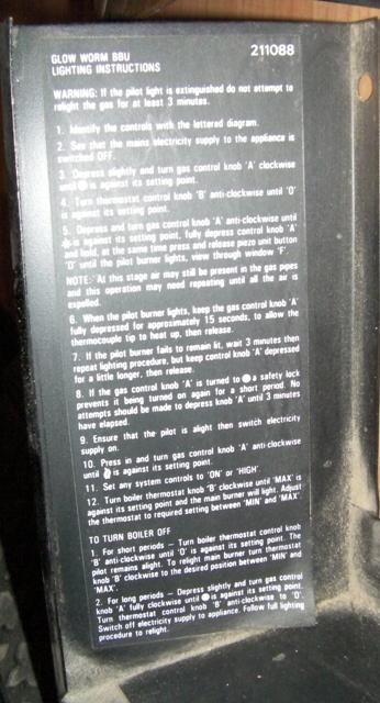

I have not removed the fire front but can see the BB quite clearly. It appears to be a 52 unit but I cannot be sure of it. These pictures are of the only labels on the unit.

If you have no motorised valves then you have gravity hot water circulation to your cylinder and pumped circulation to your rads. Find the pump and check that its working and get back.
Hi do you still have hot water if so you might have gravity hot water and pumped heating if you do the pump may have failed, theres no internal pump on a bbu that I know of so its probably hiding under the floorboards or boxed in beside the bbu this would be the first thing to check hope this helps Paul.
