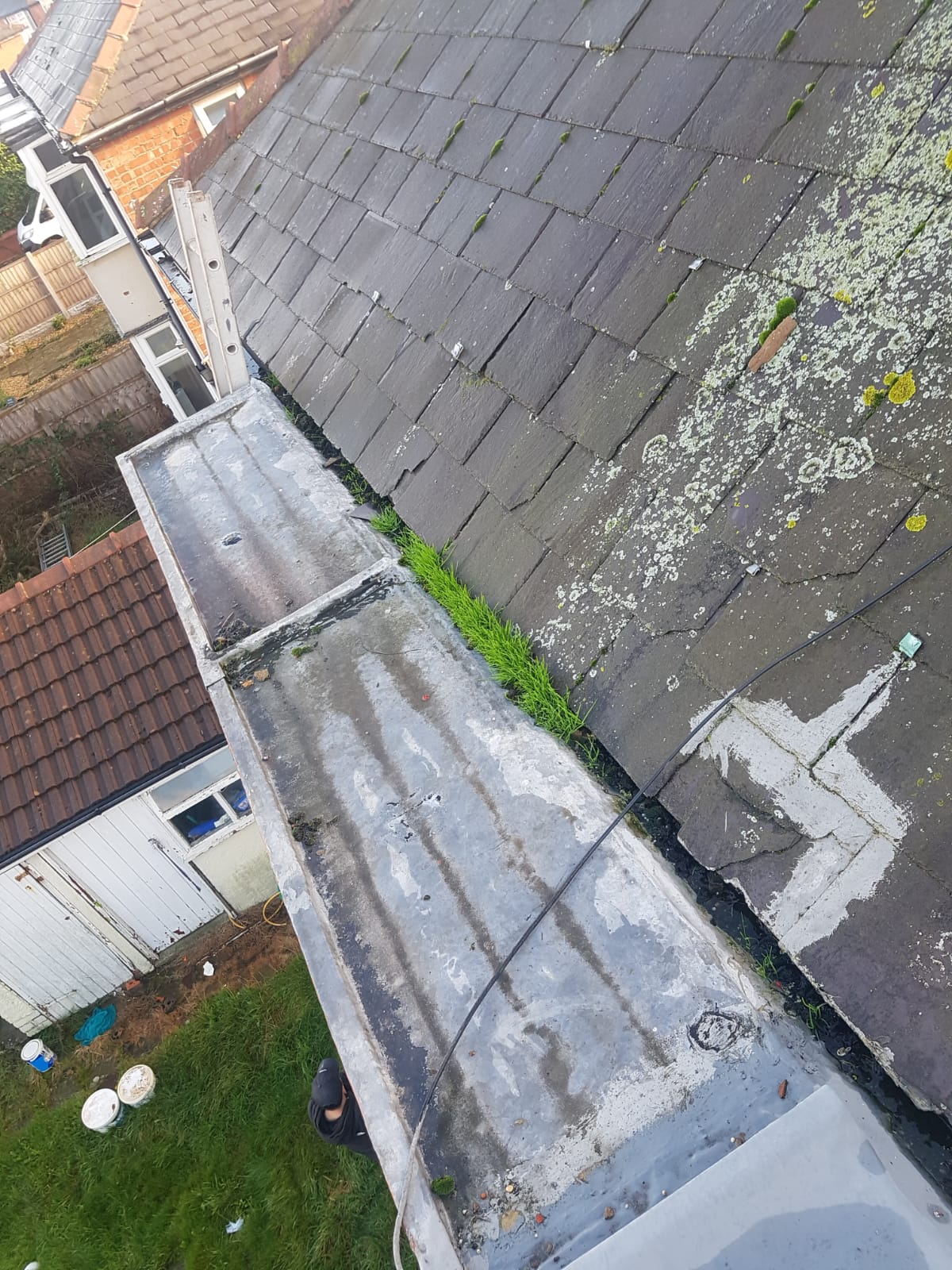

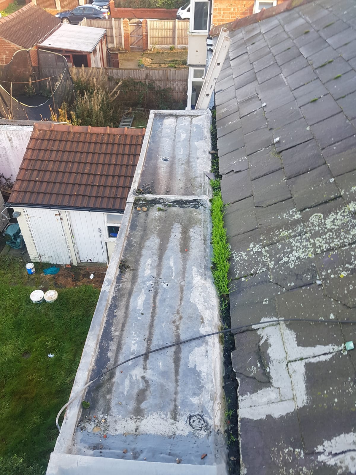

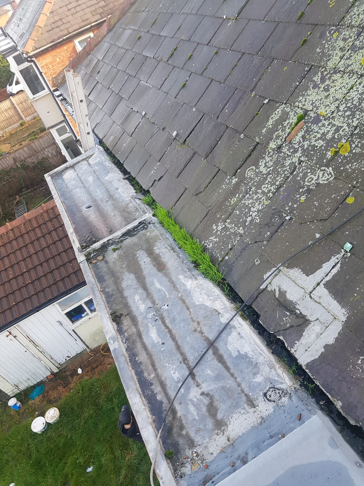

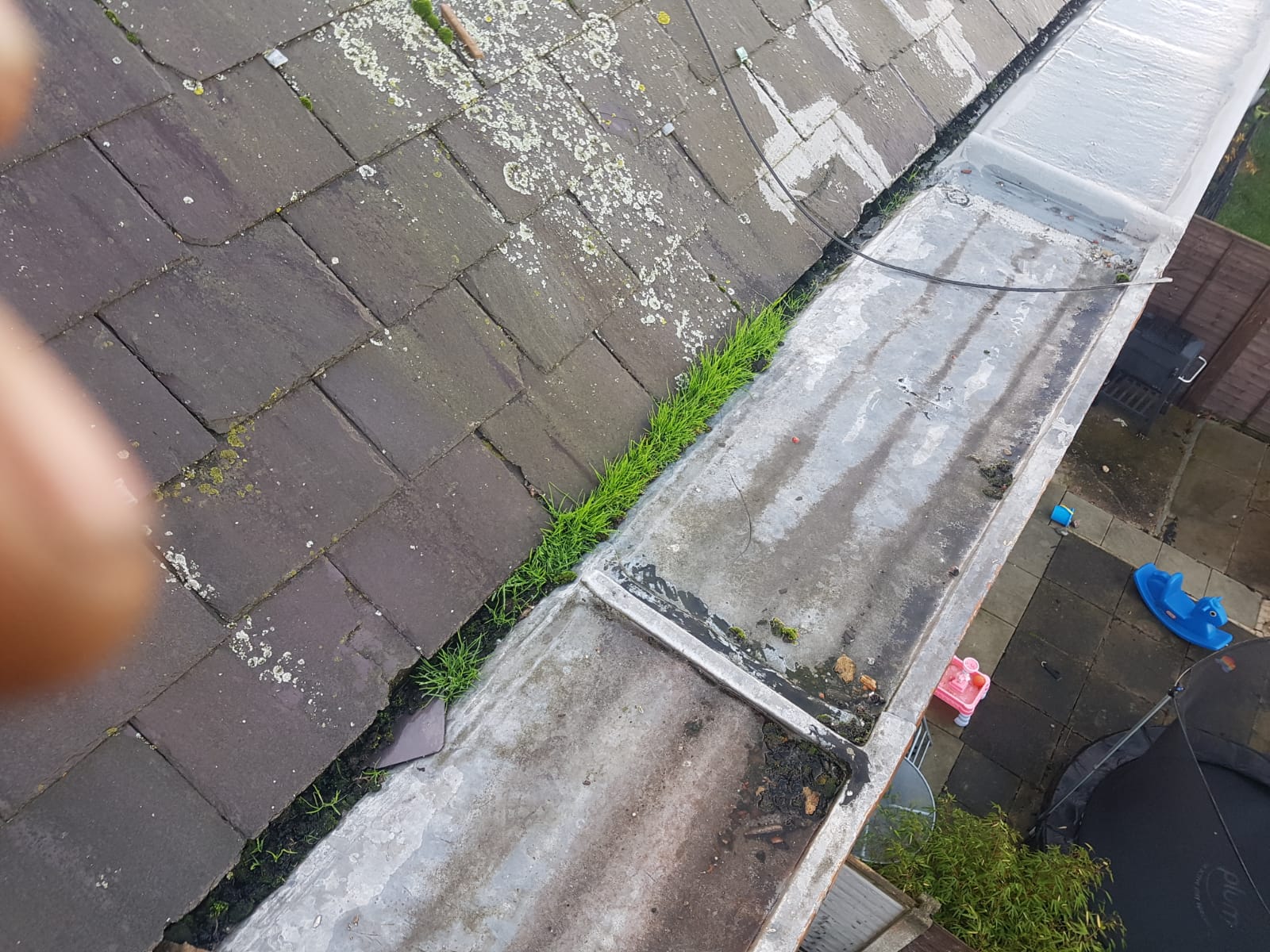

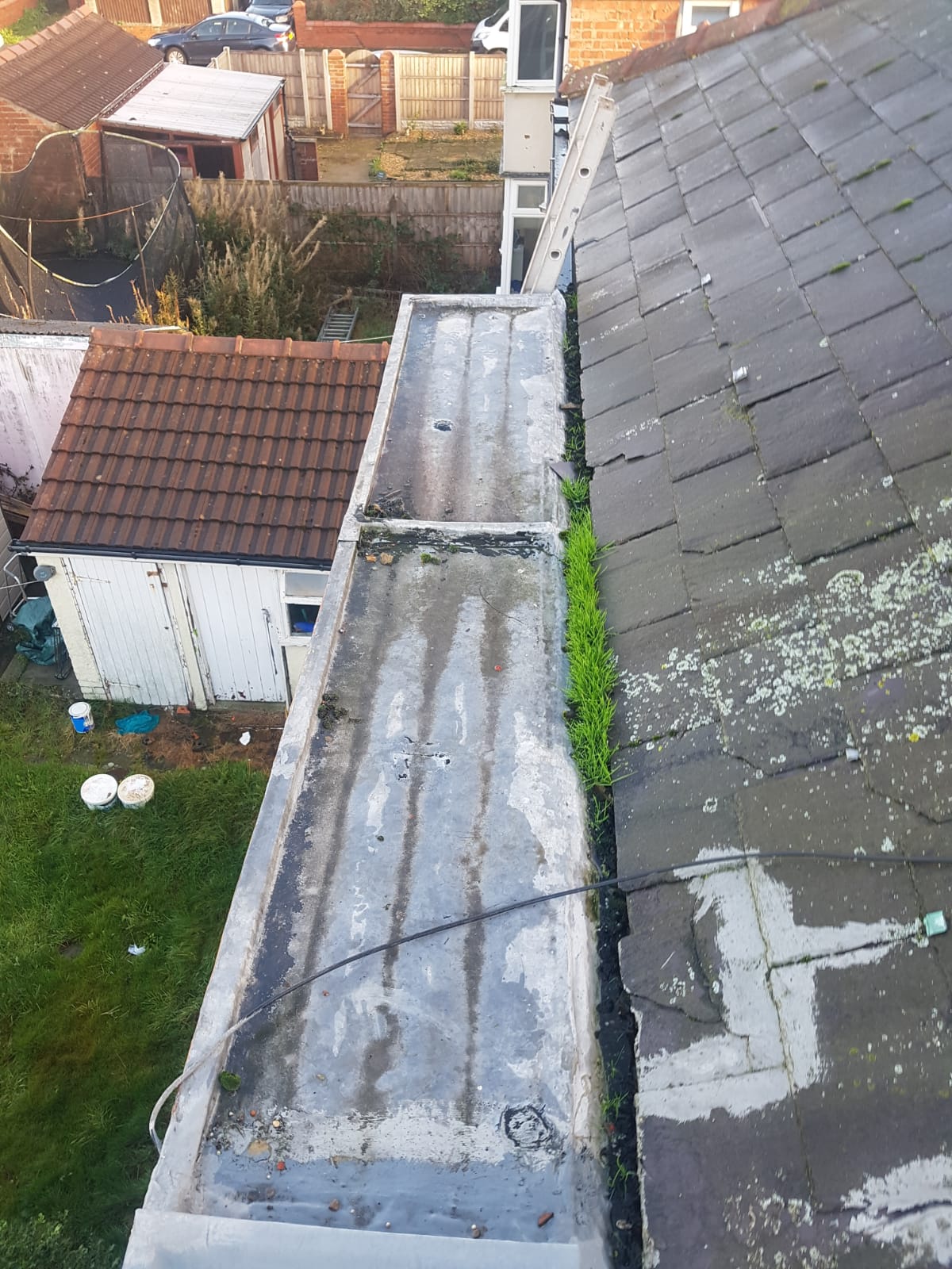

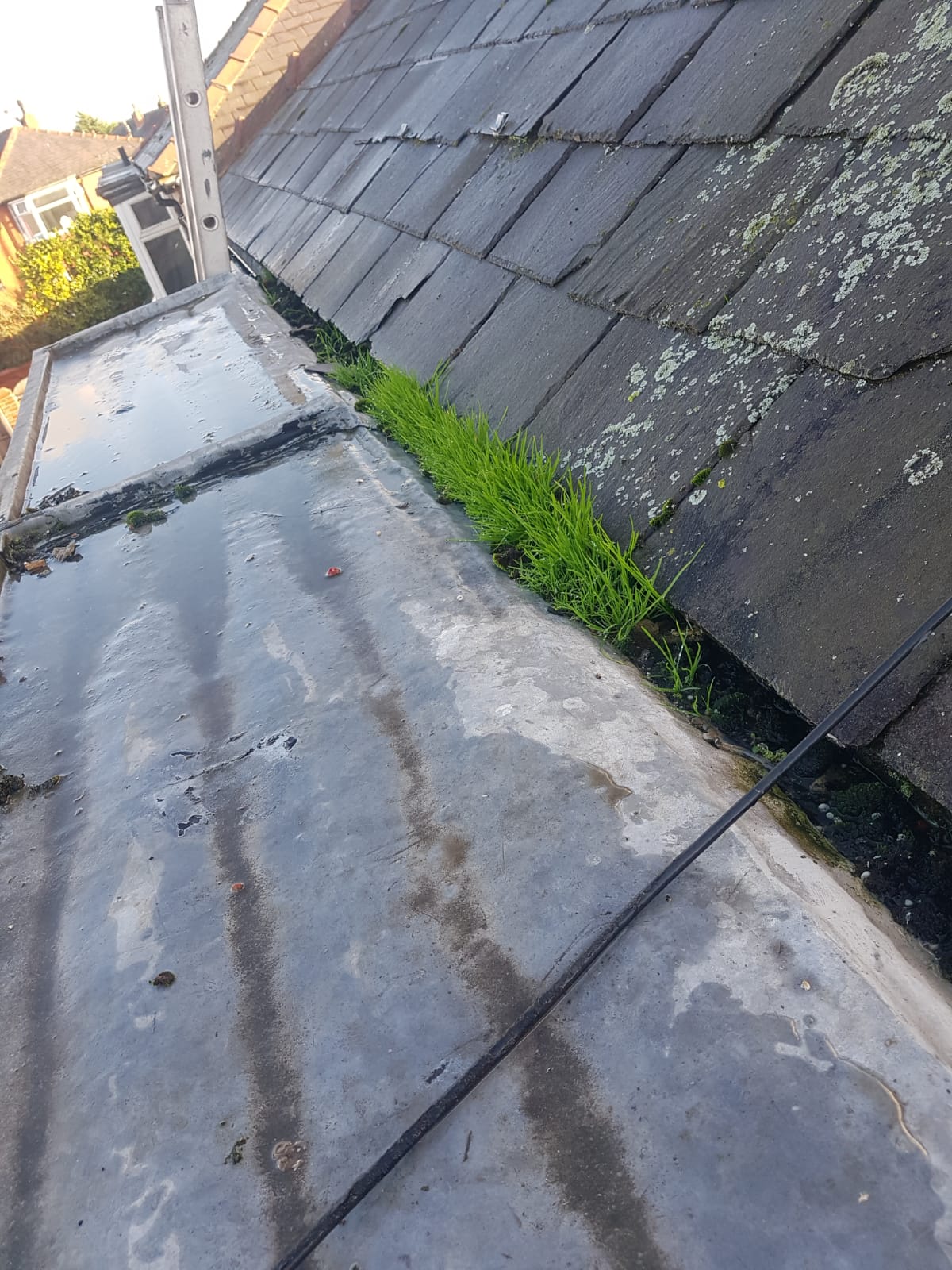

Roofer has been up today and shared photos. Looks like the neighbour has never bothered to clean his side out and there is a garden growing up there !
The roofer is planning to remove the original shared cast iron gutter, clean everything out, fibreglass paint the under tray and then put in a plastic gutter end to end. He's also going to replace the neighbours roof with GRP like my side.
Noting the above it looks like it will be a good idea to have an annual cleaning of the gulley.

Also is it just me or does that look like a really poor design ? Why not have no gap between the tiles and house roof, and then the gutter running around the front.
its not ideal ,
The gutter garden will cause a build up in water depth which will leak in. you and your neighbor should keep them clear.
It might have been good to see the far end of the GRP (grp is for boats)
If you had got together with next door you could have easily changed to gutter around the outside. But you still need to clear them
Some slate damage that needs sorting, shame about the gunk painted over what is a good slate.
Another option I guess is get together with next door , strip out some of the lower courses of slate do the whole lot up under the slate roof so you have no joins.
I hate to say it , this could easily be done in GRP or even EPDM.
Then put slates back.
It appears your guy hasn't gone under the slates
