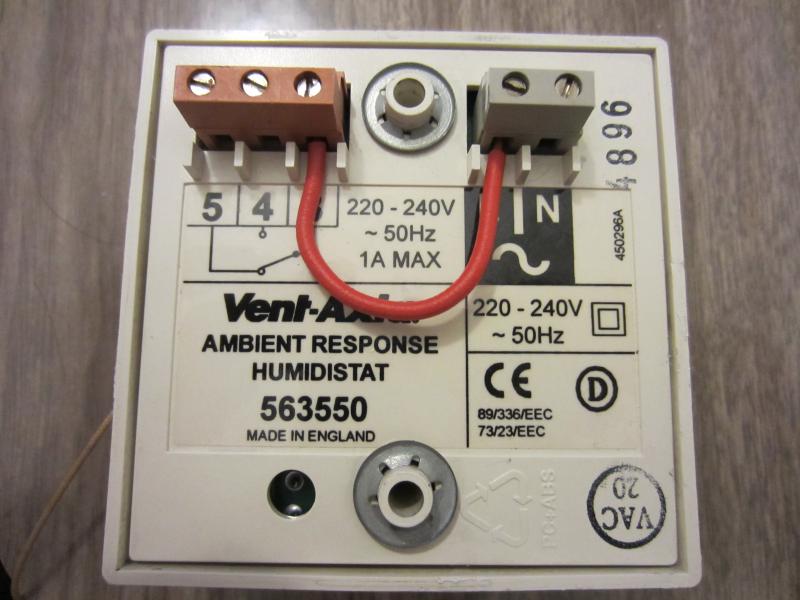

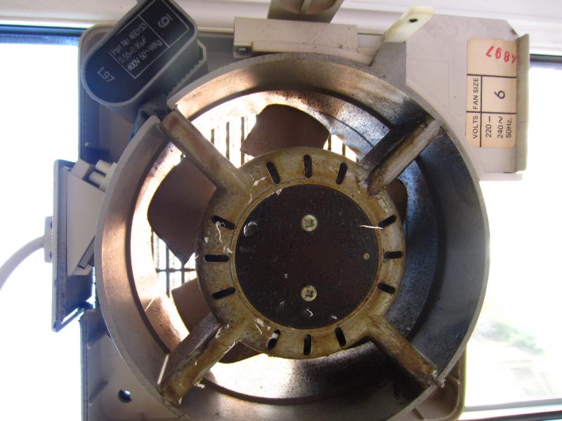

Hello I just moved into a new flat and the kitchen extraction fan doesn't turn on. It is connected to a humidistat vent-axia 563550 with a pull switch. There are three wires from the window mounted fan blue, yellow and brown. The humidistat has 5 4 3 L N with a red wire between the 3 and the L. I have no experience with electrical. Thanks for any input.
Hello I just moved into a new flat and the kitchen extraction fan doesn't turn on. It is connected to a humidistat vent-axia 563550 with a pull switch. There are three wires from the window mounted fan blue, yellow and brown. The humidistat has 5 4 3 L N with a red wire between the 3 and the N. I have no experience with electrical. Thanks for any input.
Is there a switched fused connection unit nearby that may not be turned on?
Your description seems to contradict the manufacturers instructions which have links between the L cable but not the Neutral cable. It is difficult to know from the instructions whether any links are factory fitted.
Can you provide photographs of what you have described.
Also have you read the instructions, this appliance has an overide facility

Thank you for your quick response. It was a typo, it was the L. I have posted some pictures of the unit. I can't find any connections near by.
From your pictures have you removed the live and neutral supply and load cables?
Because you humidistat and fan won't work without cables to carry the electrickery!
From the manual - leave the red link wire in place.
The supply neutral loops in and out of the N terminal and goes to the N terminal in the fan.
The supply live should go into the L terminal with the load live going into the terminal 4 and then onto the L terminal at the fan.
This is a class 2 piece of equipment so there is no need to utilise the earth - put in a terminal block and tape up.
Do not do any of this if you do not know what you are doing and/or you do not understand what I have said - and do not do anything unless the circuit is dead.
