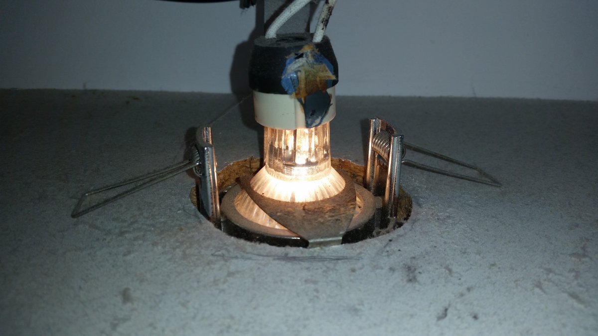

I hope someone can help me with what seems to be a simple problem but is baffling me!

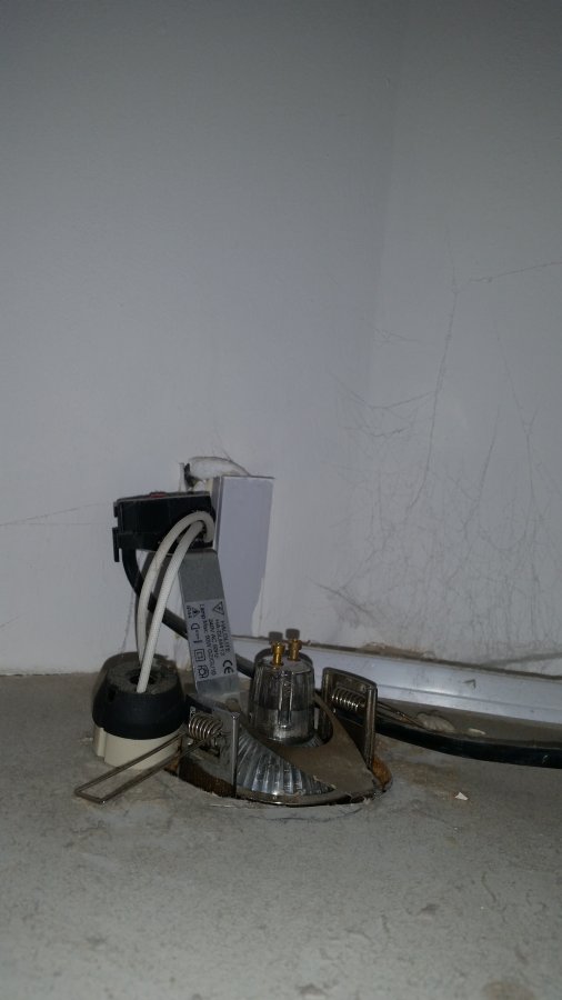

I have 2 spotlights in my bathroom, above the mirror. They are GU10 bulbs which I'm used to changing the usual way; however these ones have to be changed from the access above the bathroom cupboard - see pictures, one with bulb connected, the second I have disconnected the bulb but I cannot figure out how to get it out of the contraption it's in! Has anyone ever come across this before?
It's like 2 spring-clips on each side then a metal lever thing in the middle which lifts up and down but I just can't seem to get the bulb out and don't want to force it..
Any help is much appreciated!
Thanks,
Caz

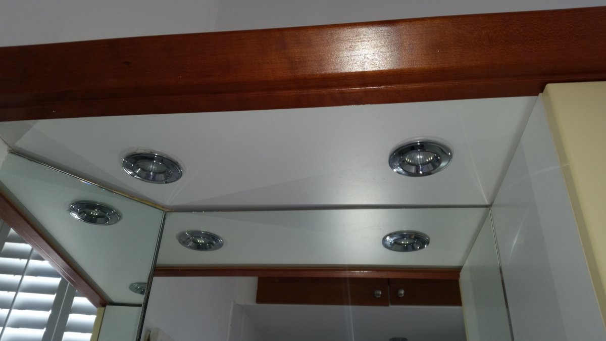

Would need to see a picture of the fitting (from the room). The fitting is usually in two bits. The outer part (this stays in the ceiling) and an inner retaining bezel that is held in place with a couple of sprung ball bearings. you should be able to pull it apart with your fingernail, or a small screwdriver if you dont want to chip the varnish.
does that clip that goes over the lamp not just prise off on one side and then the other?
That fitting seems to have seen better days, has something melted onto the lamp holder?
Hi
The pics I posted above aren't taken from the ceiling, they're from above the cupboard that the lamps are fixed into. I have these spotlights in my house but they have a round wire that goes around them that you can ping out with your fingernail then take the bulb out from below, but these ones don't seem to have that. Here is a pic from below:

The bezel should come of from below, normally a quarter twist anti-clockwise or prising using a flat head screwdriver, the lamp should then drop. The first fitting pictured seems to display heat damage, if so needs replacing and then preventing.

Hard to tell if the glass is seated in the top recess or under it.
I have seen some where you do have to carefully take the fitting out.
Then You need to be a bit heavy handed to remove the lamp , by sliding the lamp up and out as you turn the lamp at sort of 45 degrees, the metals springy and will give enough.
To fit is the opposite and the springy bit keeps tension on to the lamp pushing against the body.
the body is sometimes a one peice moulding

While your here Ban can you blow up the label to get make model if poss please
Which is broken - your Ctrl key or your + one?
You did tell me how to do it years ago but I forgot, so You would get a THANKS for that, but wheres thanks and like button gone now
Still cant read it though HALOLITE possibly
