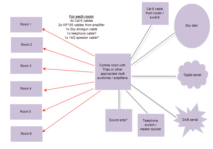

Hi
Below is an example of my proposed setup. Are my following assumptions correct?
1. To get Sky in each of the rooms, should I run Sky shot gun cable (WF65?) between the dish and each room directly or can I take x (how many?) cables from the dish directly to the comms room and into a multi switch and then Sky shotgun (or 2 sets of WF100 cables) to each room?
2. How many WF100 cables should I run to each room from a multi switch (I personally think one is enough as I could always split an amplified signal when it comes into the room as it's coming from the amplifer anyway in the comms room?
3. Can the WF100 cables that come to each room from the comms room carry both the DAB and Digital TV signal? If so, how do I think separate it when it comes into each room?
4. How do I handle multi room audio
To add some background, my property is all open walls, ceilings etc so I am not restricted by anything.
Thanks.
1. You need a quatro LNB on the dish and a multriswitch in the comms room feeding shotgun cable to each room. NB quatros are not made to fit sky dishes. You will need a 60cm conventional dish (60cm because you need the next size up for multiswitch systems).
2. Three to allow for future upgrades.
3. Yes. Use a DAB/UHF diplexer in reverse. These can be built into wall sockets.
4.Not sure, but I would assume you need 2 speaker cables to each room not one.
5. There is NO SUCH THING as a digital aerial. Amend your diagram.

1. When you say a quatro LNB, how many cables are coming from the 60cm dish - is it 4 sets of shotgun cable coming to the multi switch? Why not 2 or 3, or 5 or 6, why 4 (assuming it is 4)?
2. The WF100 I was referring to was for aerial usage. What would a second or third cable for future proofing be used for? Were you implying for Sky or Freeview?
5. Ok then, just a log periodical aerial?
1. A quadro LNB has 4 outputs, so 4 cables.
2. Neither you nor I know the future but spare cables tend to come in useful and don't cost much. Supposing for example you decided you wanted to get signals from another satellite, perhaps even Ka band at some future point.
But absolute minimum right now either 2 WF100 or shotgun for sky and another WF100 for aerial feeds.

There are (in general) 5x input cables feeding in to a multi-switch. These are the four feeds from a Quattro LNB plus one feed that could be a direct input from a TV aerial, or it could be a combined (multiplexed) feed from TV aerial, FM aerial and a DAB aerial.
"A picture is worth a thousand words":-
http://www.satcure.co.uk/tech/multiswitches.htm
Don't think in terms of "terrestrial" and "satellite" for cable - just run minimum of 2off cables to each "watching point". A good cable will carry terrestrial TV, satellite, DAB, ... - or a combination. As hinted at above, many multiswitches have a 5th input for TV/FM/DAB and this will be sent down the same cable as the satellite signals. Just use a diplexer/triplexer plate to separate them out again behind the TV.
Yes, as above - just stuff the signals into the multiswitch and they'll all arrive at all the outlets.

Yes have already bought more than 500m of Webro WF100 cable. From the chimney (where the dish will be installed to the comms room) I would say it is approx 30-40m and similarly for the TV and DABs aerial. Then from the comms room multi switch to the further room (loft room), it is 20m each.
So around 60m in total then. That's a reasonably long run, but WF100 has somewhat lower losses than WF65 (as used in a lot of "shotgun" installs). I'll have to leave it to someone with more knowledge than I have to say if the losses will be significant enough to need further consideration.
