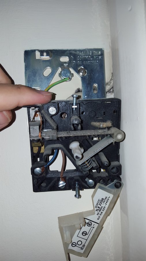

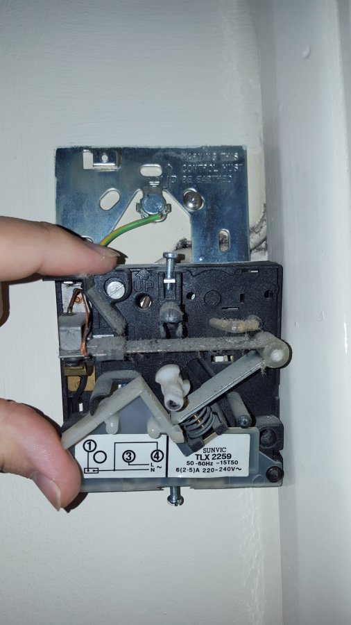

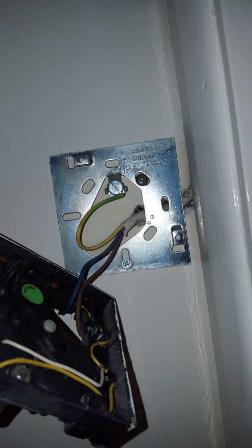

I have a Worcester Greenstar 24i junior boiler and a thermostat SUNVIC TLX2259. I wanted to change my sunvic with a new thermostat as the old one was poorly mounted in the house and it was old and not to be trusted in terms of temperatures :)
I went with the SALUS RT500RF, as it had good reviews and seems that more and more people are getting these, probably because its cheap. I know its not the best option but i wanted to have something that i can move from room to room.
The current thermostat (SUNVIC) has only 3 wires coming to it: a ground wire, a blue wire and a brown wire. - i have attached pictures with everything.
My SALUS seems to need a more complicated setup and i don't understand what can i do and how to sort everything up.
As you can see in the pictures it has the following connectors:
NO
COM
L
N
What wiring do i need to do to make the SALUS work?
Can someone please help me.
I have attached as many pictures as possible so its easier to see what i'm dealing with.
Thank you so much for this.
The wiring to the existing thermostat cannot be used.
Wiring for the old thermostat should be disconnected and removed.
The new thermostat is a wireless type, the receiver box is located next to the boiler and wired to it according to the instructions supplied with it and those for the boiler.
The battery operated thermostat can then be located wherever you want.
Thank you so much @flameport.
Can you or anybody else help me wire the boiler to the new thermostat please?
I have basic to medium knowledge of electronics.
