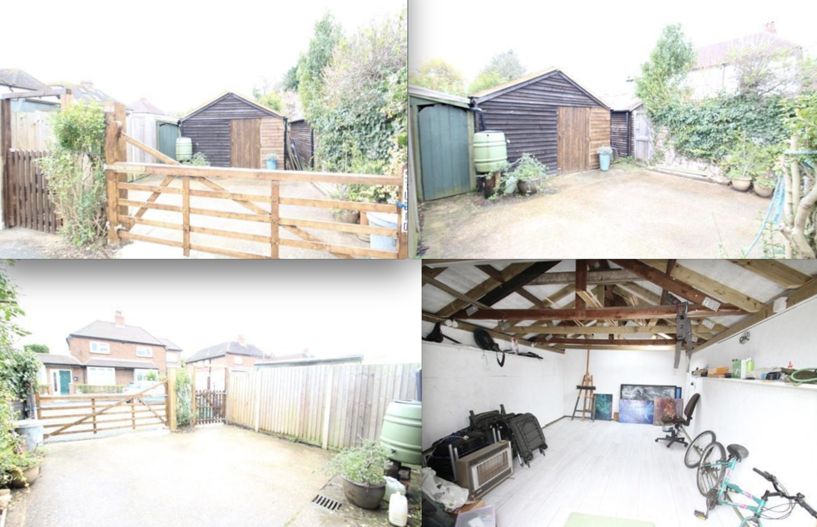

Hi Guys,
I am totally new to building/plots of land/planning permission etc.
I have seen a plot of land advertised with a 'workshop' on it and I am wondering if it's suitable to build a house on top of.
It is 19x36 feet in size (684 Square Feet). It has access to the road. It is situated in a residential area. I'd aim to build a 1 bedroom property with 2 floors. Kitchen/Living space downstairs, and double bedroom and bathroom upstairs.
I have the following questions:
1. Is it unusual for people to sell plots of land without planning permission, that are good candidates to be granted it? This plot is small, so maybe they just assumed it isn't viable, or maybe it is actually the case they tried to get PP but failed. Is there a way to check to see if anyone has ever tried to get PP for a specific plot in the past?

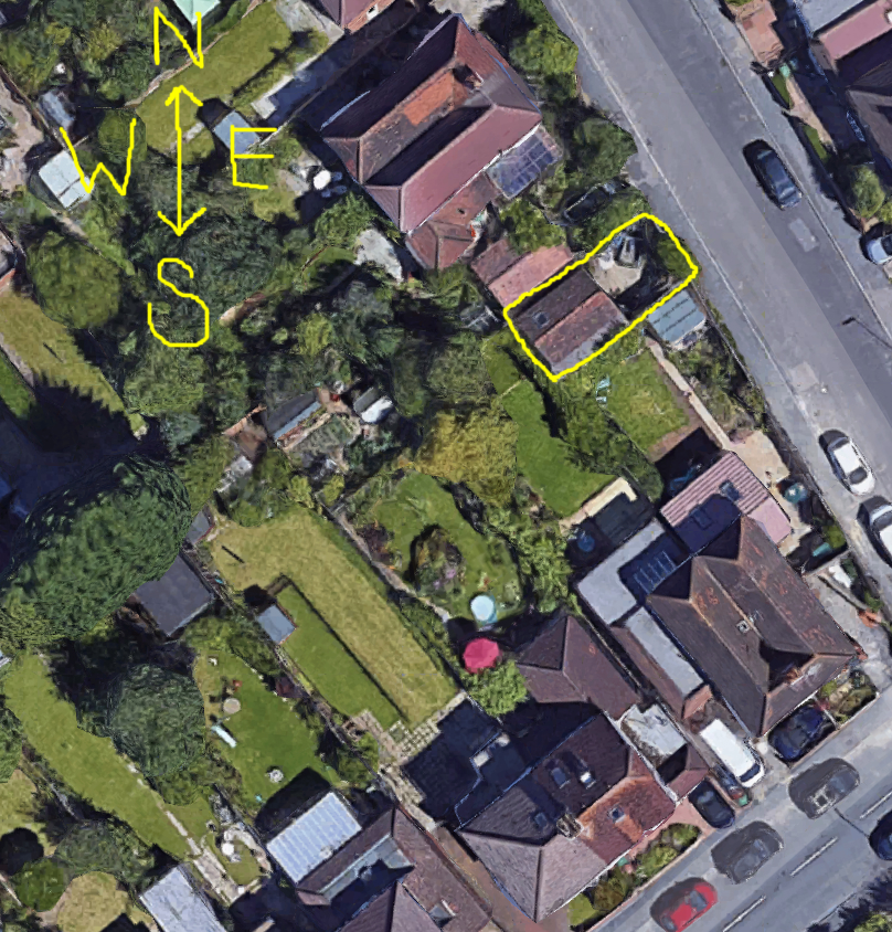

2. Can you build to the full extremities of the plot, or are there rules saying you have to leave a certain sized gap between house and fences? I understand the builders will likely need some space to work - so maybe I'd need to leave some room for that?

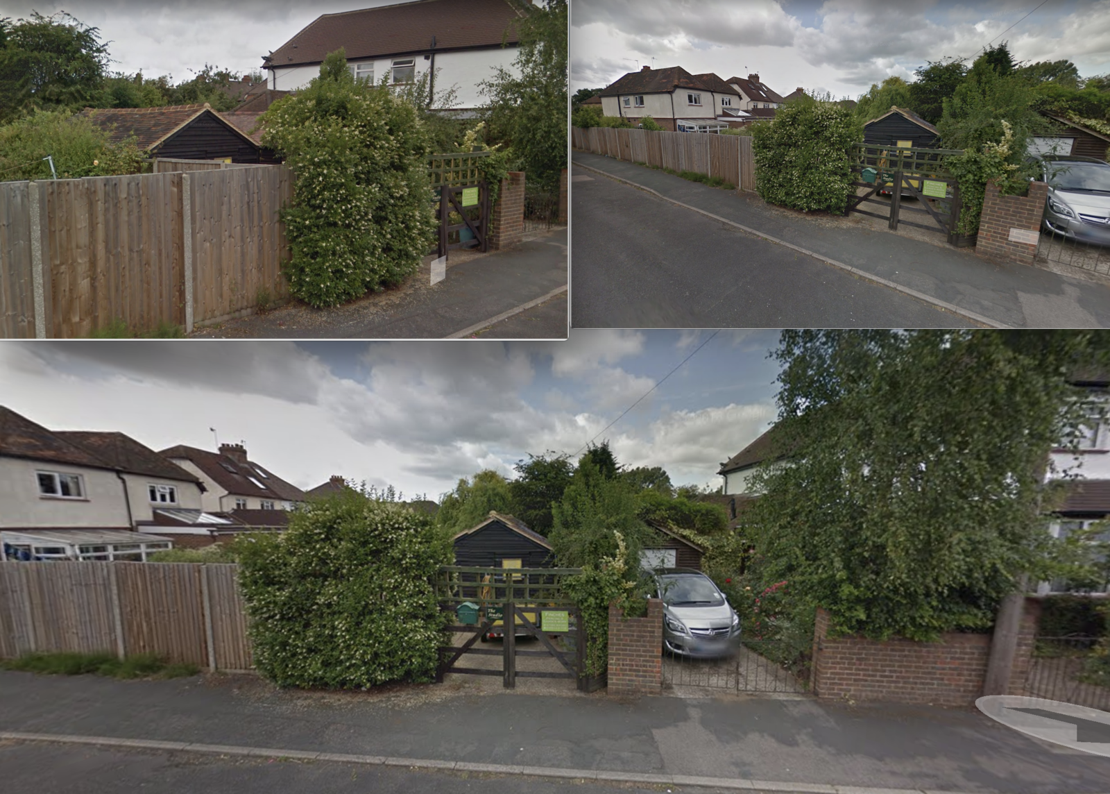

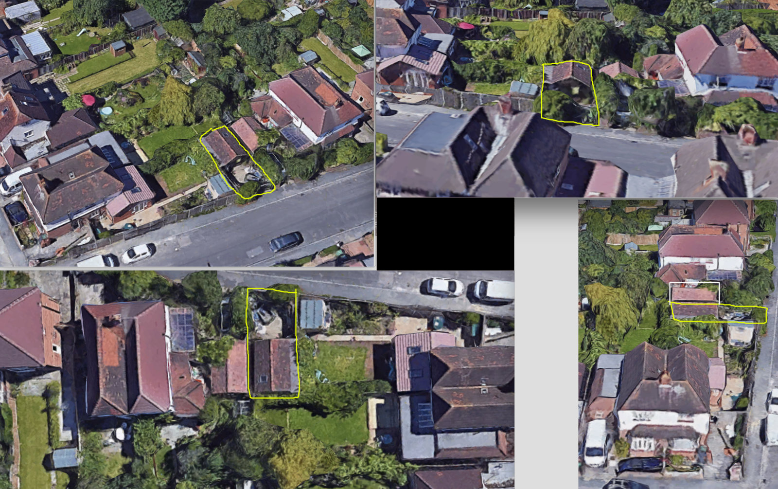

3. Assuming whatever house design I choose is fine.......What are the main reasons why Planning Permission may not be granted for this plot based on the pictures I have attached below. Is there anything you see that concerns you? In terms of loss of sunlight - I believe one neighbour would possibly be slightly affected, but this will probably, at worst, just affect their front garden in the winter......is this enough for PP to be refused? In terms of noise - the house will be small and simple, maybe even pre-built, so the building of the house will hopefully be quick. I will not put any overlooking windows on the upper sides of the house, and the upper rear of the building will probably have a large window, but have slats to avoid overlooking other properties. One thing that maybe concerns me is that the council may reject based on the size of the plot, which I have heard happen before. Any ideas if this could be an issue?

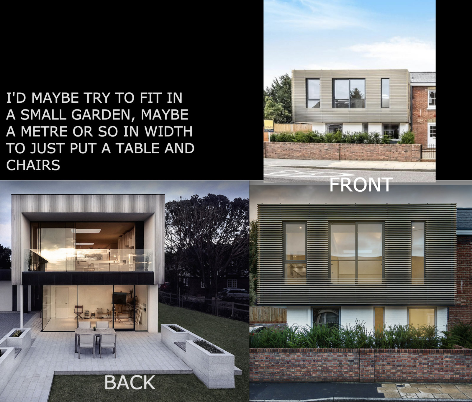

4. I have also attached some photos of the type of design I'd like to go for. I understand that you need to go for a design that is somewhat 'in-keeping' with surrounding properties, though I am not quite sure what this means as I have seen white, modern, cubed houses being built on Victorian streets. Any thoughts on why any of these designs would be rejected - please let me know.
Bottom right image above......I have drawn a white box showing how tall the house may be at max. Assumed minimal light impact on neighbours driveway.
These are just examples of designs I like. I like a modern-ish box design, with wooden cladding on the upper floor.
I would find your local plan guidance which will state what area a new dwelling must achieve, for example in Plymouth for a single one bed detached dwelling they'd expect 40m2 for the house + 100m2 for the garden etc. So that's about 1500ft2. I suspect this site is nothing like big enough. That's just one of the many issues and policies you would need to adhere to.

Where will the off street parking be? Where will the 10m or so of garden be? How are you going to prevent overlooking?
Don't get bogged down in minor things like a drain position. You need to research the council's new build housing strategy and in particular the policy for infilling back gardens.

What you are looking at on a plot like this is something the same shape as the garage but with a basement and a mezzanine sleeping area above the first floor. You can forget a two storey as the roofline would be too high in my opinion. Obviously you can forget any car access but that might be a positive in a built up area.
It is not impossible but would cost a lot to build on account of the basement. You would need some space for the roof to drain into. The width at 5.8m is clearly very tight.
I don't know about that drain though but assuming that is ok then it is not impossible you could create something there, even if it turned out to be a 'crashpad' rather than a 1 bed house.
