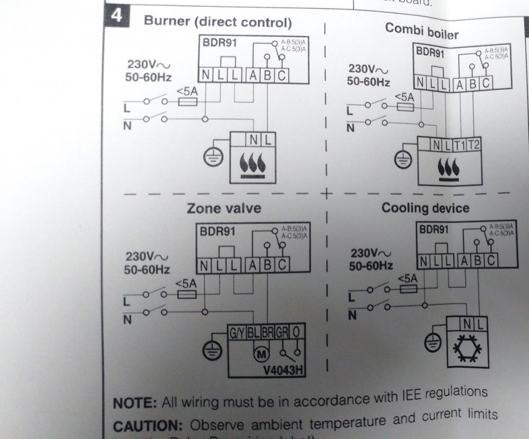

The two 'L' terminals in the BDR relay box are linked together internally, so are electrically connected anyway.
The first 'L' terminal is used to accept the Live supply and the second 'L' terminal is there to provide a Live to the switching contacts if your boiler has 230V switching. (There will be a link wire between one of the 'L' terminals and the 'A' terminal if this is the case) Otherwise the switching contacts can be left 'potential free' for boilers that use switching voltages other than 230V

thanks for your help does this help to guide me ?
Not really, I understand the BDR and your picture of the manual shows lots of different systems, but how do I know which one is applicable to yours? Unfortunately not all combi's are wired as shown in the drawing labelled 'Combi'. A photo of the existing wiring at the BDR would help a bit more.
