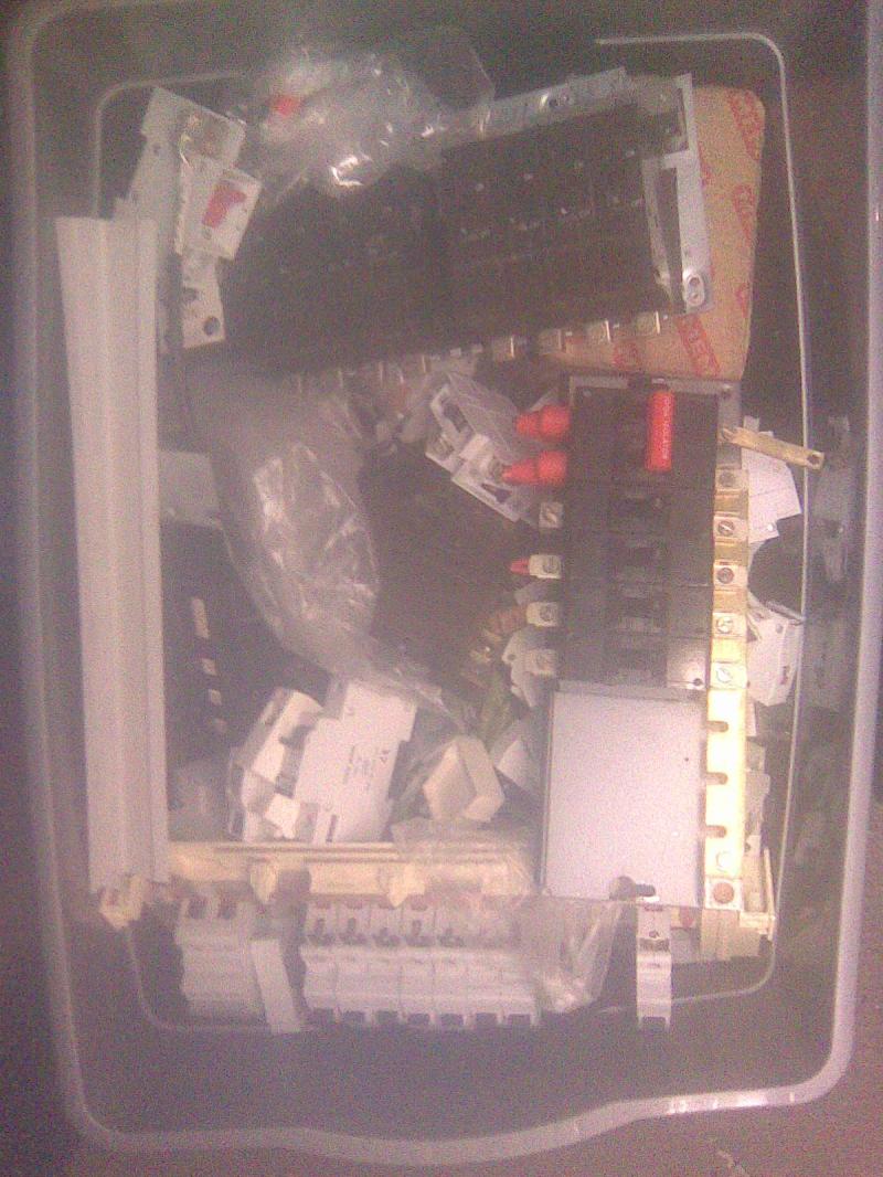

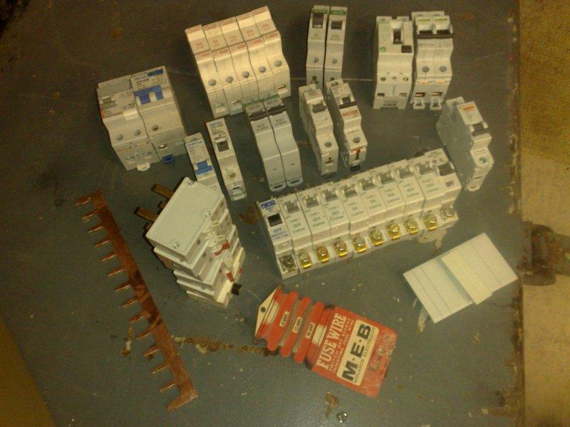

One of about 3 boxes... Worthless junk or potential gold?
I suppose you could replace some of those old mcb's on a like-for-like "emergency" fix. But then they'll be in my garage when I'm miles away and in desperate need cos it's 6pm and mrs so-an-so's 30 year old dorman-smith 100A isolater has a toasty tail.
I recon the box brownie camera you took the picture with is worth more hairyben.
I would say that any Dorman gear you have is worth a penny or two
The 17th edition has changed things a fair old bit on the domestic scene, so I doubt I'll be re-using any of my old breaker collection there.
I do intend to keep and possibly use my collection of Dorman Smith MCCB's (even if I do hate the things!) and my collection of Federal Stablok MCB's, oh yes, I've got some gold dust!
