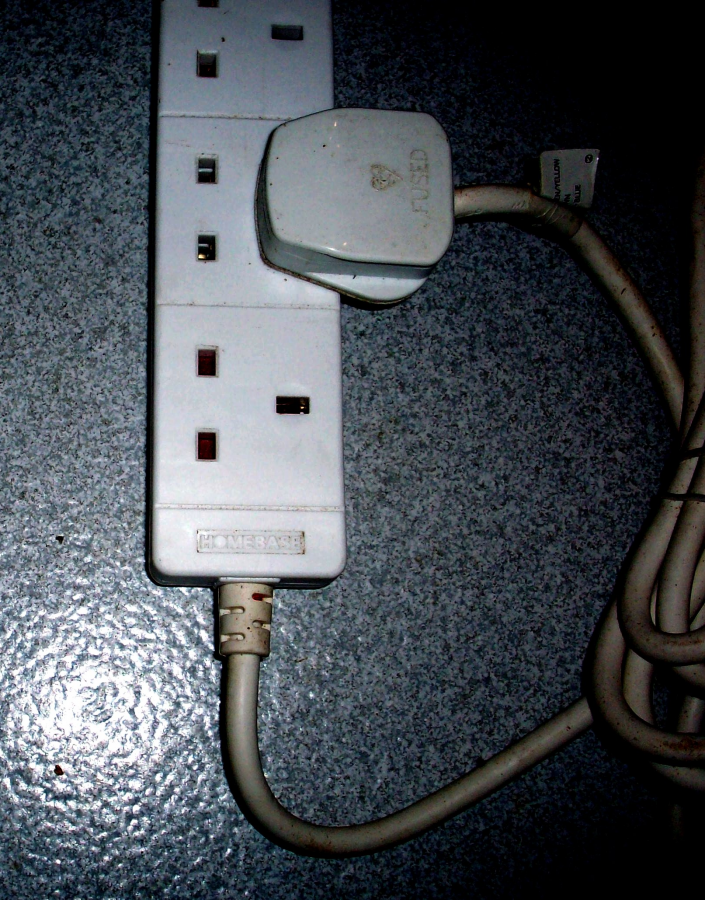

Anyone care to repeat this, guess my trailing socket and/or plug must be defective. Not that much force was applied. Socket has got PMS 9128 written on it, plug has PMS 9248 written on it if any help for identifying the brands.

This has been brought up before it seems there is no rule to require trailing sockets not to allow plug to be put in backwards. There has been a push to change this. The MK sockets need both live pins pushing in together rather than earth pin releasing. But fitted to a wall the earth pin stops them being used that way.
Do they not have to conform to BS 1363?

They certainly usually come with BS1363 markings.
There is a BS1363/A marking on it as expected, but a marking does not guarantee that it conforms to it.
Indeed not - but it supports/confirms our belief that it is required to comply with BS1363 (which it presumably doesn't).

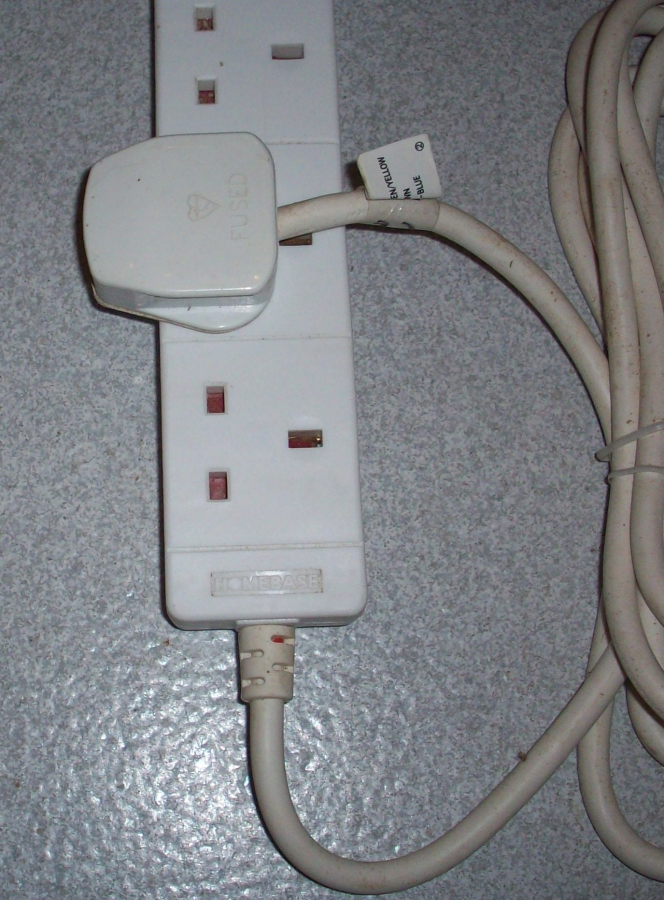

It doesn't appear to be only an old phenomenon. This is one (BS1363 marked) that 'er indoors bought from Homebase relatively recently (even though it's acquired a fair bit of 'cellar grime' since then!):

That's the other way round - video shows the L&N pins being inserted without the earth pin, resulting in the appliance being connected with reverse polarity (which almost certainly doesn't matter) and no earth connection at all.
Yes, I realise that. I should have made it clear that I was illustrating that the more common (and potentially more dangerous) issue is still around. With the Homebase one, in terms of 'fitting', I can do the same, but only after poking something into the earth pin hole to open the shutters:

And when they're just the integral switches in an appliance, far too much fuss is made about this possibility. Years ago many appliances which didn't need an earth and had S.P. switches were used with reversible 2-pin plugs. Many modern appliances in the U.K. are sold in the same basic form across Europe where they are still used with reversible plugs, so there's no way of guaranteeing which side of the supply a single-pole switch will end up in. In some places the appliance may even be used across two phases of a 127/220V system so whichever way it's connected it won't make any difference. It really doesn't matter anywhere near as much as some people have been led to believe.
Being able to plug in without the earth is of much more concern. A properly functioning shutter operated the traditional way from the earth slot would prevent the insertion demonstrated, unless somebody went to the trouble of opening the shutters from the earth with something else first. But you can't guard against everything!
