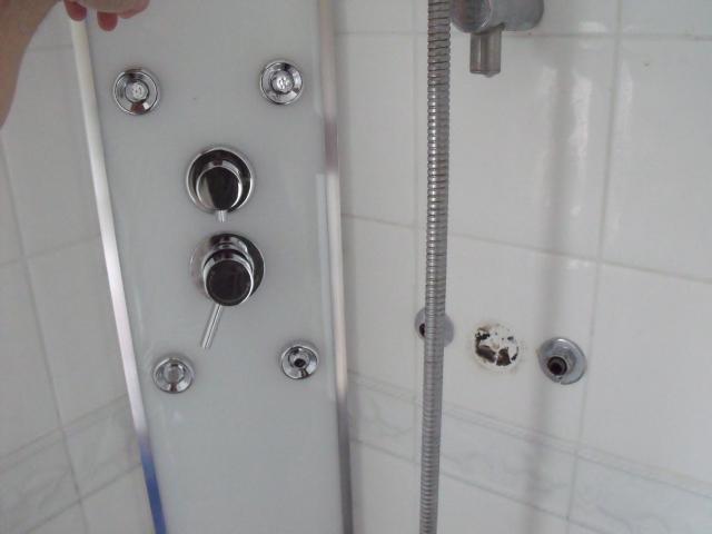

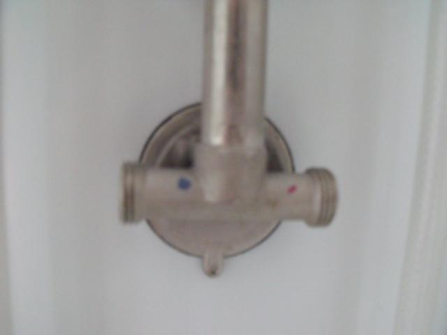

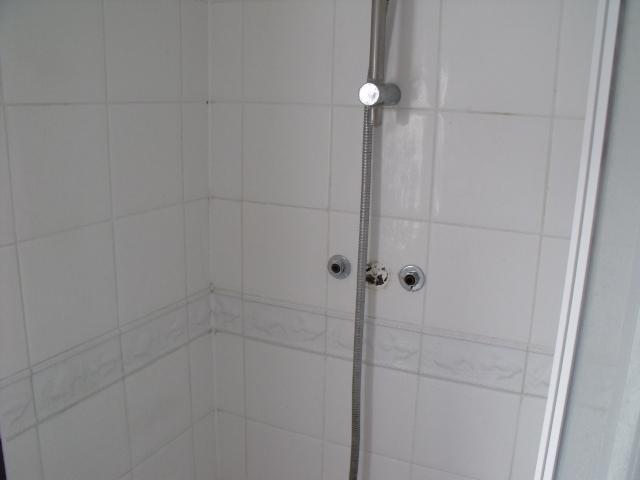

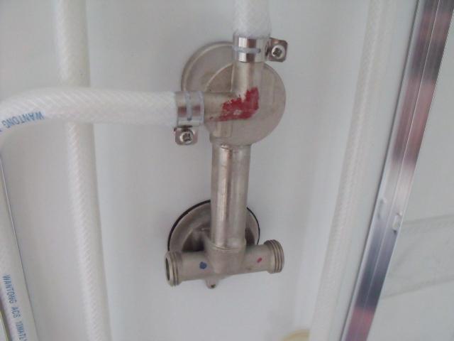

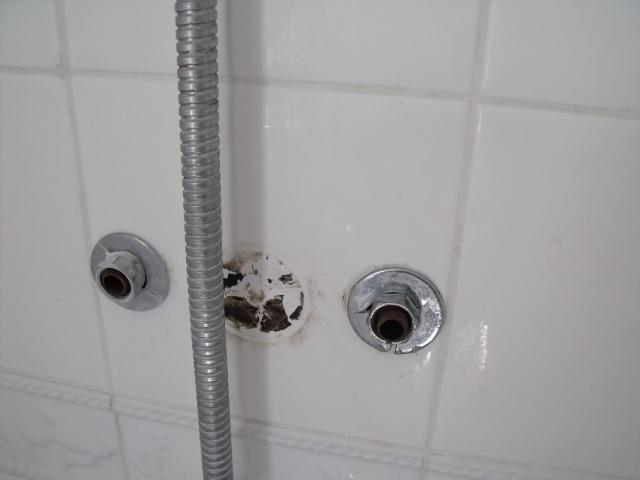

Thanks PrenticeBoyofDerry. I have photos now which I hope are visible and I read the situation wrongly before I took the mixer off. The H&C come out of the wall with an end nut on a 15mm pipe I believe (the house is only 14 years old so it has plastic plumbing with copper for the last stretch to the taps. The pictures show the H&C coming from the tiled wall, a wider shot of the existing shower tiled walls, the back of the mixer from the 'functional panel' of the new self contained shower cabin (2 photos) and I stood the functional panel in the existing shower enlcosure to show the front of the mixer and the distance I need to reach.
The new 'cabin' will stand an inch or so away from the tiled side wall to allow room for pipework. If could use flexible hoses this would be easiest I guess tho I'm not sure I can get the bend from the outlets to the far side of the mixer (which will be pointing away from the outlets) with the lengths I have seen available.
Which is the best way to plumb this please?

Looks like you going to need some elbows, as the flexible pipes might not be pliable enough to bend within the void.
I would install rigid pipe to corner, then flexies from there to cabin terminals.
If it's a self contained shower cubicle, why not just knock the tiles off and run the pipes to where they need to be?
Yeah, I'd do it permanent or you could be plagued with issues later with too many connections.
Pull off the 2 tiles from the corner to the current outlets, and run the pipe back to the rear of the cubicle. Or see where the pipes enter the wall at floor level and run new pipework to the corner and then up.
