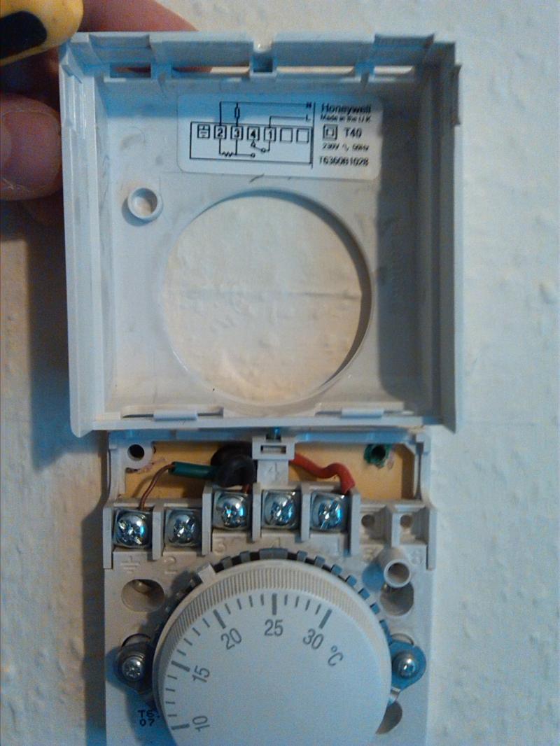

I moved into a house a year ago. We saw that the house had a new boiler (installed in 2009) when we bought the house.
The boiler that was fitted was a Worcester Greenstar Ri - and the installation manual is here: http://www.worcester-bosch.co.uk/ca...eenstar-ri--manufactured--aug-08---dec-10.pdf
This says (for _replacement_ boilers from 2008 to 2010) 'While the system is drained down, TRVs must be fitted to all rooms except the bathrooms and the room with the thermostat.'
However, no TRVs were fitted.
Also, when we looked at the Roomstat (a Honeywell T40), only terminals 1 & 3 were connected, meaning the anticipator isn't wired in, meaning the system calls for heat too early. Maybe it wasn't wired in with the replacement boiler, but I don't think the new system would have met Part L as a result of being wrongly wired.
So, my question is - can we get the installer to come back and fix these issues (either the lack of TRVs or the wrongly wired roomstat)?
Thanks!
Norm
