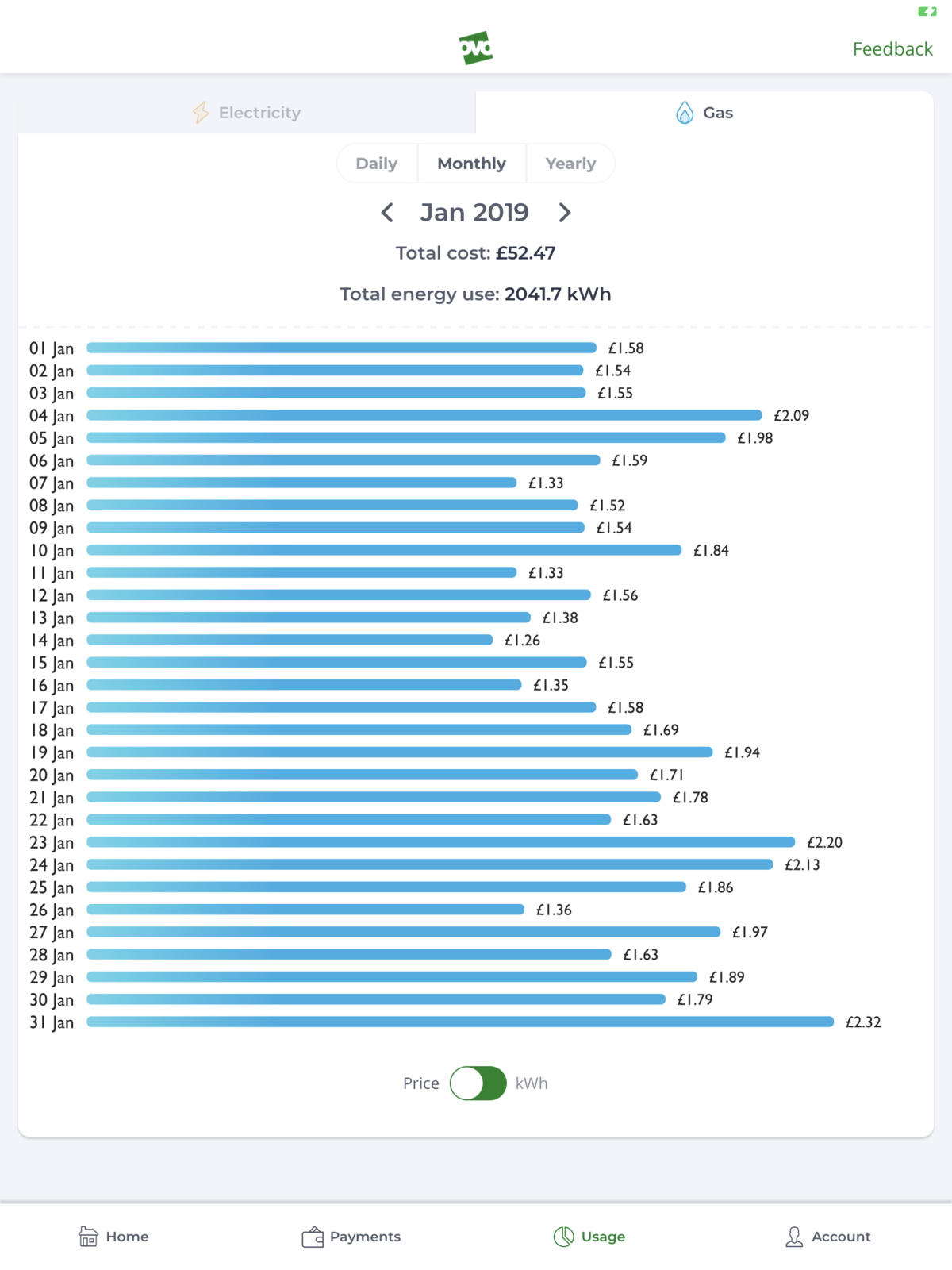

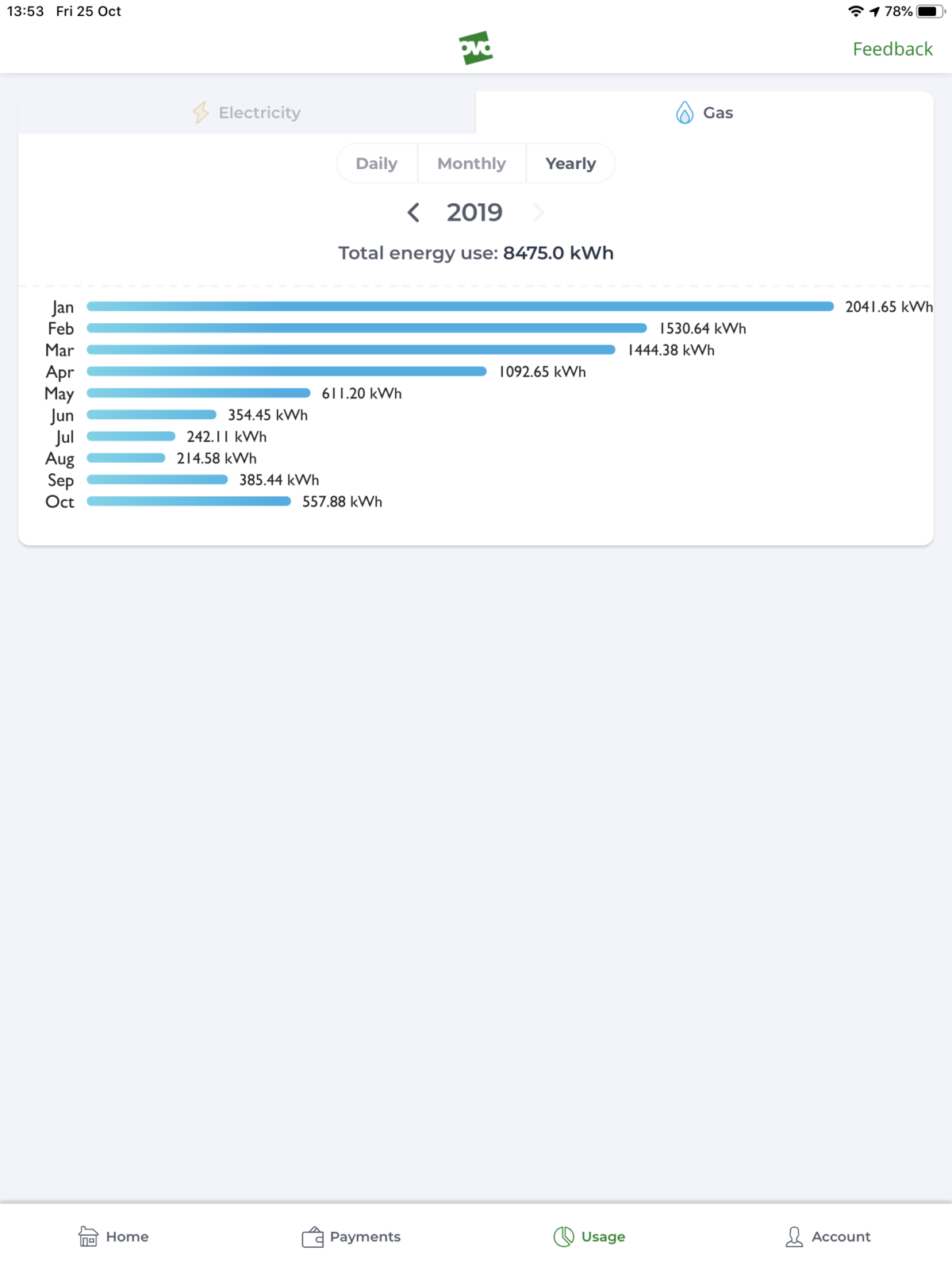

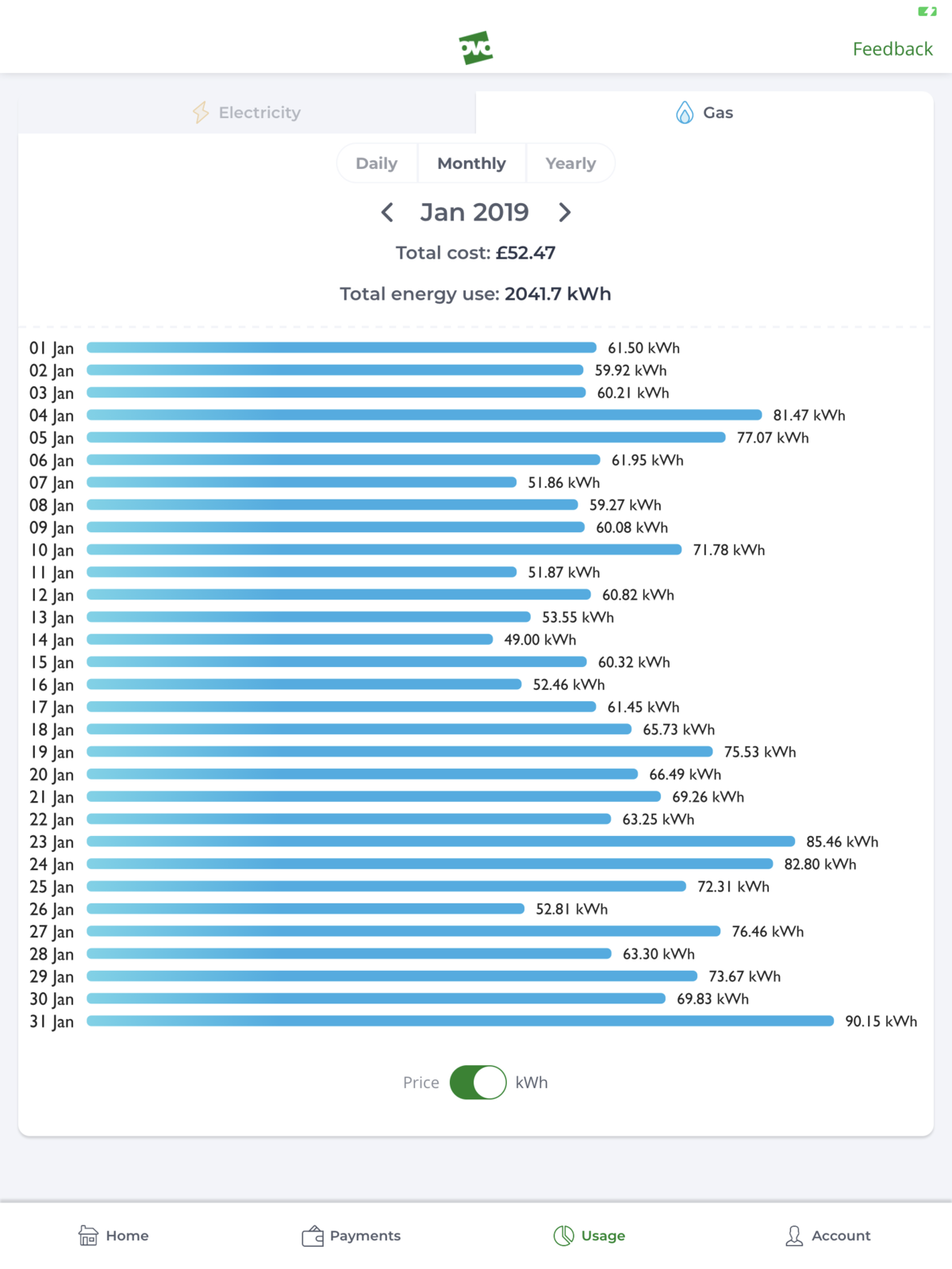

We have a 3 bed semi and an 18Kw boiler. We like it toasty warm but the installer set it to 15kw max as he says that’s more than enough. This is my gas consumption this year so far for heating and hot water - dunno whether that’s good or bad but on the coldest days it’s only around £2 a day.
Something not right with those figures. For instance my figure for January 2019 heating and HW is 138 Kwh. Yours is 2041.65Kwh I think you maybe meant 204.165 ? Mine is a 3bed semi, heated constantly, but at a variable temperature.
Well here’s January broken down in both £ and KWh.
Impossible.
With gas at say 4p per kWh, that means your gas bill for the whole of January was £6.
Whoops, yes caught out by the M3 versus the Kw - It should be x 3.600, so 496.8Kwh x 3.069p = £15.24
There is still something wild about MOTman's figures?
I don’t see how. We pay £100 per month on a standing order and currently we are £253 in credit but we have got the colder months coming!
You paid just £15 for gas heating and hot water for the whole of January? That’s just 50p per day. Were you away on holiday or did you sit covered in blankets and go to bed at 7.00 at night?
