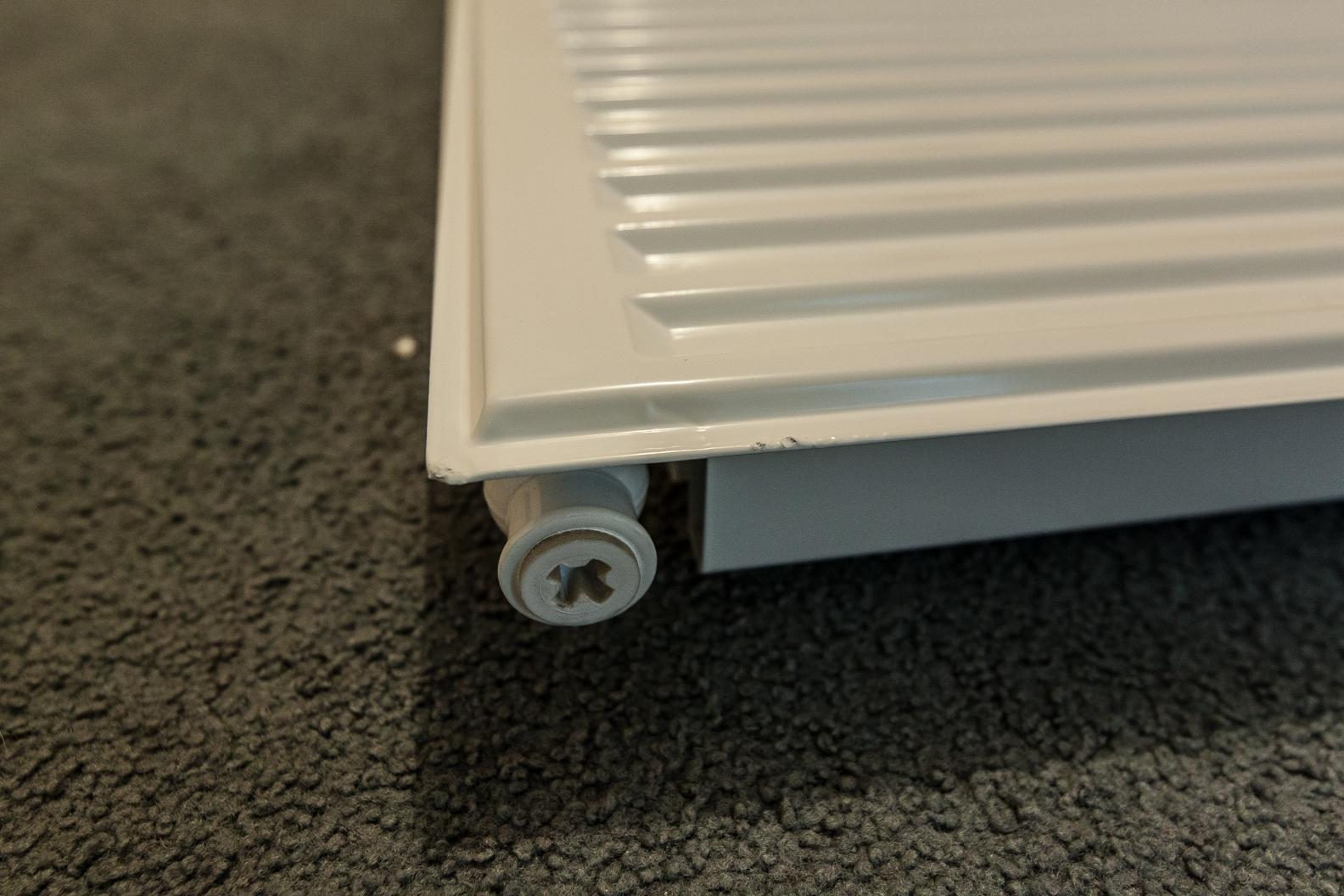

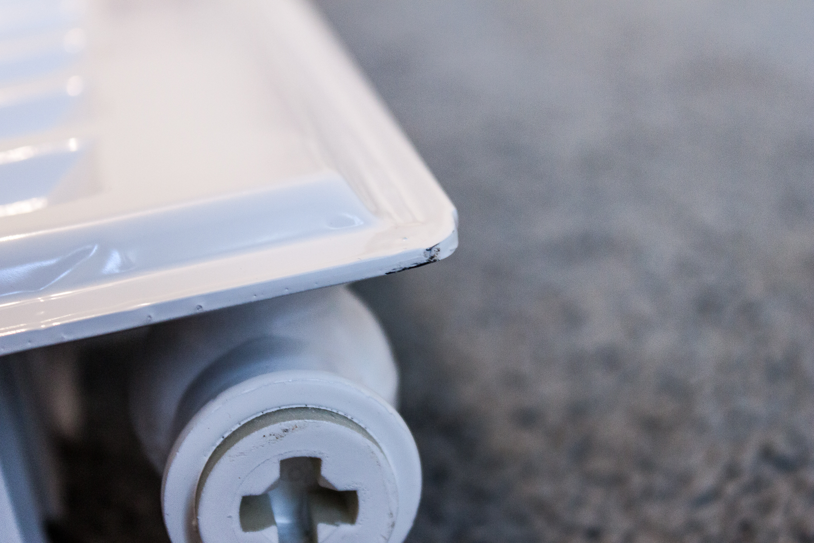

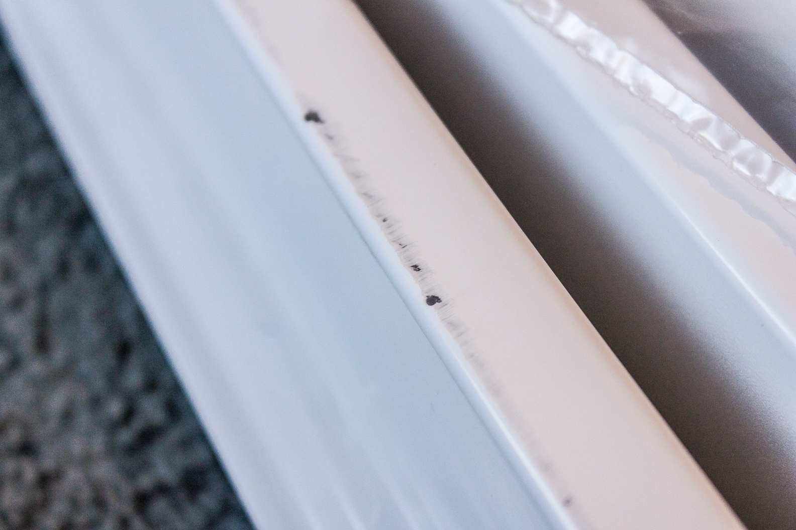

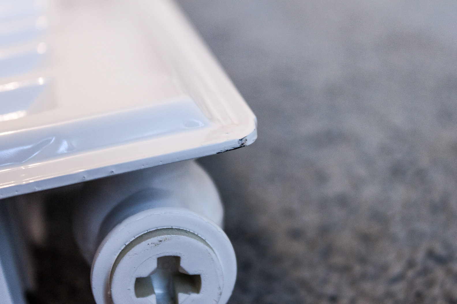

Just bought a single k1 Stelrad Elite 1800 x 600 seam top radiator.

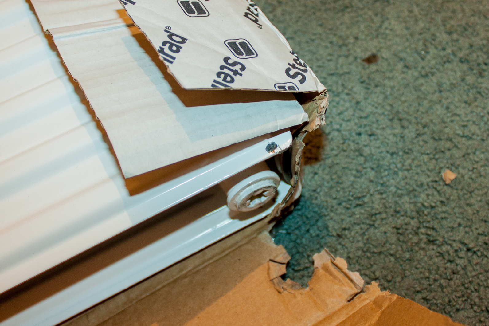

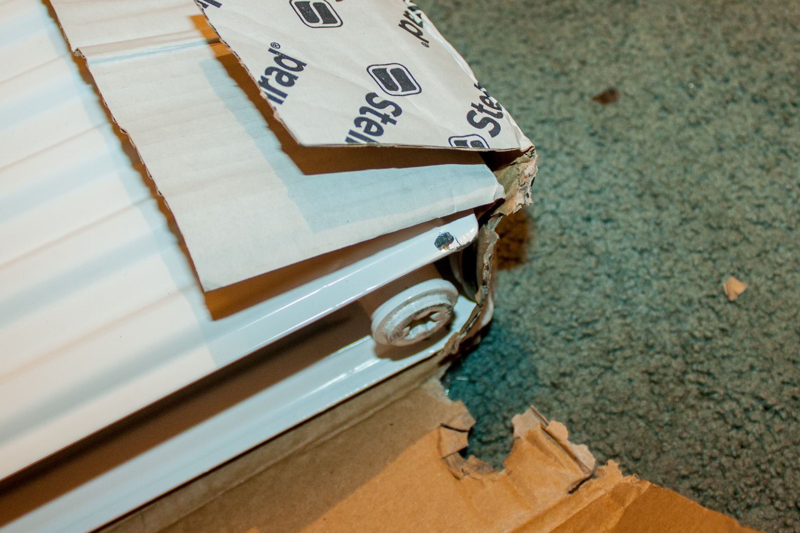

I am now on my second replacement due to the radiators being scuffed/scratched and marked and getting paint chipped during transit.

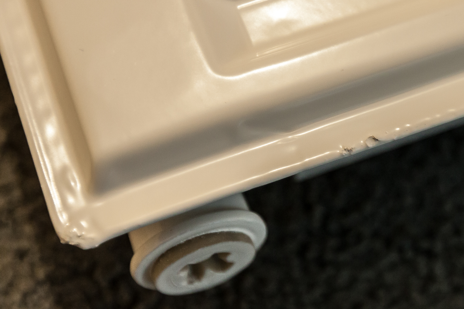

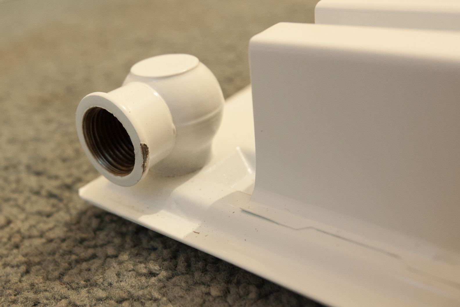

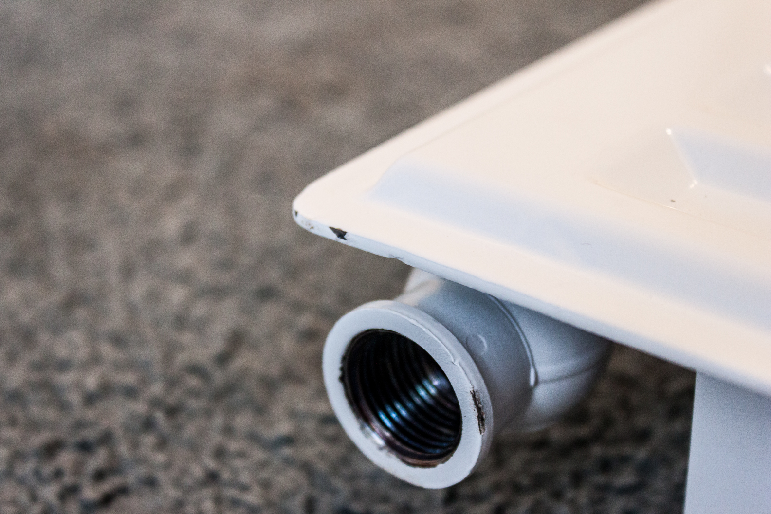

The first radiator (ordered a double originally) revealed this on the corner.....I was not pleased.

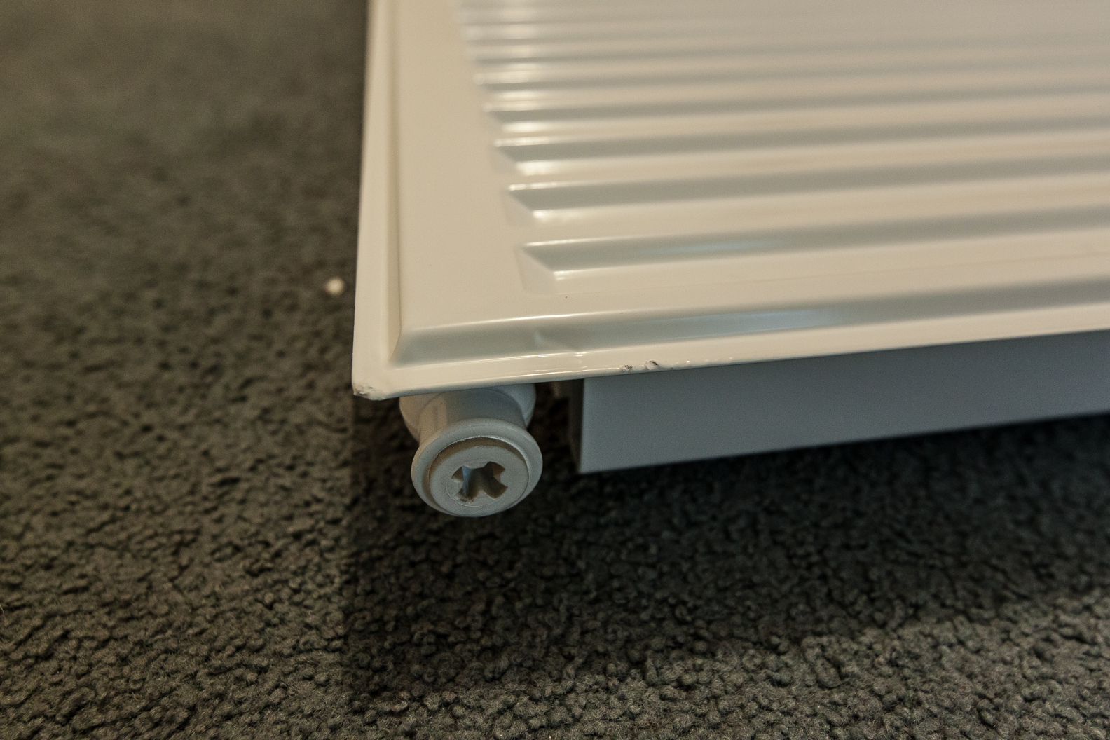

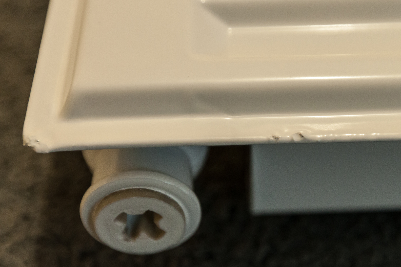

After this, I decided that a single radiator was more than enough and a replacement arrived with this....

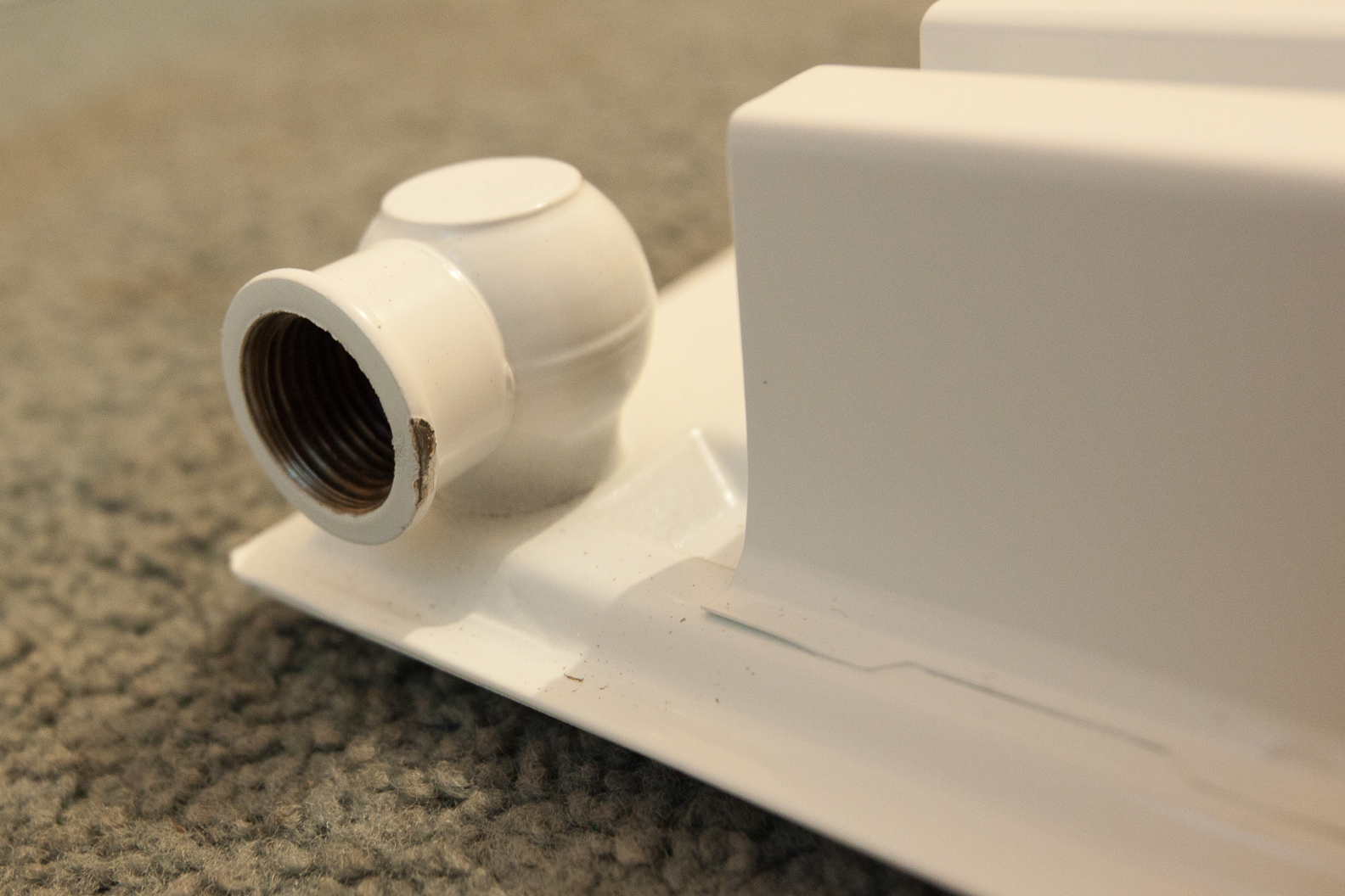

So another replacement was arranged.....

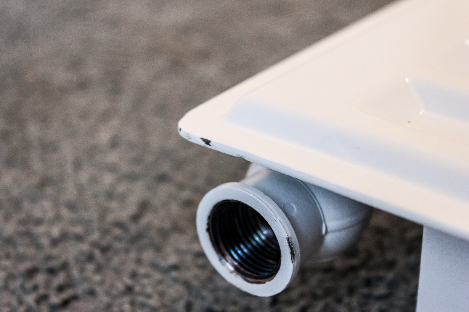

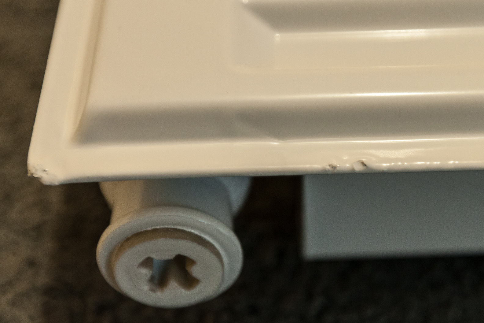

This one arrived in much better condition.....and at first I was hopeful....

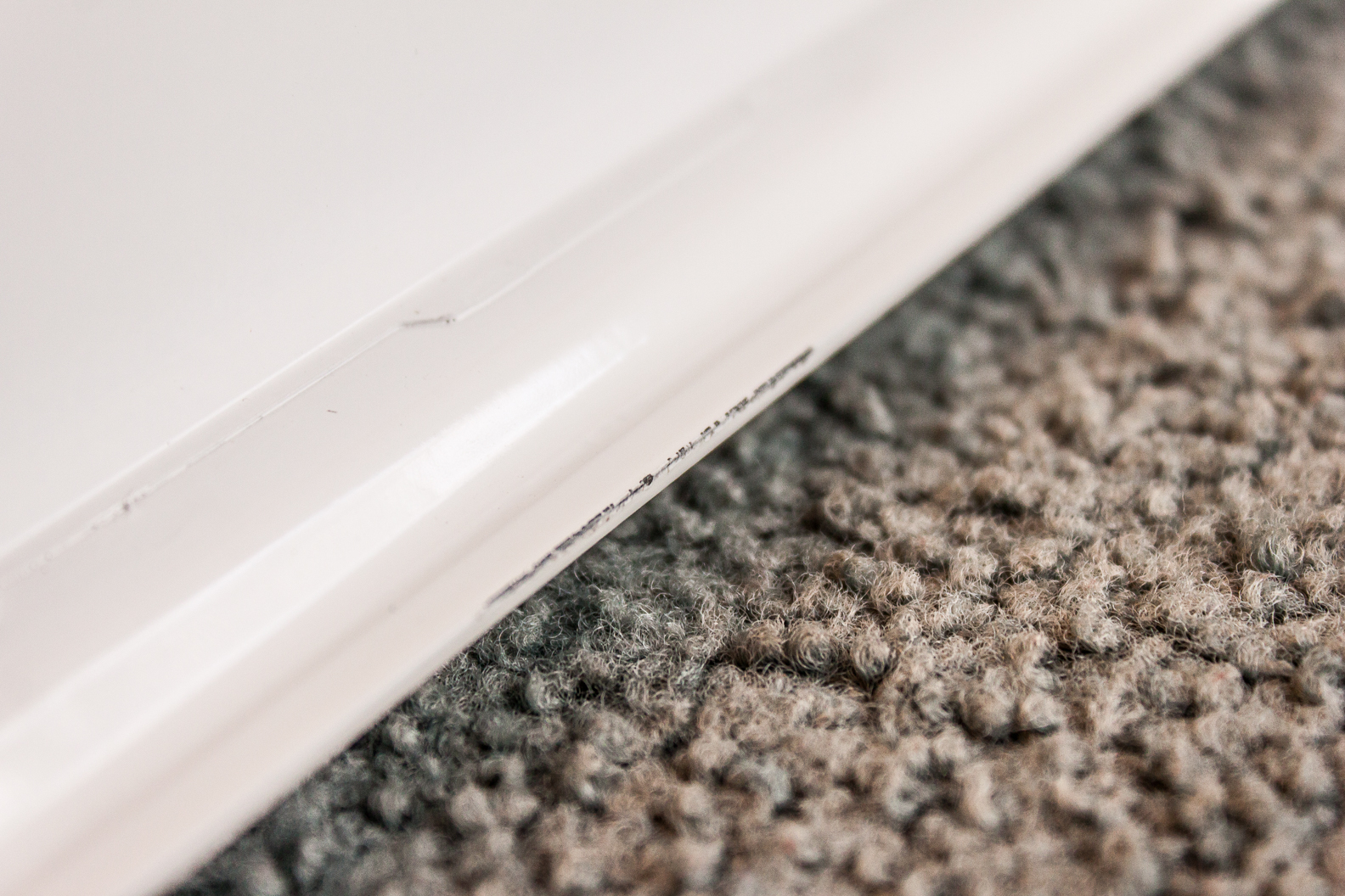

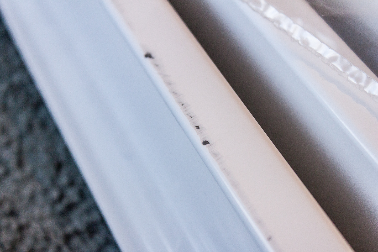

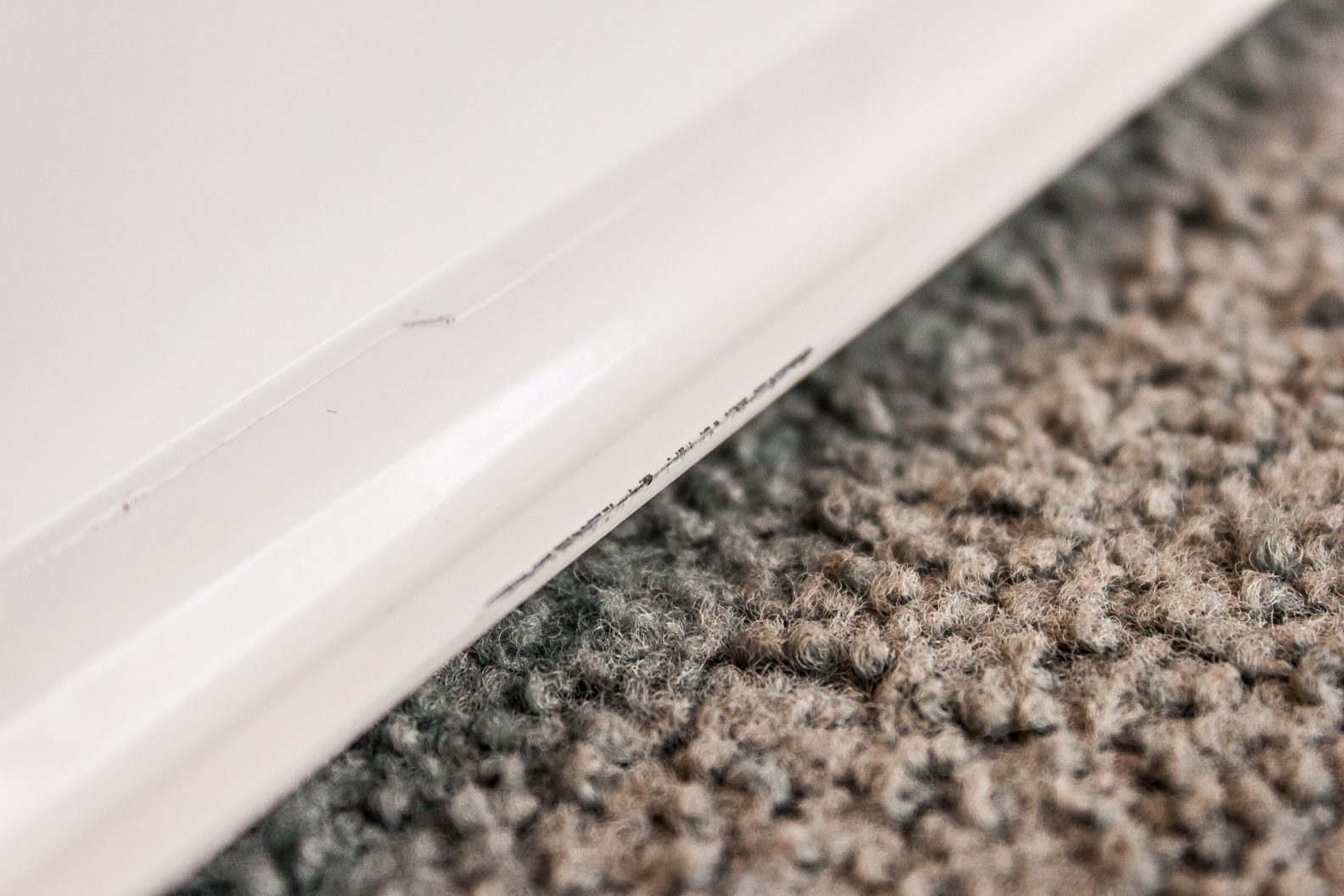

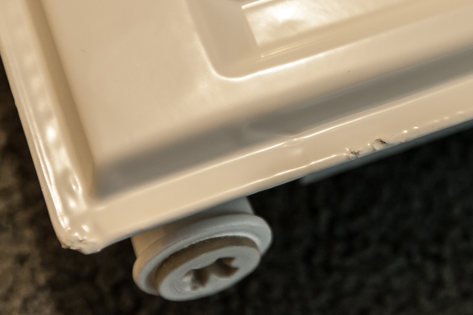

Until I saw this....which looks more like a manufacturing fault than transit damage.
The last image is just a slight scratch on the pipe connection port, and I would have been willing to overlook that. It is more the gouge on the seam edge which looks like it was done pre-paint finish. Even the paint finish on that edge is not very good, if you look closely you can see it has collected to make a bubble.
My question is.....would these issues have warranted a return for anyone who installs radiators on a regular basis? Call me old fashioned but when I buy something new, I expect no defects.

Part of the issue seems to be that Stelrad put hardly any padding on their rads. So the seam edges just slice through the cardboard. I can't imagine any other supplier being any better in transit.
The last one is certainly a manufacturing fault too.

I am certainly disappointed by their padding for transit, it is pretty much non-existent. One wonders at the waste in both material and profit this must incur. I ws told by the delivery guys that any returns just go straight in the scrap regardless. So that is a double 1800 x600, and two singles that have been binned for avoidable damage.

Some radiators are better protected for courier transit and manual handling from the van drivers (y). The clear photos show transit damage & other defects in pic's 6-7-8. The other defects are worrying.
As mentioned touch up paint is available (sometimes not that easy) maybe contact email plumbnation show them the photos. They may hint at giving you a discount or you could hint they are not worth the money you have spent on them. If the radiators leak water on initial installation The guarantee will still be valid. Its up to you to make your own decision.

The last set of images, I've only just noticed that the damage to the corner underneath the paint surface looks worse than I thought.
If you compare the corner profile of that in picture 8, to that in picture 3, it looks like the paint is hiding a decent bash, as it is almost non-existent in terms of it having a smooth radius.
