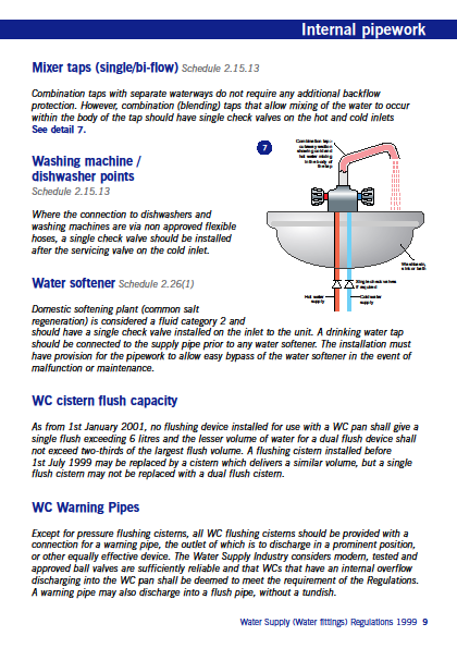

what backflow protection device should be fitted to mixer tap fed with from cold mains that permits mixing of hot and cold water in valve body
a.double check valve b.single check valve

soundness testing is normally carried out at 1.5 x normal working pressure 0.6 x 1.5 = 0.9 so why would 1.2 be the answer ?
single check valves are ok unless the airgap is not sufficient , so why double check valves ?
last one not sure.
You would find it difficult to find a tap with no airgap above the spill over level.
Not that difficult mate;)

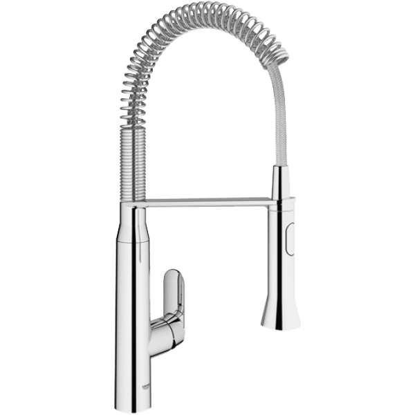

Thought we were talking about standard mixer taps? Those taps would need double check only because the head goes lower than the spill over level, a standard mixer tap even those that mix in the body only need single check valves ,
