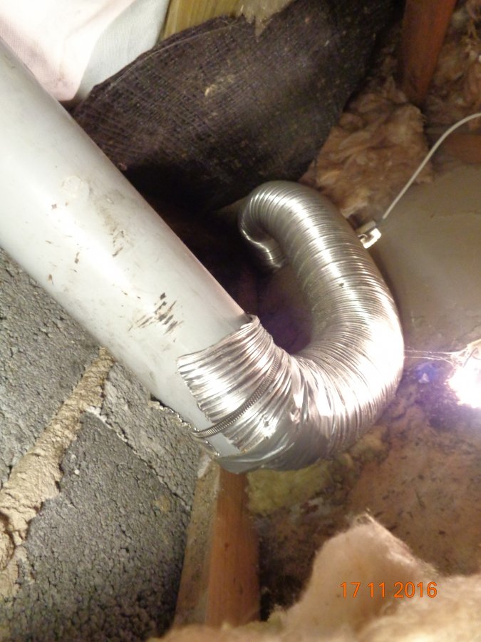

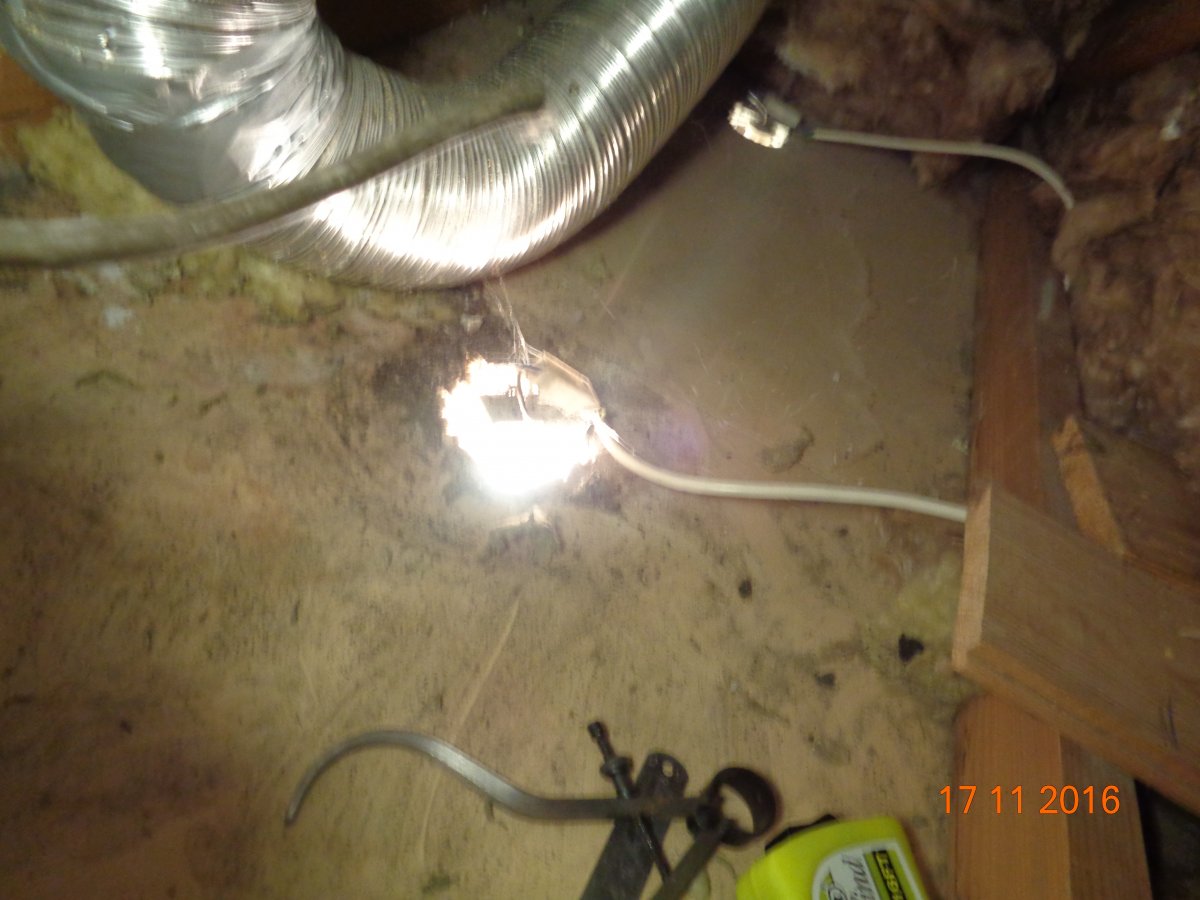

We had a flat to apex roof conversion over the dormer bedroom. The top of the open soil pipe was altered. Instead of going straight up, some flexi was put on it and then attached to a new piece of pipe, about a metre along from it, and the new piece of pipe goes through the roof. We've 3 times had a problem with water running down the outside of the pipe, along the corrugated tube and coming through the lights on the bathroom ceiling (yes very dangerous). Each time the pipe has been resealed on the roof. We think the wind may be catching the pipe and breaking the seal. We obviously need a permanent solution to the problem. Should I seek out a plumber or a roofer for the job?

I'll attach some photos, the pipe doesn't seem straight up, and it's whether we need a plumber to rectify the pipe work.

As Dilalio suggests, it could be coming down the inside of the pipe and escaping the flexi as it happens when it's raining and windy.
You are also getting condensation building up in the flexible pipe and holding water above the light fitting and acting as a gully due to the incorrect angle of the pipe work. It needs removing and replacing with soild pipework.

Get a plumber and have it done in rigid pipework and fittings! It is likely that warm/moist air rising up the vent is condensing inside when it enters the cold roof space and is running down to the inside to pool in the lowest point of the flexi.
As the guys have said, and what you seem to realise is that's quite a bad bodge and will never be right. You would be looking to get a plumber to replace the flexible pipe, he may also have the skills to add a lead slate for the pipe through the roof. Ideally though a recommended roofer to sort out the issues you have been left with on the roof exterior and the pipe, that way it should be done correctly.
