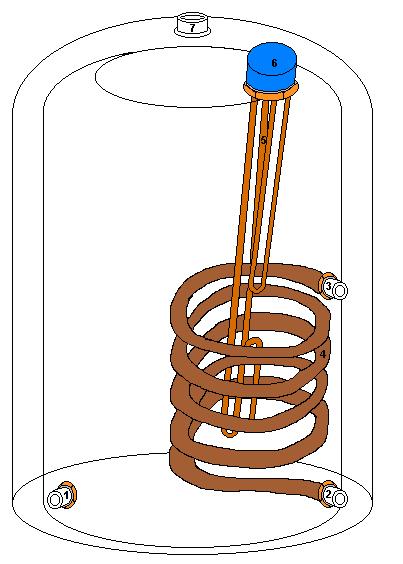

hi I have had a leak from my overplow pipe the plumber came and first replaced the ball cock in the overflow tank I dont have a combi boiler system . its the copper cylinder type . anyhow this did nt work and leak came back , it leaks when the water is not being used like overnight . then the plumber said it was a leak in the coil in the copper tank and I should have it replaced . so he came and replaced my hot water cylinder and I cannot believe it but the leak is still there as bad as ever what shall I do next not paid him anything as yet help

Just as a matter of interest how do you eliminate if it's the cylinder needs changing
You drain down the water in the system (not the contents of cylinder - the water that heats the rads and coil inside the cyl.) and disconnect the lower of the two coil primary pipes connected to the side of the cylinder. If the coil is holed, the water that is stored in the cyl will be forced through the hole and drip out of the connection on side of tank where the lower primary pipe has been disconnected from.
Not exactly a 10 min job, but the only way I know to prove the coil sound or not.
