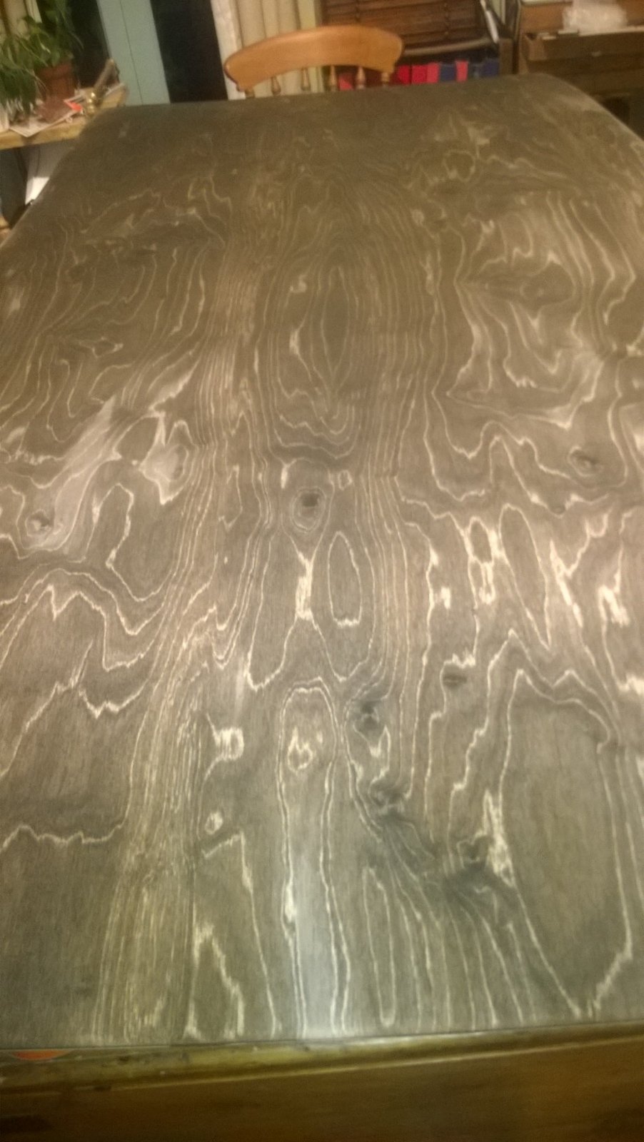

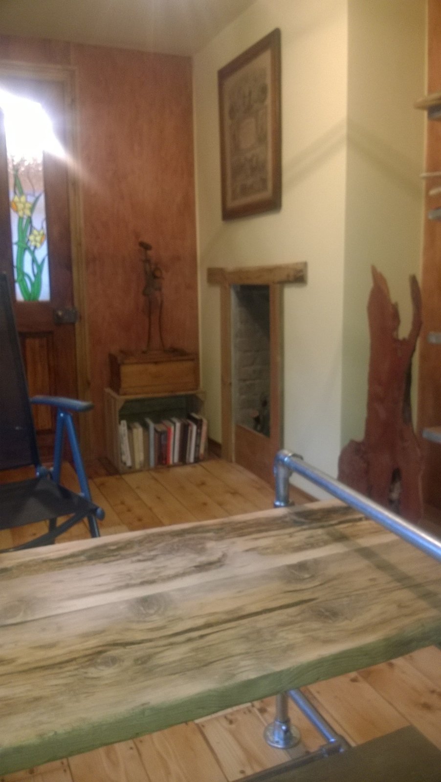

You can stain ply for get any finish you want I used a mahogany stain and wax on one room I paneled out and am used a grey stain and oil finish for a ceiling in another. I then coat the reverse with flame retardant.
No point in coating the reverse side, as it's already on fire before it gets through to that side; you'd need to see if the fire retardant spray could be applied after the coating you want. I can see where Motorbiking is coming from, but as everything else in the kitchen is wood, it shouldn't make a lot of difference.

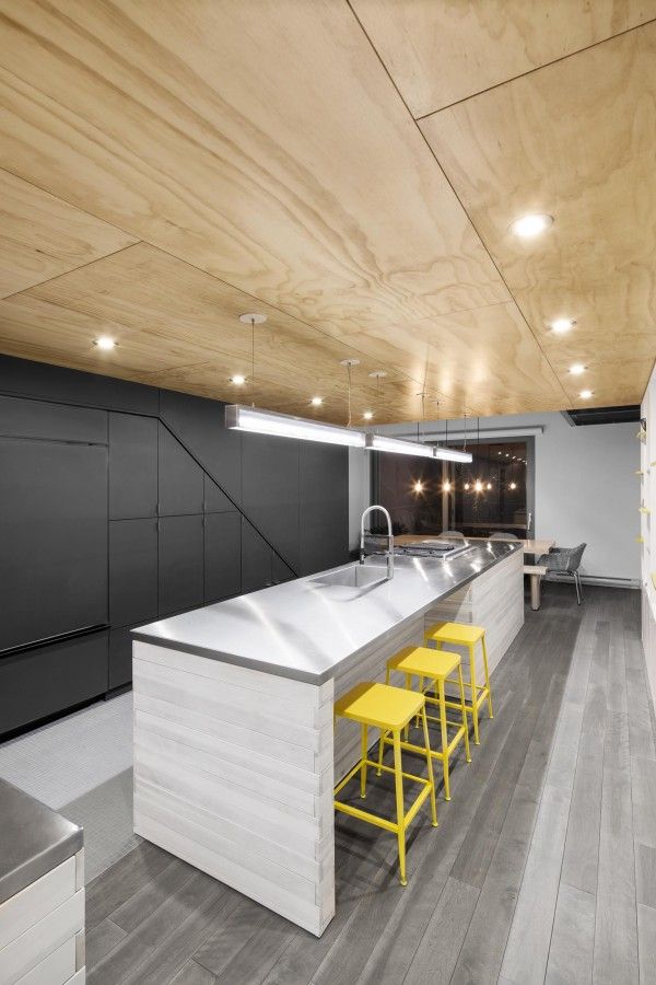

But I think the picture you posted of the kitchen showing a light colour might work better than a dark colour that will darken the room, and make the ceiling seem more closed in.

I'd consider £500 rather cheap to achieve anything remotely close to the photo magicmushroom posted even on your smaller area. Theres a lot of prep work involved and then the ply needs accurately machining on site once the ideal layout has been agreed upon. Then theres the cost of the materials and finish. You might want to talk to commercial shop fitters if you havent already, they may have more experience with this type of thing and might be prepared to do it on a weekend.
