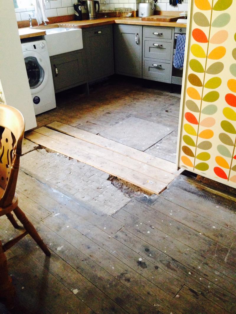

Here's a pic of the floor. As you can see the chimney 'hole' has been covered with some temporary floor boards for safety at the moment and in front of that is the old hearth base, which sits around 4mm lower than rest of the floor. On the other side of the temporary floor boards is a square of concrete which was a hard standing for the old cooker.
I'm thinking levelling compound to bring the hearth up to the same level then bang 18mm plywood over the lot followed by laminate. Any thoughts?

Seems a reasonable way to go. But be cautious that raising FFL's doesn't trap the appliances and units in the kitchen, and cause difficulties at door thresholds?
FWIW: I've seen Laminate laid over underlay on T&G boards without any ply and its also worked out fine.
Ideally, the floor should be perfectly level and flat with ply or similar but its not always possible so one does the best one can.
