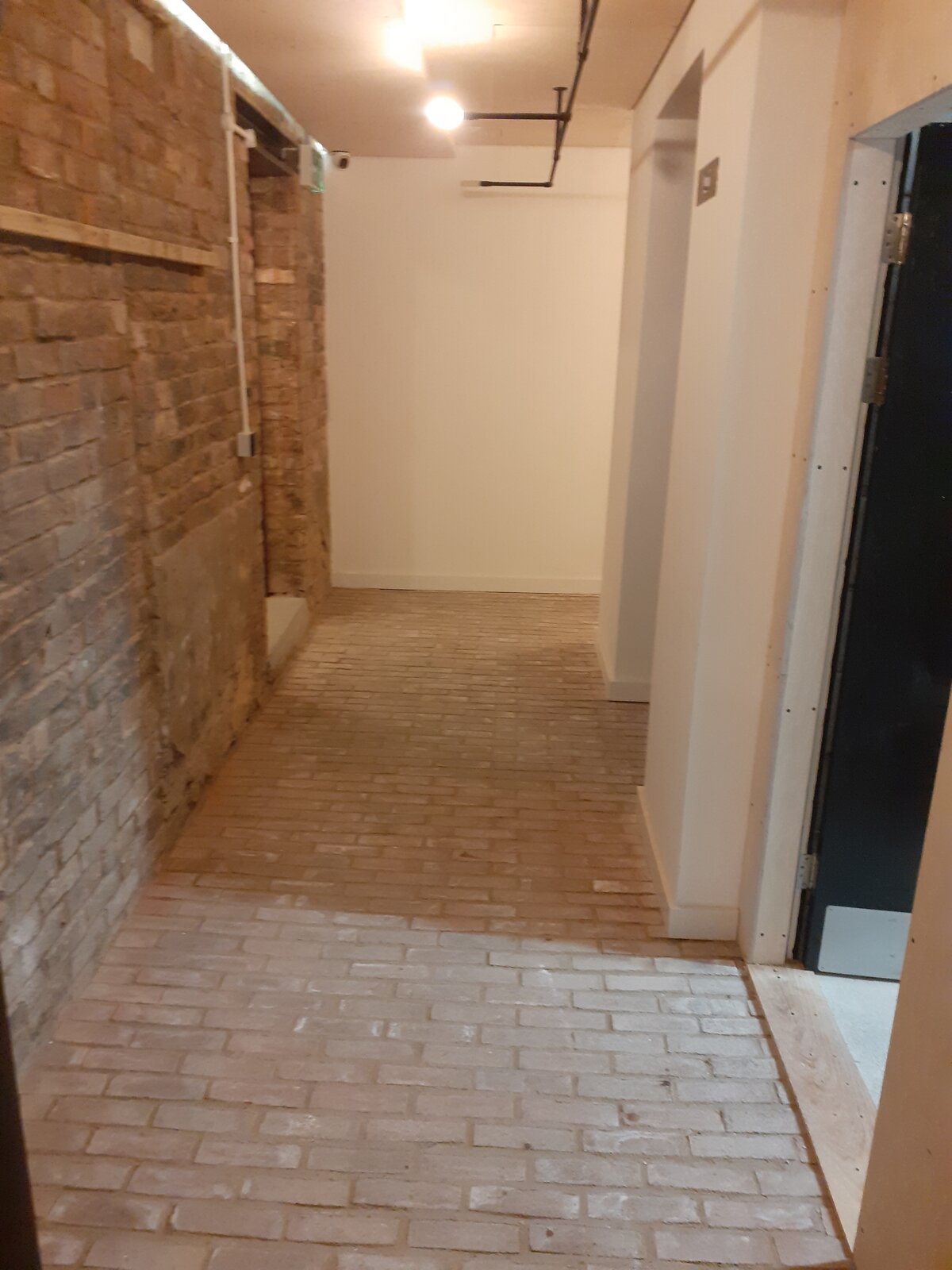

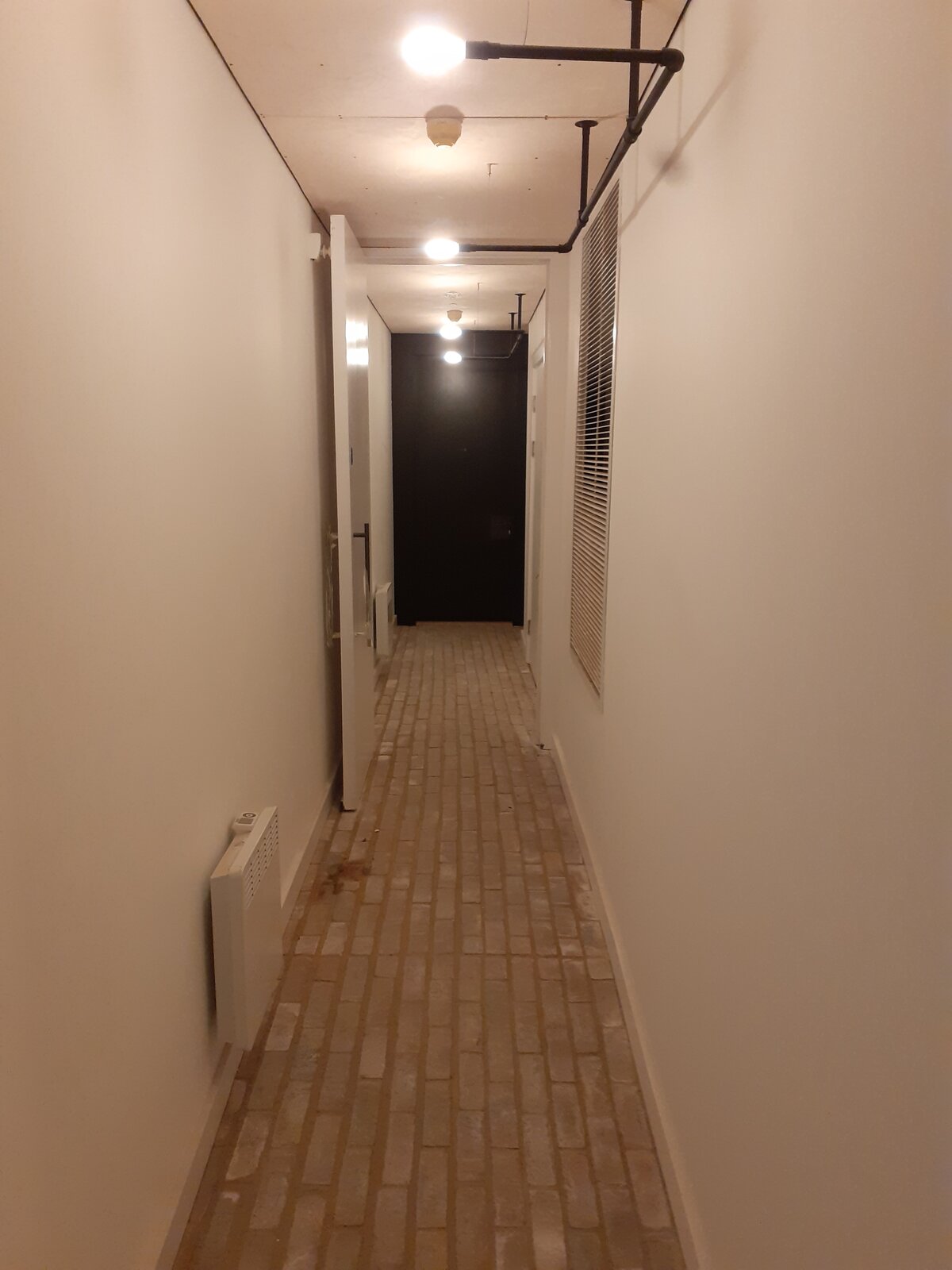

You mean something like this?
Those went in onto a fairly dry screed and once the screed had set the grouting was done with a fairly dry sand and Portland cement mix which only took a day or so to set in December last year. The resulting floor was sealed with a stone sealant after about a week (protected by plywood sheeting in the meantime). Note that this photo was taken before completion, hence unfilled/unpainted woodwork, etc

Thanks both. Bricks were laid a while ago onto concrete, so the substrate is dry and likely to remain so. Yes, like in the picture only herringbone. and my mix was completely dry. Hmm
