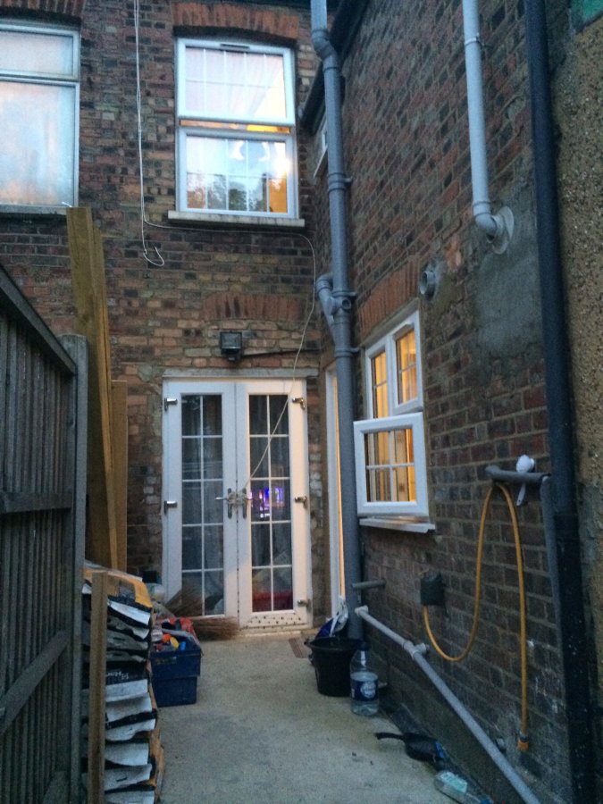

Is it just a yard/passage, or do you want it to be properly weathertight?

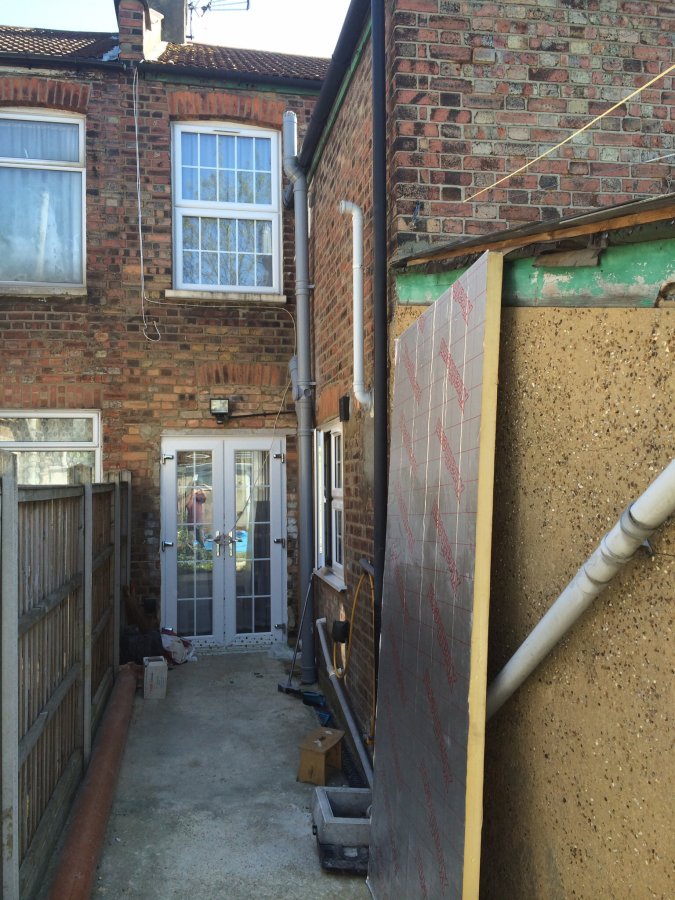

It's not a passage as it's a terraced property. I don't have a pic taken after the render was done but got an old one which will hopefully give you an idea of what the place looks like
This is the area that I'd like roofed.
I want to have the area upto the single storey roofed and yes would want it fully weatherproofed as I wish to do my DIYing there as it gets too dusty inside.

The black vent on the kitchen wall, is that just steam/air etc? Looks a ballache having to cut the poly around all those pipes. My advice? Pay £1350 and have a professional do it, we would be more but then again we would do you a swanky hip type segmented thing...
Yes you can do it yourself you'll have to slope it to neighbours, it wo'nt work to garden.
First thing you need to do is bang 3 4x4" upright posts in with a wall plate along the 3 posts, something like 2 lots of 4x2 sandwiched together and have the finished height of the wall plate more or less the same height as the french doors. Don't forget to step it in a little so when the gutter is attached to the wallplate its level with the fence.
You might want to get your fascias and gutter done first, will be a git to do once the roof is there. It's not a lot to do meterage wise
Mw really appreciate your input on this, that pic is about 6 months old and have since had solid wall insulation and new gutters and fascias
I was thinking of doing is having the roof start above the bend that goes to the toilet and then slope down slightly as I wanted the light inside / under the sheets, that way it'd be one less pipe to cut around and I'd have alot room height to work with
How would you suggest covering up the exposed sides if I did go that high, jsut thinking it'd probably be easier moving the light rather than going up that high with ladders etc even still, would you use the same method of fixing the poly down on the vertical sides too?

You might not need to move the light. If you draw a line from top of toilet bend to the left of door it just about misses it.
That is a very good point actually, didn't think of that but thing is it is an old pic & i've got a funny feeling it's sitting up higher now - I really do need to get an update to date pic but it's always to dark when I get home (Still at work as i type this!)
