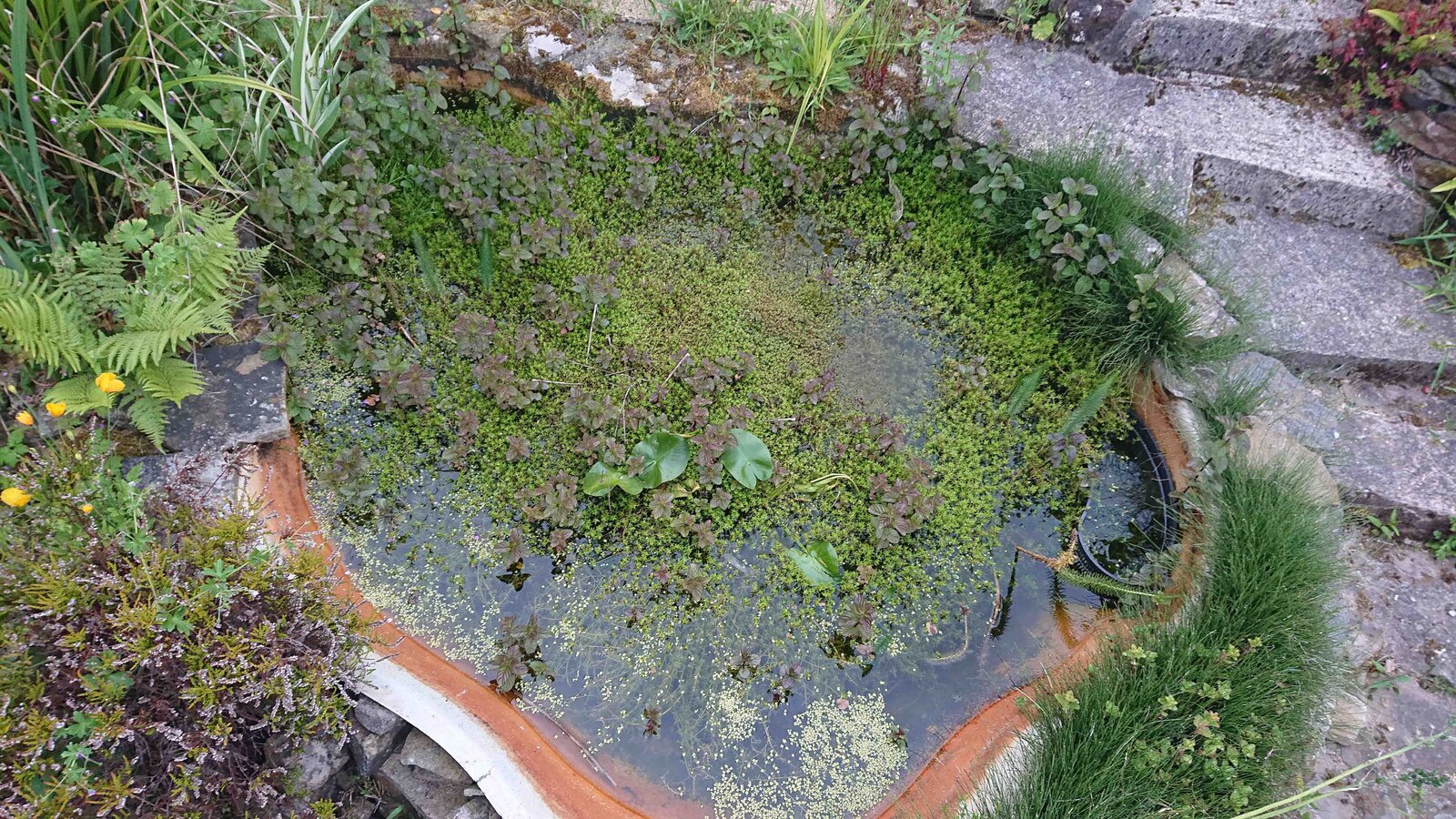

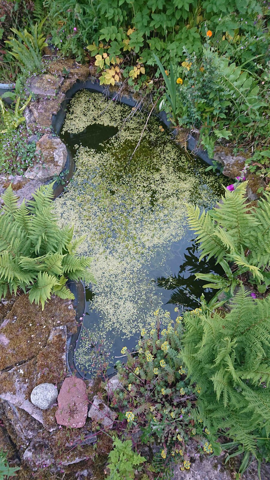

There's 3 ponds. V overgrown I know. Largest one is approx 2.5m x 1.8m but as you might be able to make out, they're all set into the ground on one side but with a built up wall on the other (it's a multi-level garden). And they're strange shapes.
I'd rather avoid a fence because of the multi level reqs round the perimeter, because having a mesh over the top is just peace of mind (if little un is anything like I was the fence would become climbing challenge #1), and also cos mesh provides better protection from herons - bonus!
