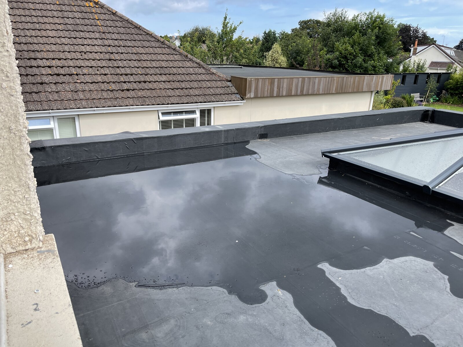

Currently in the process of having an extension built and the EPDM warm roof has just been done. First downpour and it’s pooling in the corner nearest the house, is this acceptable and will it cause problems? May also be where a join is.

If that was me, I'd have out in 3 outlets. One on each end and one in the centre. This would have eliminated this. Nothing can be done now. If the EPDM is on properly then it won't leak however they should have atleast sloped the timber in the direction of the outlet.

The falls are done wrong.
they’ve done the firrings so the fall runs parallel to the house wall, towards the outlet, however they’ve kept the roof flat perpendicular to the house wall.
setting out firrings on a roof with a lantern takes some head scratching as there are multiple directions needed to ensure falls run away from all corners.
they should’ve had a firring “valley” running from the outlet towards the house where the picture was taken. And then set out firrings down to that.
another outlet may solve, it depends whether the groundwork’s / landscaping is done yet.
More outlets are more risk.
Were they registered installers? Firestone or suchlike? If so, get the rep out to confirm that it's in accordance with their guidance (it does not appear to be)

I don't think it's firestone. There outlets are finished different unless these installers haven't fitted them correctly.
Thanks for the comments. They are firestone registered I believe.

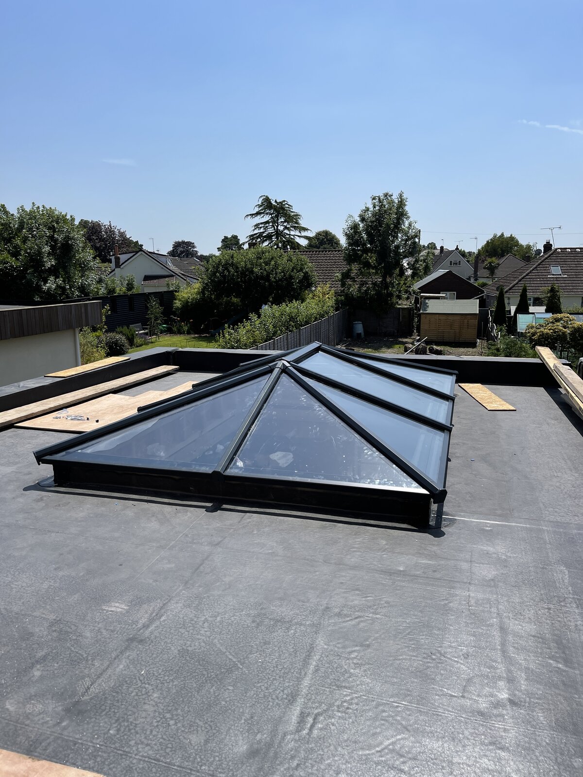

The firrings all run in one direction away from the house to two outlets in each corner. The firrings nearest the house they “created the firrings themselves” which is why it’s pooling in that corner I believe. As I reckon they have made them lower than the firrings they are joining onto.
