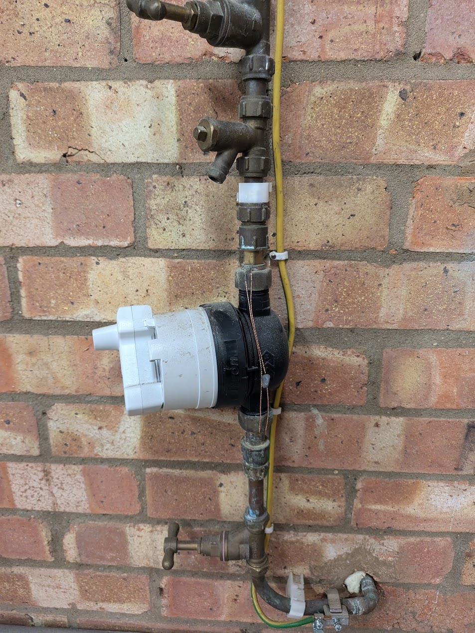

Im in the middle of a bathroom renovation. We have fairly low pressure in our system, with 15mm pipe work. We get just under 10l per min at the kitchen tap on cold. To be fair to our combi (40kw Worcester Bosch), it delivers the same 10l per minute in hot water (just a tad less).
So while working on the soil stack I've noticed our incoming main is actually 22mm (possibly bigger, I cant get the callipers in there). It immediately goes down to 15mm and through the wall to a meter (was moved recently). I could upgrade the pipework to 22mm, it looks like the meter will take the 22mm pipes and run that all the way to the bathroom above and make sure the feed to the boiler gets 22mm up to where it branches off to the boiler. My thinking being that I'm increasing flow up to the points where it splits off to other feeds and to the boiler.
Question : is it worth doing this, and will it actually make any difference.

I haven't got anything to test the pressure. But the kitchen tap is the first thing after the meter (granted it goes through a few elbows and 2x stop cocks). I get 10l per min there. I could test at the drain down point I guess.
Upping 15mm - 22mm won't help.
If your only getting 10L on the incoming then that's all you will get.
Check to see if there are any restrictions. Check all inline valves are fully open.

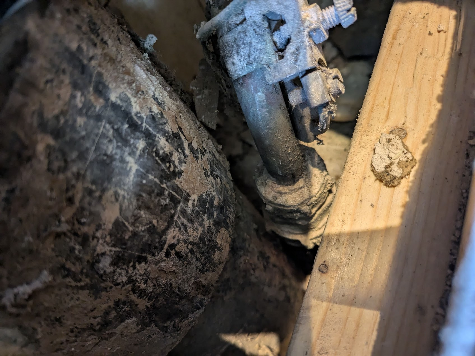

Hi, The only place i can test, the pipework has already gone down to 15mm and through many elbows and the meter. The incoming is Black Alkathene pipework with an OD of 26.9mm (just re-measured). So its old imperial stuff 3/4 Alkathene. Not copper. It immediately goes into 15mm through a brass coupling (see above pic). Then it goes through about 6 x 90 degree elbows to get to and from the meter the other side of the wall and also 2 stopcocks.
I cant test the flow at the incoming as i only have about 2 inches of the pipe coming out of the floor before it goes down to 15mm.
It seems to me while i have cut a hole in the boxing to do other work, i should upgrade it. I've asked Severn Trent to move the meter to the boundary so i can eliminate all the elbows.

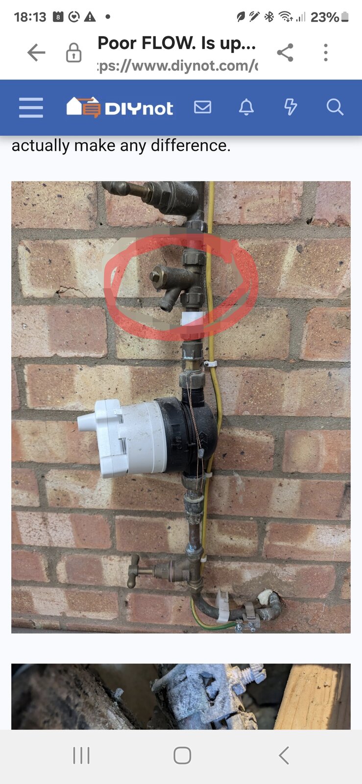

Could you test here?
Is this an outside wall?
Could you test here?View attachment 348374
Hi yeah I could test but it's already reduced to 15mm there, albeit only about 1 meter from the incoming main. No it's the inside of the garage wall, just the other side of the incoming. It was all moved during our kitchen refurbishment so they could box in. Didn't have time to get it moved to the boundary. Not ideal as there are lots of 90s to achieve it. Will give it a go tomorrow
No point going from 20mm - 22mm.
It would loose pressure. In fact the internal of the 20mm black polly is more than likely 18mm.
I'd be looking more at the bends and other restrictions.
Other than that you could put a booster set in. You seem to have the room.
Ok. Tested at the drain down point and I'm getting about 15lpm there. So something is happening after that and before the kitchen tap it seems. Regardless in me interested in views on what fitting I need to go from the incoming main 26.9mm pipe to a 22mm copper. Now I'm in there I'm inclined to upgrade it
