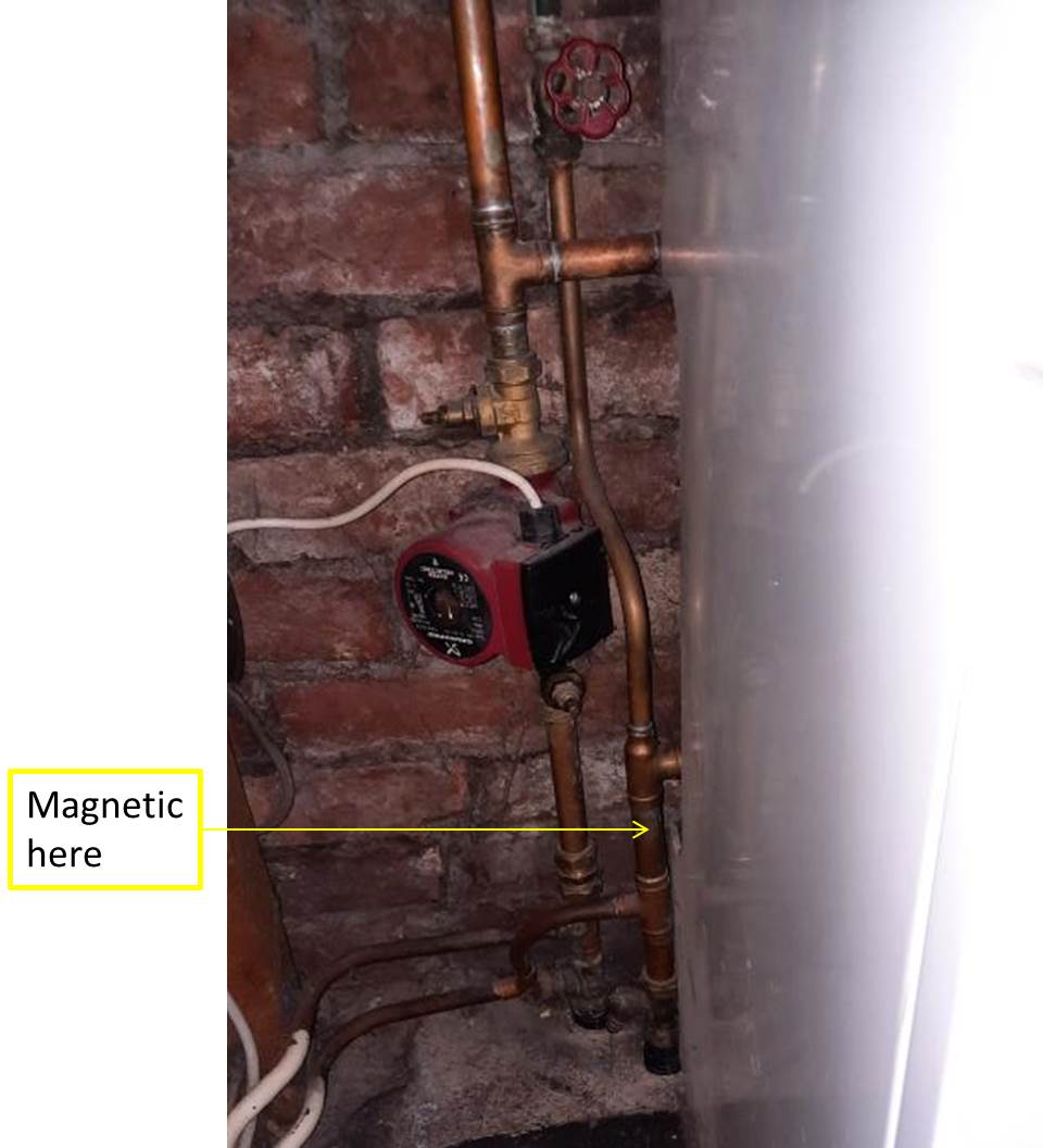

my really old large house used to be a real mess in terms of several old heating systems that were cobbled together and extensions to it.
Not to mentions redundant pipework from Back boilers and a Rayburn/Aga style device in the kitchen.
Now - I have the original gravity fed Potterton Kingfisher2 floorstander - and Im happy with this .
22mm flow/return from the boiler to the rest of the system - all new , but a lot of long runs.
Downstairs - I have 22mm feeding 3 radiators off the flow / return.
Upstairs , I now have a new 22mm single run of flow/return with no spurs , just feeds to upstairs radiators and drops to the remaining downstairs radiators.
Total number of radiators is 18 !!!
The system is pumped by a Grundfos UPS 15-60 130 pump.
The only 15mm copper is is from the flow/return to the radiators.
Now I have bought a thermo gun ( Bosch ) to measure the temps of each radiator in order to balance them , but my problem is what seems to be a lack of flow.
At no point does the drop in temp across the flow and return pipes mirror what is acceptable , therefore I am suspecting poor flow.
In fact the return is pretty close to cold !!!
All new pipes , new valves , new radiators and a filter ***.. but sometimes when I open a bleed screw , all I get is slight dribble.
Any pointers please ?
The pump is only a couple of years old and I bled that too
Many thanks for reading this
Steve
