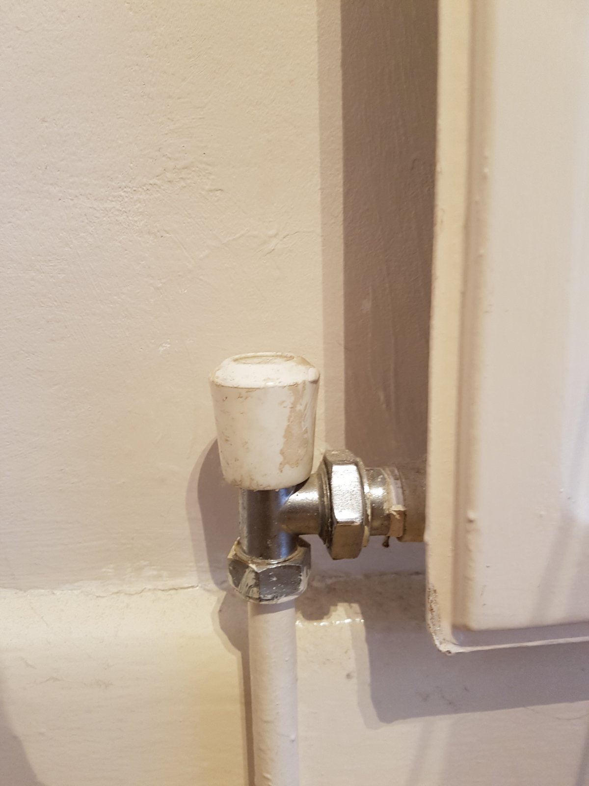

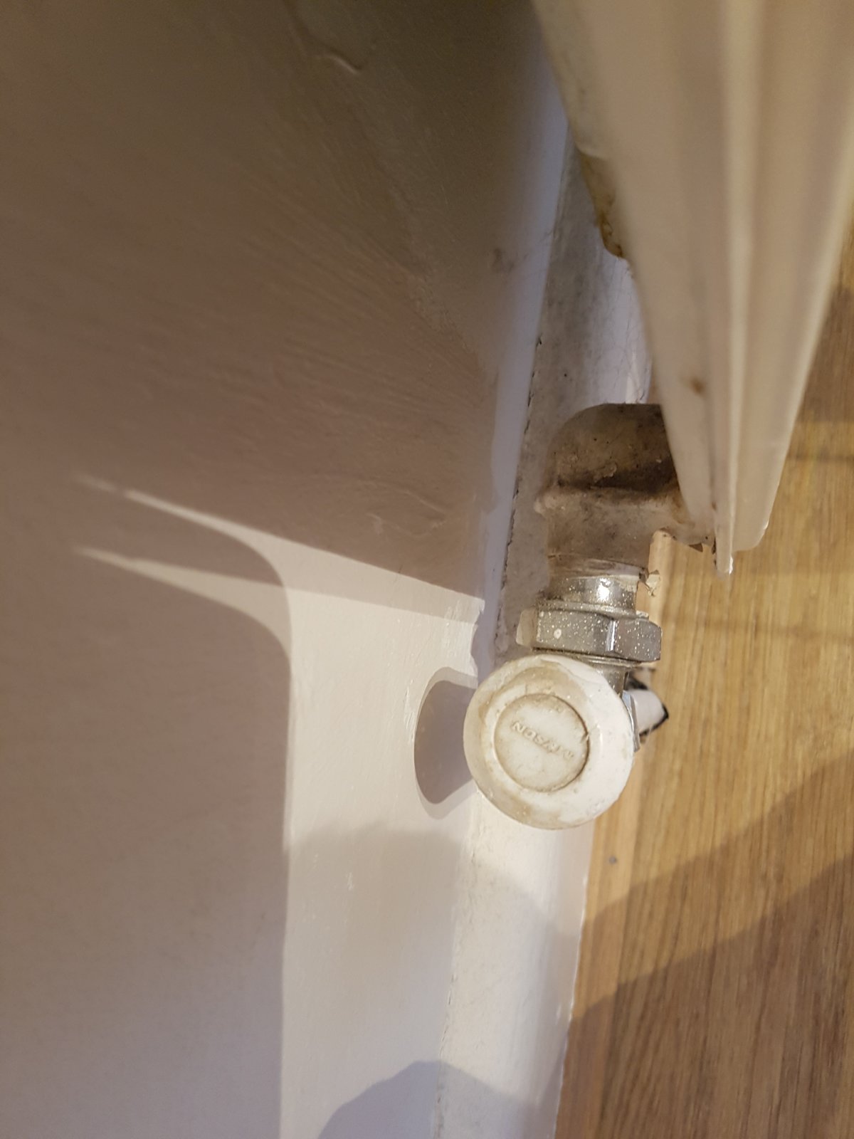

But now, having gone round all the valves on the other rads they really could all do with replacing. However, it seems the length of the new valves to the end of the threaded insert are now a bit longer than they used to be. Is seems to be about 52mm from the centre of the valve to where I think the thread would end in the radiator. Most of the TRVs I look at, Drayton TRV4, Honeywell VT200 seeem to be about 60mm now. The tail piece looks longer in pictures on new valves bu maybe misleading.
Are the inserts different now to what they used to be? Or can I leave the original in place so that the pipework doensn't need to be modified on every valve on every radiator? Otherwise it would be as well to bite the bullet and replace the rads as well if having to adapt all the pipework!
Photo included of rad with current valve. 20171013_102154.jpg 20171013_102146.jpg

Re: fitting TRVs and new locksheilds to the remaing old rads:
I think the issue is they use 1/2" to 3/4" tail insert in the rad. And the overall visible distance from centre of valve to end of thread of the tail I'm looking at could be up to 10mm too long each side of rad. More than pipework will likely move and if I bend the copper it will no longer be true for valve line up....
This must come up a bit?
Is there a different shorter rad tail I can use for fitting new TRV valves (rather than what is supplied) or can I cut the olive end of the tail by 10mm. Pictures of valves with tails on seem to indicate there maybe some scope to shorten slightly....
