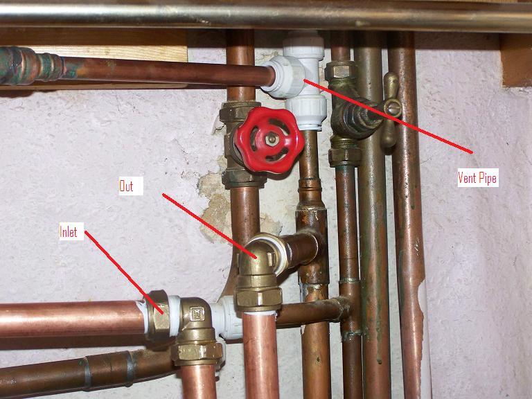

Also, don't make the mistake of just tee-ing the vent at the top of the flange into the hot water supply/vent pipe or you will also be into the vent causing a loop of water and your pump won't turn off :LOL:
This is one that was fitted by a friend - I changed the tee for a proper elbow and capped the pipe off below and it works fine now
The vent pipe labelled also went into the vent at the top of the tank causing that affect :LOL:
Hope that helps
