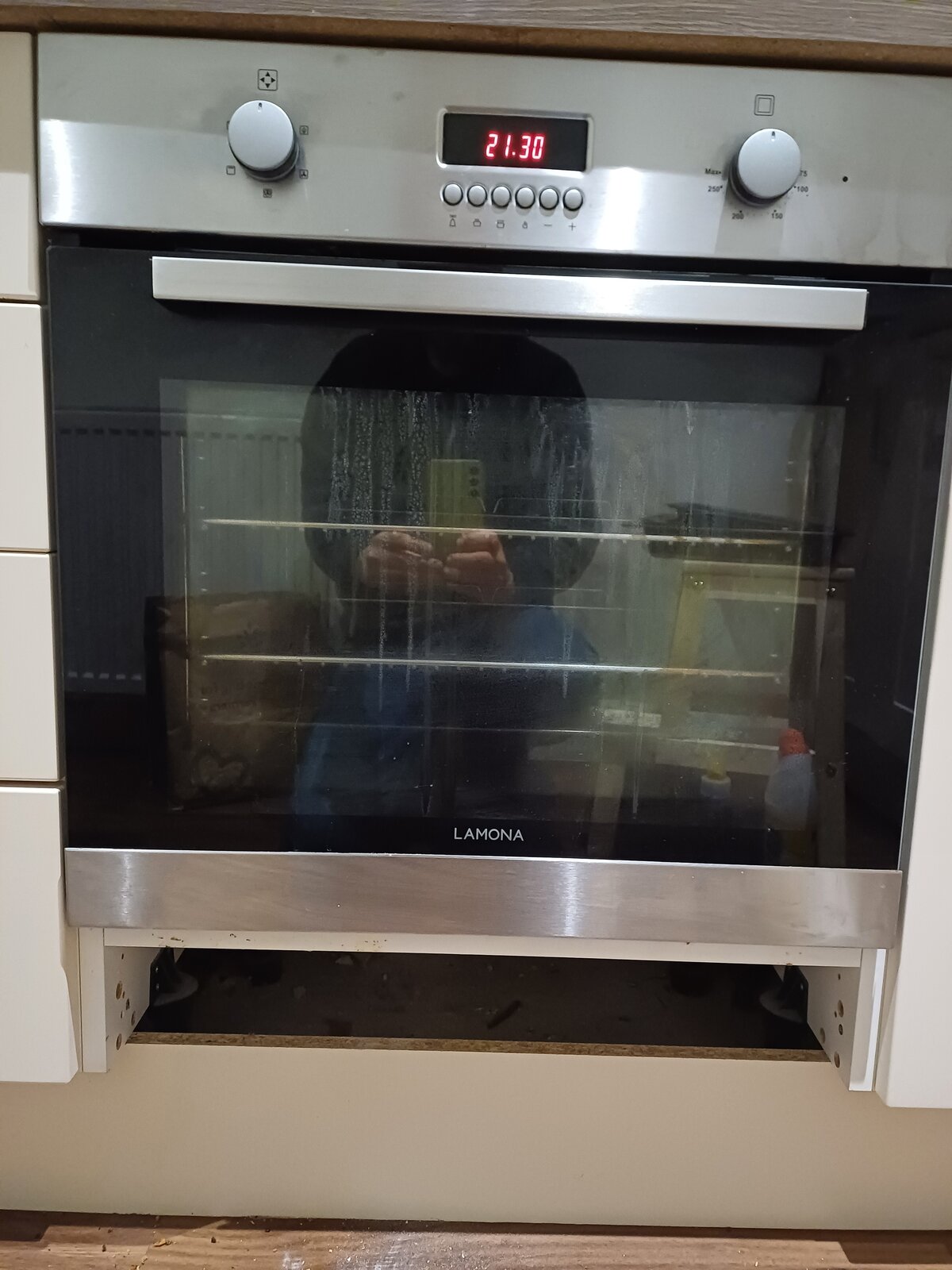

This Lamona oven has been fitted too far to one side and the drawers are catching on it. Should I be able to reposition it further to the right?
Open the door. You may find that there are only two screws that hold it to the carcass. Try to loosen them slightly and shunt it over.
I have fitted about 15 ovens over the years, and removed more so that I could redecorate. Every one of them was held in place by two screws.
Best of luck.
That did the trick. Not obvious from the photo but it's spot on now. Thanks very much for your help.
