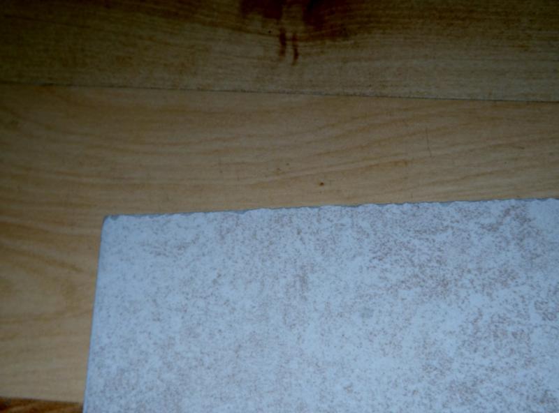

Hi,
I purchased an Erbauer ERB337TCB 750W Tile Saw 230V from Screwfix for £90 to tile my dining room. It seems to be a good bit of kit but it has chipped all the porcelain tiles I have tried to cut. The chips are small but still apparent - please see pic.
I have cut ceramic tiles before using much less impressive equipment and have not had a single chip.
I am feeding the tiles nice and slowly through the disc, the disc is brand new (came with the cutter and this is my first use) and I have plenty of water in the reservoir.
Any ideas?
Is this normal? Please see pics
My two cents would be:
Is the water definitely feeding through?
Its best to buy a top quality blade for porcelain - your price for machine and disc is probably indicating a cheap c/w disc.
Sometimes pieces might be seconds, especially stuff from the sheds.
