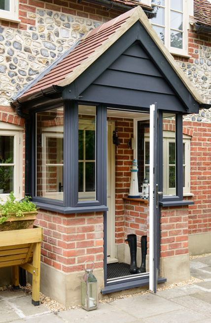

I'm building a little enclosed porch on the back door (I've attached an image of the sort of thing I'm thinking of). I've built up the dwarf wall and am now thinking of the best way to build the timber frame. I've looked at much grander porches and conservatories to see how they are constructed. I'm thinking of three options:
1) Build a frame out of (e.g. 70x70mm HW timber) and infill with bespoke fixed windows ordered from the internet.
2) Just fix together the HW windows ordered from the internet.
3) Incorporate a rebate into the frame itself to take the glass (I'm only looking at single glazing) and don't bother with the internet.
How do the porch and conservatory manufacturers do it? I can't find any designs or specifications for this sort of thing anywhere.
TIA!

Yes, make it out of standard windows, just allow for corner posts and a half post to the wall.
If you want to make yourself, make frames out of 70 x 45mm planed all round timber.
Machine groove into bottom of frame, inside for window board, outside for cill
Then screw together the frames - just butt jointed (top and bottom run through, jambs go in between)
Make as separate frames and use separate corner post and wall posts.
Cut suitable moulding and mitre around for the rebate
Buy some glazing bead and mitre around for the glass
