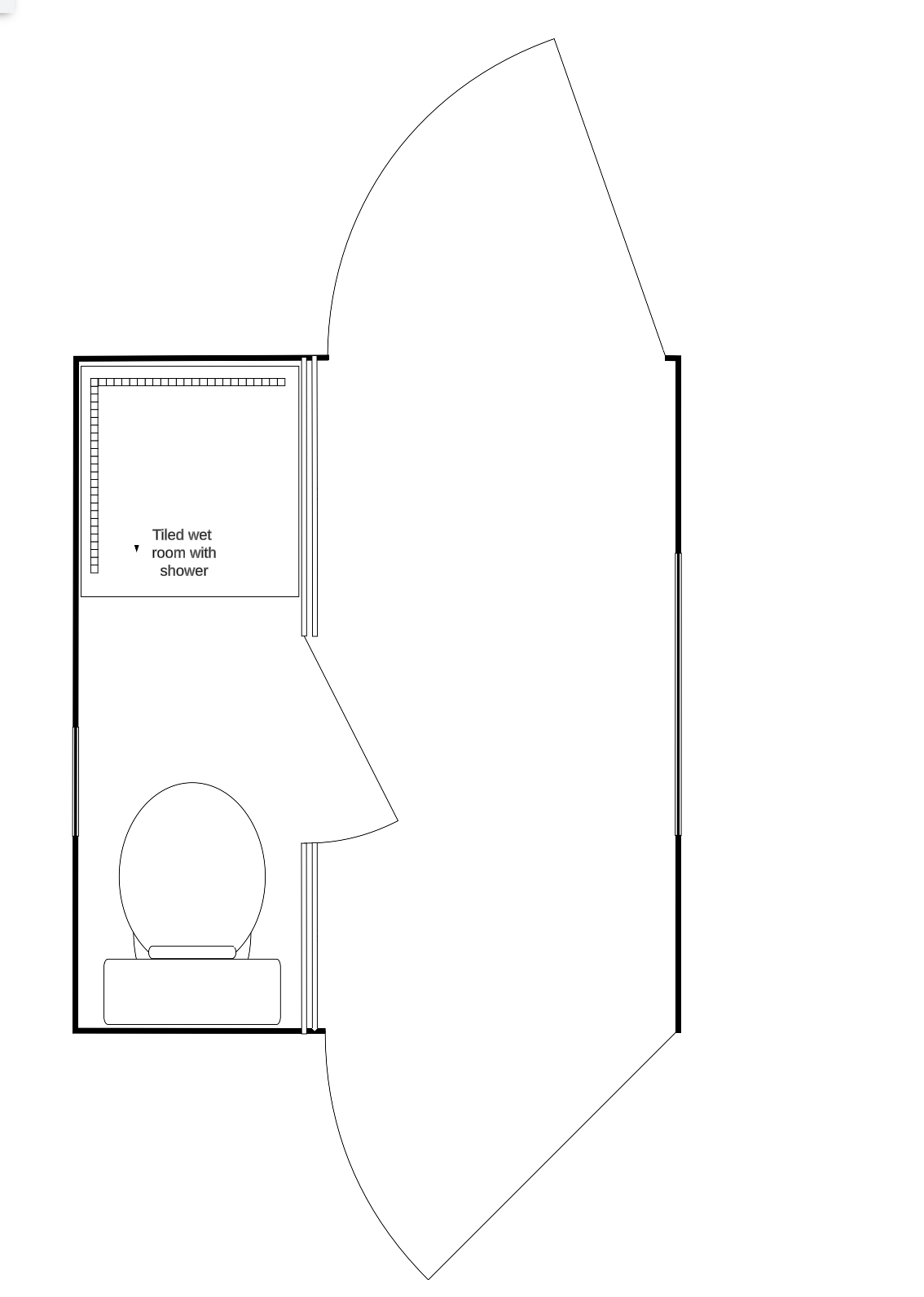

What I was planning to do is shows below. I just did it so it doesnt go by standards of a floor plan. Its using 174 cm (l) x 155 cm (w) inside area. so the 25cm cavity walls are in black while internal stud wall is in white double lines.
I know its going to be pretty tight - the only reason I am against the permissions is the time it takes (not the work or cost that goes into it). Due to personal reasons I need this built by early July. If I were to send a planning application I probably wont have an answer by then. I really could use the extra space - ideally I would apply for a 2.4m x 2.0m porch to get a toilet and shower in with some decent space to stand/put coat hooks/shoe rack in.

The cloakroom WC/shower will need a wash hand basin. The internal wall is suspiciously narrow. I don't think you will get a 250mm thick external wall to meet the insulation standards.
Also I think you might be mixing up Planning Permission and Building Regulations consent, Woody mentioned both but they are separate applications. You might get away without Planning but you will need Building Regulations although if done on a Building Notice Building Regs need not cause a delay.
A small porch may not be a contentious planning application. It might be worth considering building the larger porch without a planning application and submitting a retrospective application if you get caught or submitting an application for a larger porch and starting work before the decision is made. It's risky but if you really need it built by July these are options to consider rather than building a tiny porch that will feel cramped and useless.
thanks @wessex101 , I had considered toilet with basin on top of cistern. I didnt mention it up there. Anyhow, I have been deliberating over it and a friend also suggested the same as what you are saying.
The above would have been 1.42m (w) x 2.1 (l) porch. I am now going for a 2.4m (w) x 2.2m (l) porch. Going to start the work and put the application side by side with the hope that it is approved.
