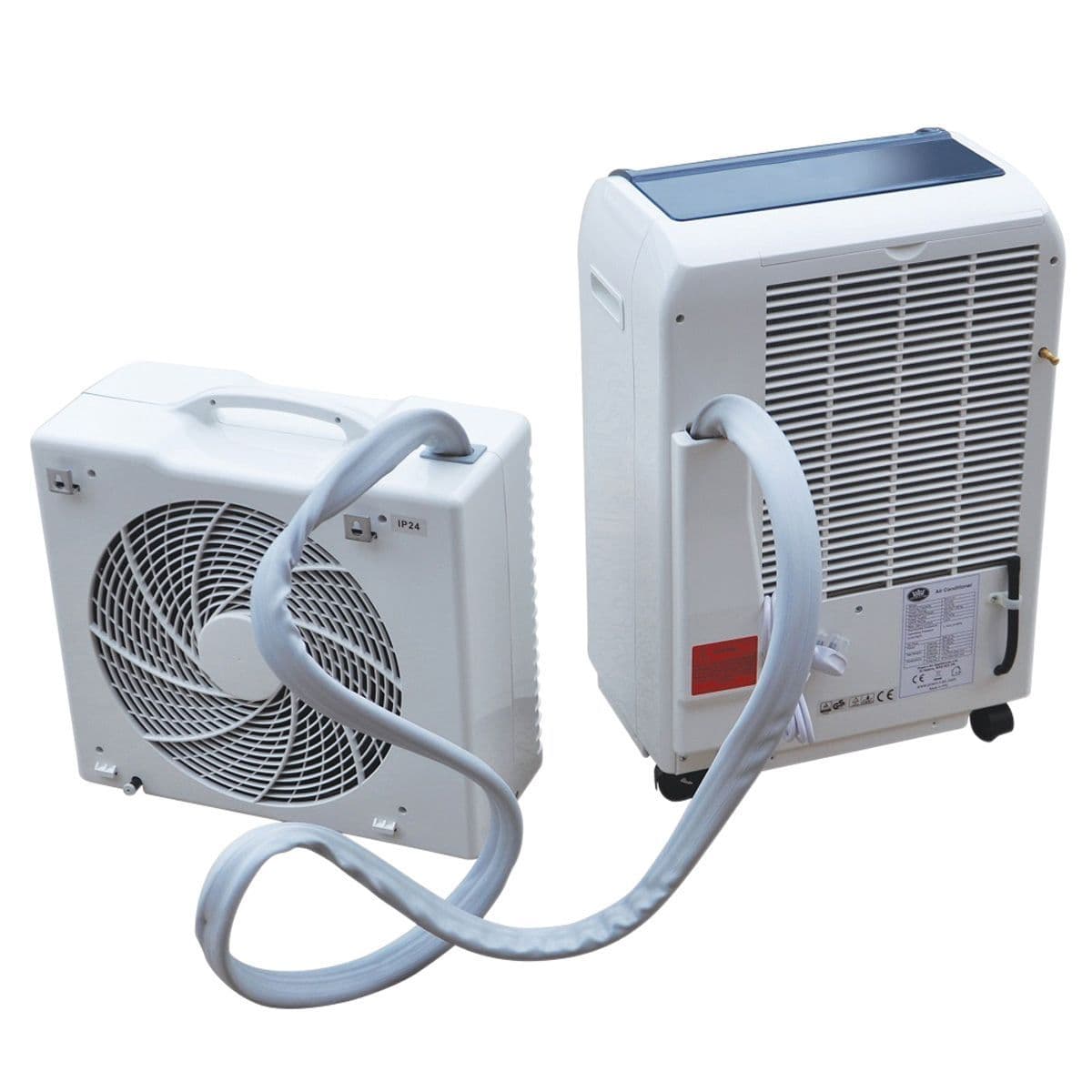

Hi, I have an eighteen year old Prem-i-air portable split air conditioner, as shown in the picture below. I bought it second hand about two years ago. I have fitted an Easy Start to it, because I am running my house on solar power, and without the Easy Start, the air conditioner would often cause my inverters to turn off, because the compressor takes too much current on start up.
The air conditioner has been working fine for the past few days, but I noticed today that the air coming out of it wasn't very cold. When I first bought it, the air coming out was 0C, literally freezing, but now it's about 20C. The indoor unit still produces the usual amount of condensate (water) which I empty every evening via the little hose on the back (bottom right of the photo), and the outdoor unit still produces the usual amount of condensate. The umbilical cord sheath has split at the bottom where it enters the large unit, and the thick metal sheathed pipe is visible, and is very hot to touch, which I presume must mean the compressor is working. I can also feel the heat from this pipe within the sheath where it enters the outside unit - very hot.
Is it possible that the unit is only giving out 20C air because it's already cooled the room down to the temperature I selected? (I had selected 18C on the front, but my (not very good) thermometer says the air coming out is 20C, and it certainly isn't 0C, I can immediately feel the difference!)
As the unit is 18 years old, I'm thinking about buying a new one - they are £1,250. I can get a wall mounted air conditioner supplied and fitted for around £1,200 from a few people on Ebay, should I go for that instead? Is my unit repairable? I understand that air conditioning installers charge a fortune for what is a fairly simply job, so I don't expect I will find anybody to repair it for under £300.
I took the indoor unit apart today, and felt the two copper pipes that go into the unit from the umbilical, one was very hot, and the other was cold and had condensation forming on it after running the air conditioner for about two or three minutes. So I presume there must be coolant in the system - but maybe not enough to make the air conditioner work properly?
I've just about given up any hope for it now, I think I'll get a wall mounted unit installed, it will take up zero floor space, and I think if I spend any money trying to fix the existing unit, it will probably throwing good money after bad, as it can't have many more years life left in it, even if I got it fixed.
