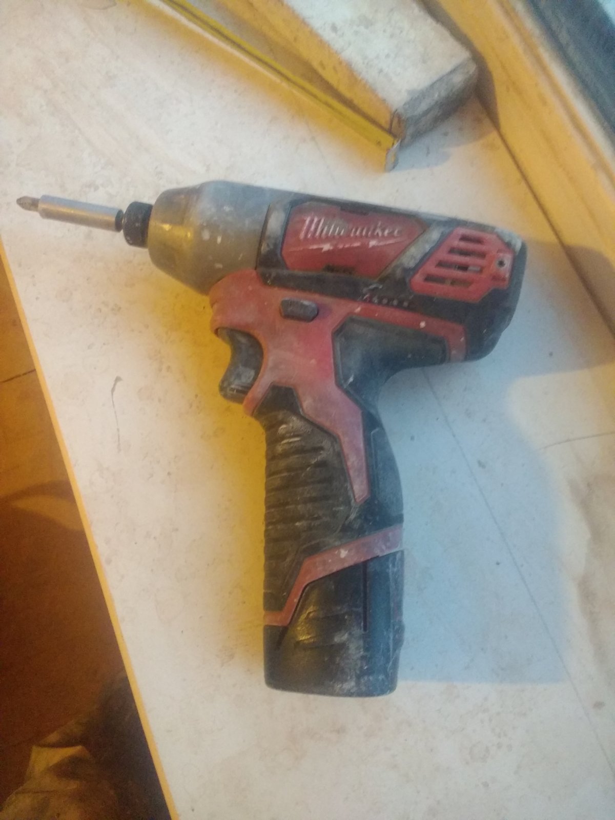

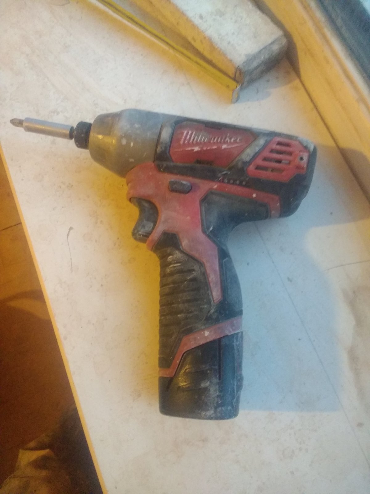

Get an impact driver for Christmas. I've recently got one of these:
Looks like a toy but bangs in 6" woodscrews for fun.
Ideal job for an impact driver.
In the meantime, rub a bit of soap on the threads of the screws before you put them in
